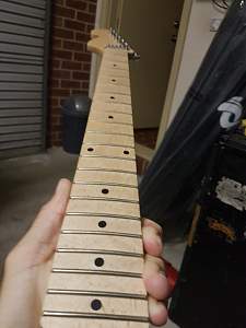

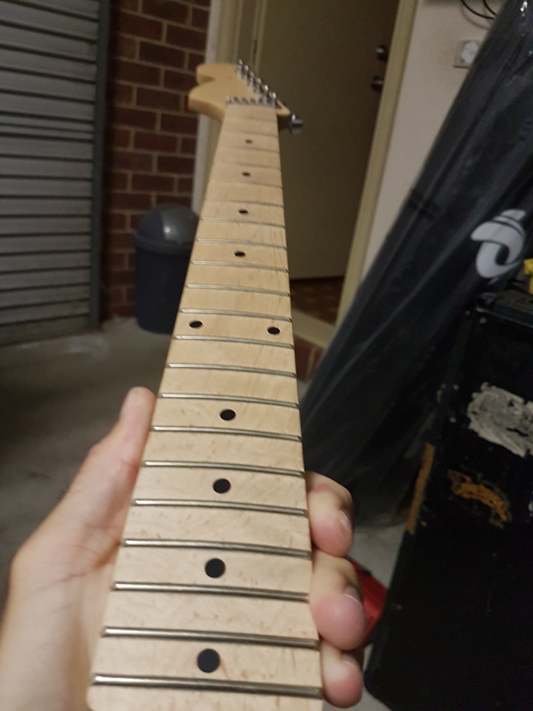

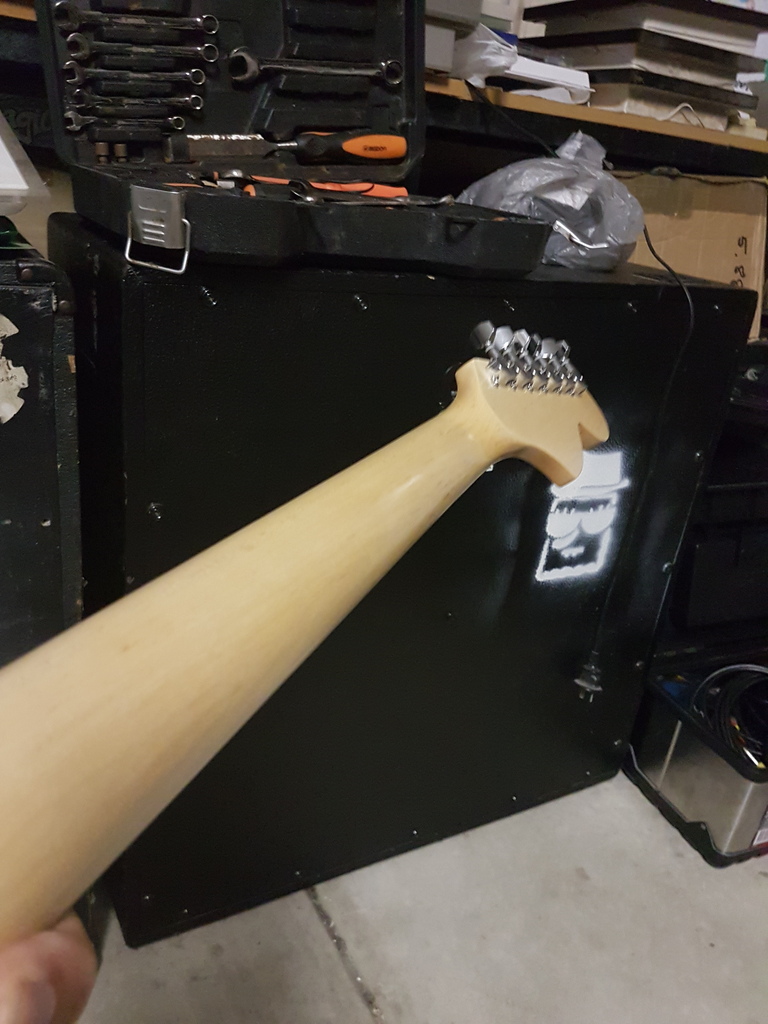

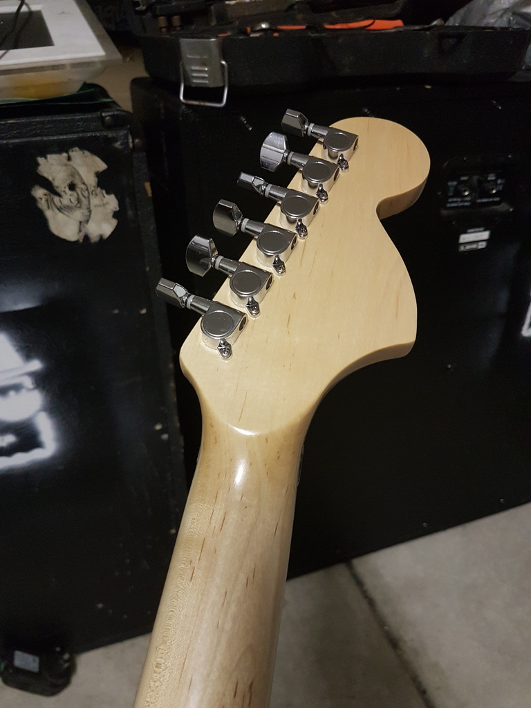

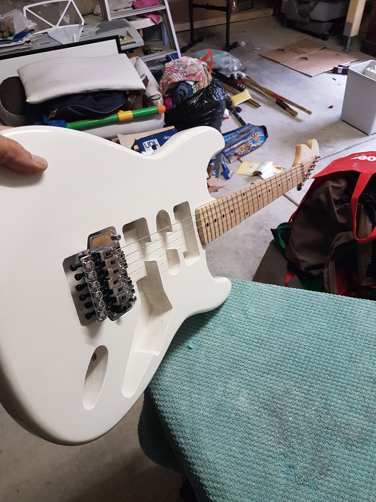

    Just a quick update on my build here is the finished neck which I'm pretty happy with for a first timer.

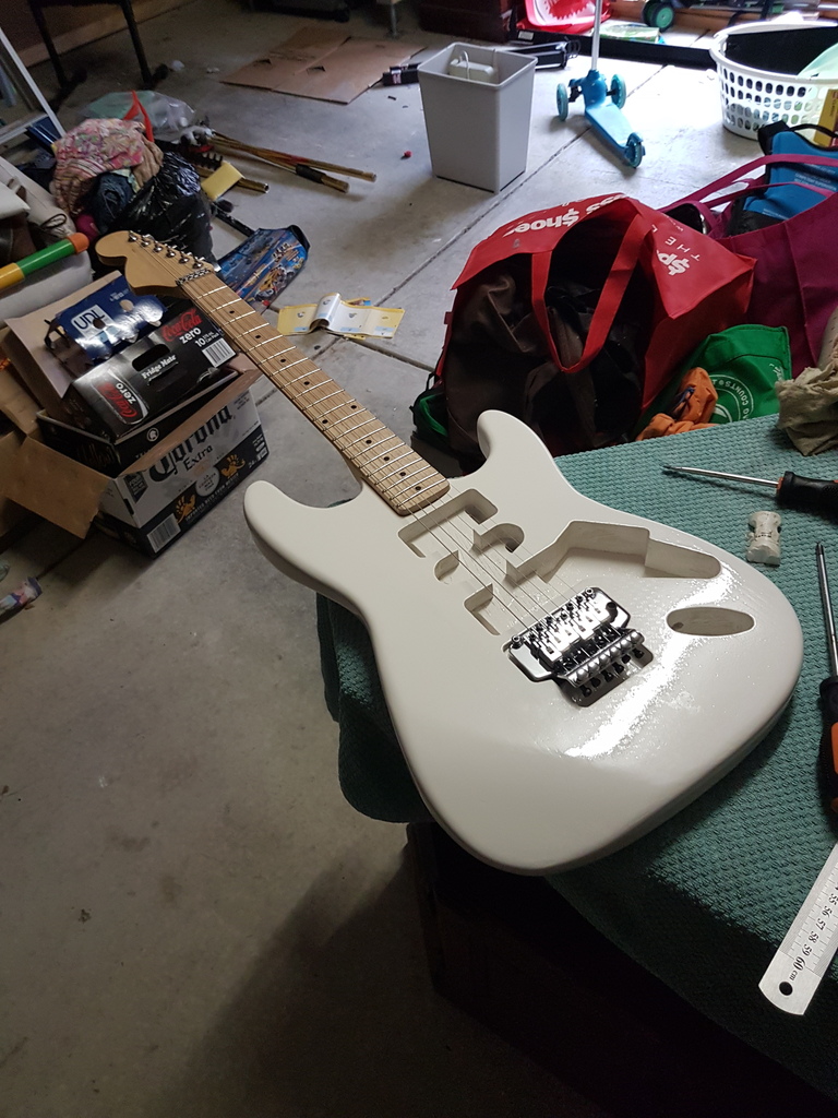

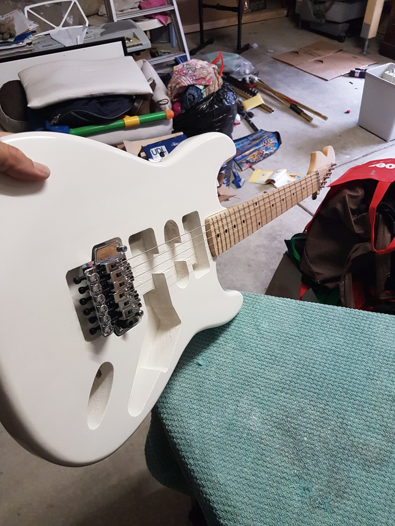

    And i couldnt resist a quick build to see how she played.
    Looking good and a reverse headstock love it!
    Sent from Android Nougat
    5,666
    Mmmm, that's puuurty! Nice and clean, what scratch plate are you running with?
    FrankenLab
    May 2016
    Geelong, VIC
    17
    Scratch plate is white as are all pickups and knobs. The paint looks white in the photos but it's actually gloss antique white which I think looks great with the stark white electrics. Neck has been tru oiled with dingo wax on the fret board.
