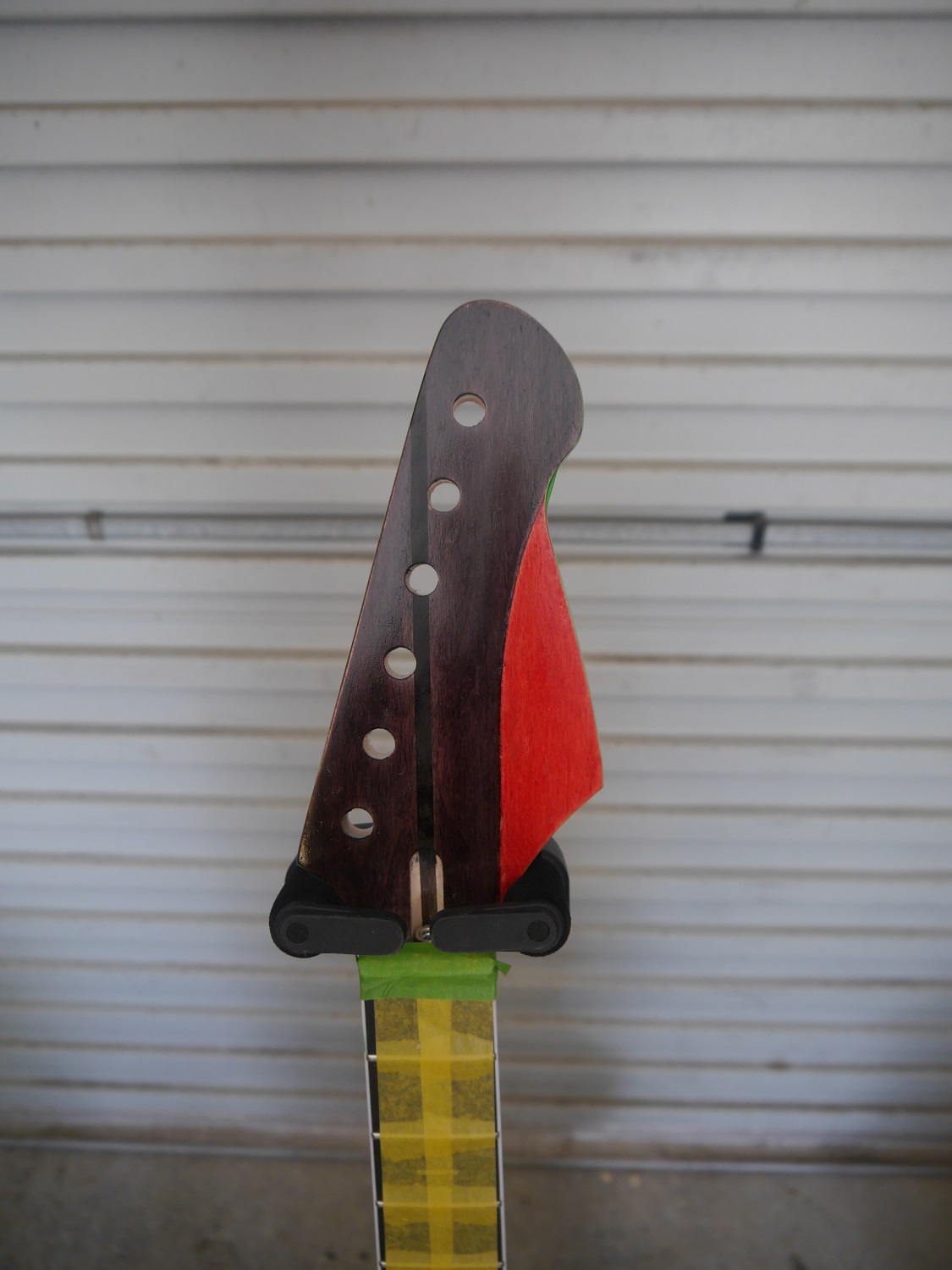

    Moved on to the headstock next and was looking to possible routed indent part similar to the edge on a Starcaster headstock but taking up a larger portion. I did some testing on scrap wood but couldn't get the finish clean enough for my liking so decided to use two different stains.
    I also had a friend cut some vinyl lettering for my logo.
ID:	13859   Click image for larger version.
ID:	13860   Click image for larger version.

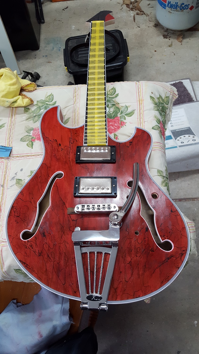

    We are getting closer to the finish now so I started on the electronics and did another almost finished mockup.
    Bring on the clear coats!
    Incidently, the cost is a little higher than the current PBG offerings (I paid $358 delivered for body and neck only). I have spoken to Adam about it and he thinks he can get it somewhat cheaper if there's enough interest from the forumites.
ID:	13864   Click image for larger version.
  6. #16
    some nice progress, love your headstock idea, well done
    hell yes to this kit, but
    I'd need a lefty...
  7. #17
    Its a niiiiiiice!
    That Karajini red has come up beautifully, VERY interested if PBG do a similar option (Price Dependent) (Also Spousal Tolerance Dependent).
  8. #18
    very nice Pedro, I have done karijini red over spalted maple and it looks great.
    Cool looking headstock logo and the mock build looks damn cool !
  9. #19
    Hey pedro,
    You got a great colour out of that Karajini Red. I'm assuming that you have put down the intensifiers?
    I can see a bit of lumpiness which i would recommend gently sanding down a bit with 1500 (or 2000) grit wet once it cured but before you lay down the clear coats.
    Are you using DT finish coats or a different finish?
  10. #20
    South East Melbourne
    50
    Cool Andy, thanks for the advice. I'll definitely do that.
    I did about 3 coats of intensifier to get the colour I liked. I will be using the DT final coat to finish.
