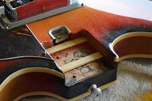

    Hey fellas, thanks for all the tips and comments, much appreciated. Apologies for not acknowledging them or replying sooner, been a busy few weeks with work and only today got some spare time to work on my guitars.
    So, referring to the photos below, today I pulled the neck off. Surprise surprise, someone had a similar idea, as the two paddlepop sticks will attest. Even though it's been 25 years, pretty sure I've never had the neck off. So someone was not happy with the action at some point in time.

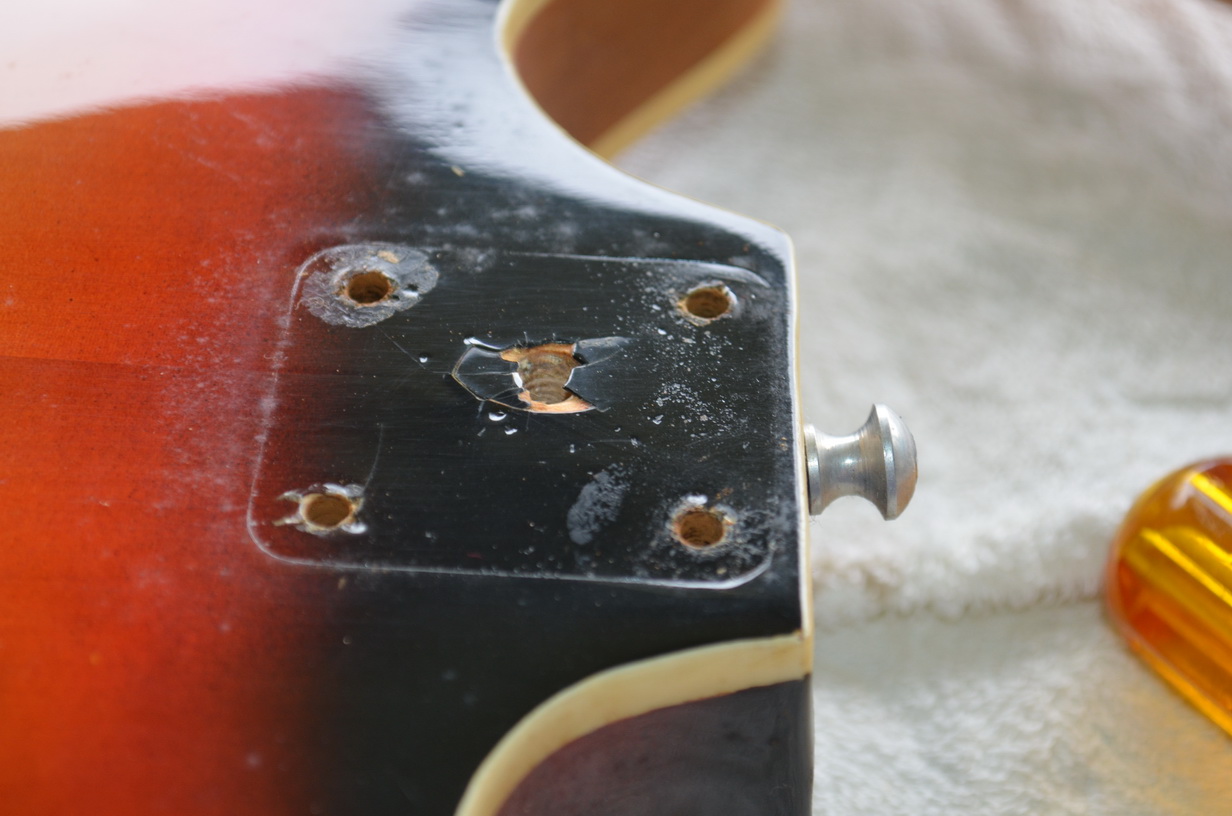

    Also, that big hole in the middle of the neck mount screws, dunno WTF that is for. Can't even think why it would be there, obviously not original with the way the paint is chipped around it, and not centred.

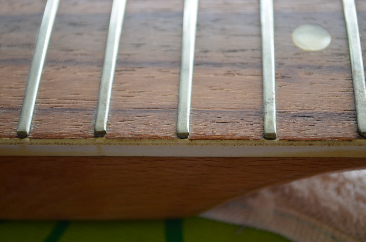

    BUT, and a big but, as you can see from the third photo, the frets are horribly finished - running your hand up and down the neck is not a very nice experience. They have jagged edges and varying lengths. All in all not a very nice neck.

    As for the bridge, yes it would be better if it was lower. I pulled the two adjusters off and it sits about 1mm lower, so combined with a wedge in the heel socket the action might come down a bit. Will be a lot of frigging around I should think. I googled for floating bass bridges, the only one I could find was a Hohner style, which looks to be taller than the original piece, and the saddles aren't adjustable. No measurements on the string width either. The original part's centre-to-centre of each saddle is 17mm, give or take 0.1mm or so. I guess I can always sand a bit off the bottom too.
    So, now need to make a decision as to whether it's worth spending the money on. I will try make a wedge for it and see if I can get the action down.... if I can get it to a reasonable height it might then be worth buying the neck.

    The hole would have been where it was hung for painting at a guess.
    Personally, I would just clean up the fret ends. It is normal for them to stick out a bit on an old beast like this as the timber would have shrunk a bit.

    With the paddle pop sticks, I would ditch them and make a proper wedge shim to get a better break angle on the neck.
    That will sort out the action height dramas
  10. #20
    Plywood body and maybe a bit of thin plywood cut to the size of the neck pocket as a shim would be the first thing to do and then drop the neck in over the top and re-check action height to see where things are at and which end needs how much sanded off to bring it somewhere near a decent level/angle to play.
