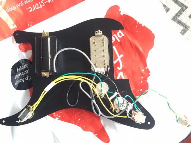

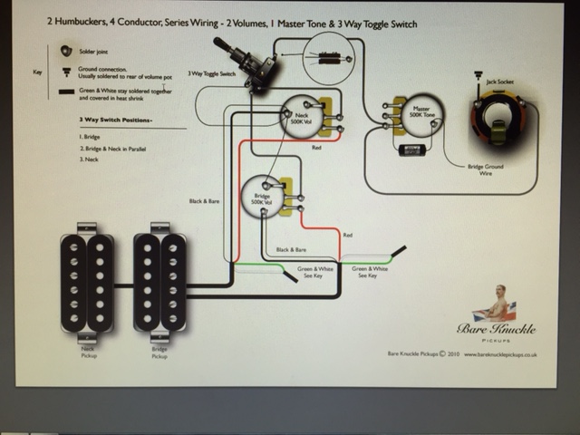

    here is a look at the scratch plate I wired it up last night , took 4 goes at 4 different schematics for me to get it right , I've attached the one that actually worked for me, the 3-Way toggle in this one matches the one I have installed, and once I realized that, I looked back at the other ones and realized were actually right, just the design of the actual 3-Way was different and my male eye for detail missed that thus I had the earth and signal from the tone pots the wrong way around, also one of the schematics I had been looking at had the signal lead and the capacitor on the tone pot swapped so it was working backwards but once I followed this schematic everything worked as I had hoped it would

    nice job of the wiring Damo. You won't get the output jack through to the jack cavity
    what do ya mean ? nah yeah just used it for testing
    Hey Damo, meaning you will have to unsolder the jack tips to fit the wires through to the jack cavity and re-solder them to the jack.
    I was just being silly with that confused comment I just wired it up to test it out, I held the pickguard over one of my other guitars and strummed its strings to ensure all the components were working as they should
