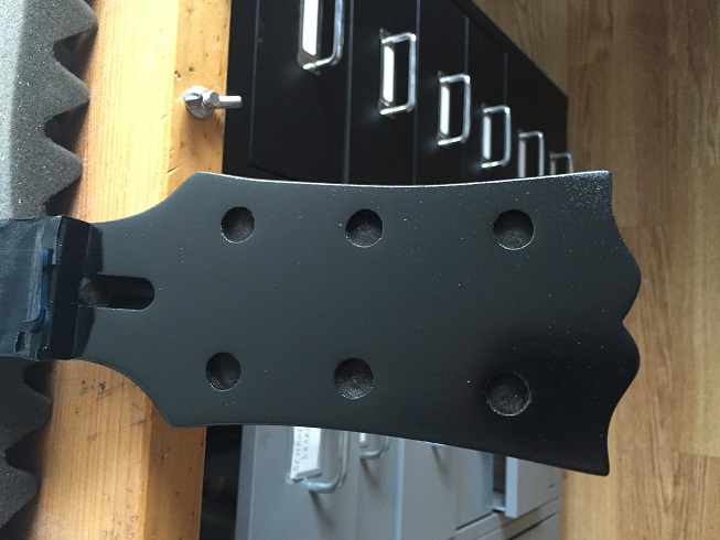

    Also spray painted the front of the headstock black.
    But when opening the door of the shed a gust of wind threw up a lot of dust.
    I will give it some light sanding to see how it turns out.

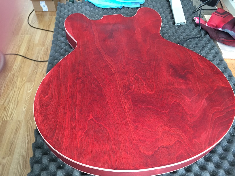

    And stained the back
    This is going to be a really good looking unit with some gloss on Eric, nice job.

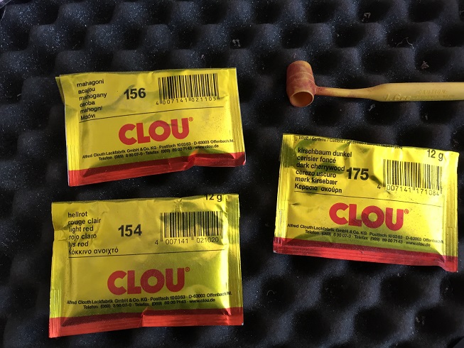

    When I saw this guitar I wanted to try and make the same colour.
    http://www.buildyourownguitar.com.au...ead.php?t=2346
    But after mixing and testing on a piece of scrap wood I decided to go a little darker.
    I did use Clou water-soluble stain.
    I had a 1.6 cc powder measure so used that to measure out the stain.
    Took 100 ml water and 3 parts red.
    Then 1 part mahogany and 1 dark cherry.

    Eric I missed your photos posted. Colour looks very nice, well done. Don't stress about some dust on the headstock, a light wet sand and another coat of black will sort that out. Worth cleaning up as much dust from your shed as you can so it doesn't happen again !

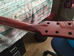

  10. #20
    This is so much better, almost unbelievable.
    No drops,but a nice even spray.
    Very easy to get a good even coat on it.
    Done the neck with 2 coats, there is a very light orange peel, but that will be polished out.
    Its already very shiny.
