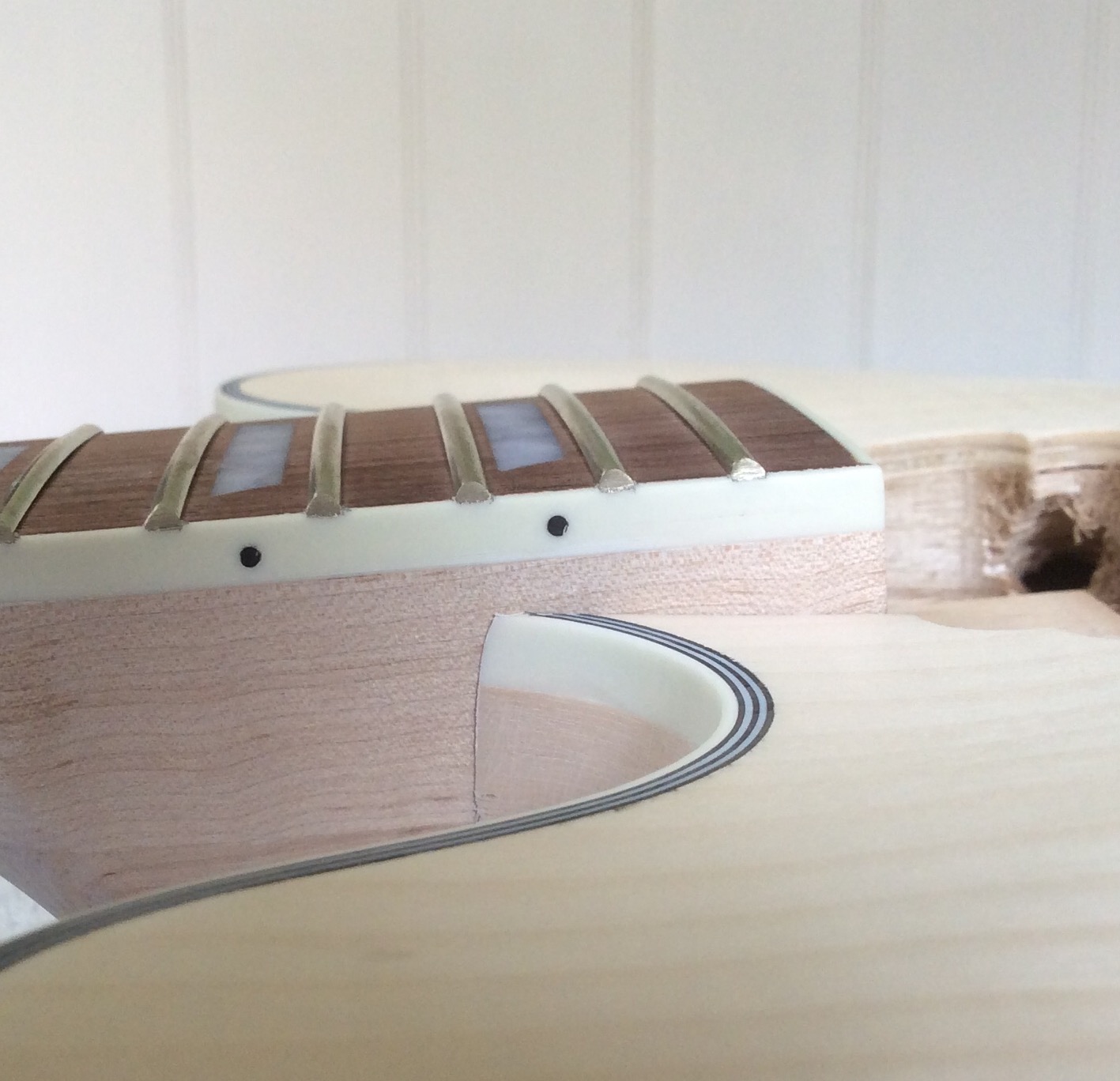

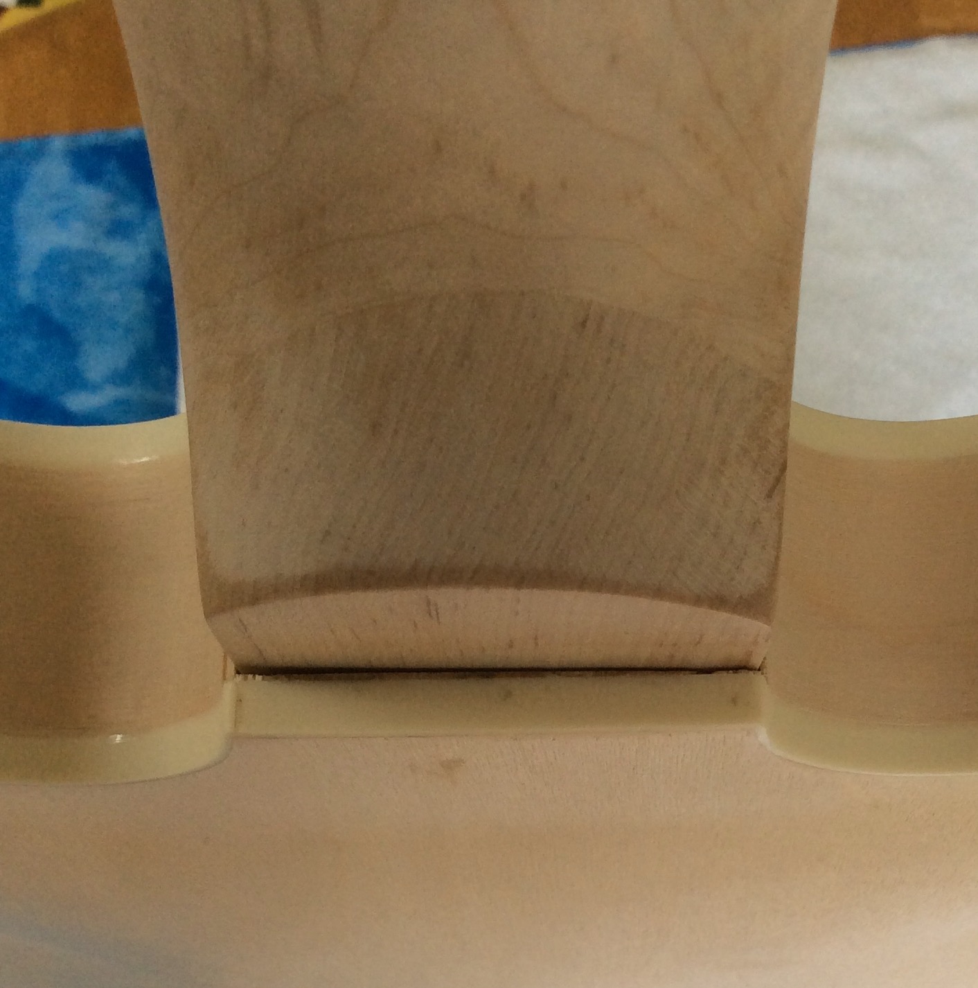

    Okay so back to the neck... With a bit of careful sanding we're in better shape with a snug fit. See photos.
    One thing I did want to check was the extent to which I need to monitor, measure or worry about the angle of the neck as it sits in the neck pocket once flush with the bottom of the pocket.
    When I first got the neck to slot in it appeared the angle looked too much. But then I placed the pickups in their slots and it actually doesn't look bad. I don't think I want to get into indepth messing with the neck pocket as I doubt it'll really go well...

    The neck angle looks fine Sports. As long as the bottom of the heel is flush. I'd start sanding the body and get some stain on!

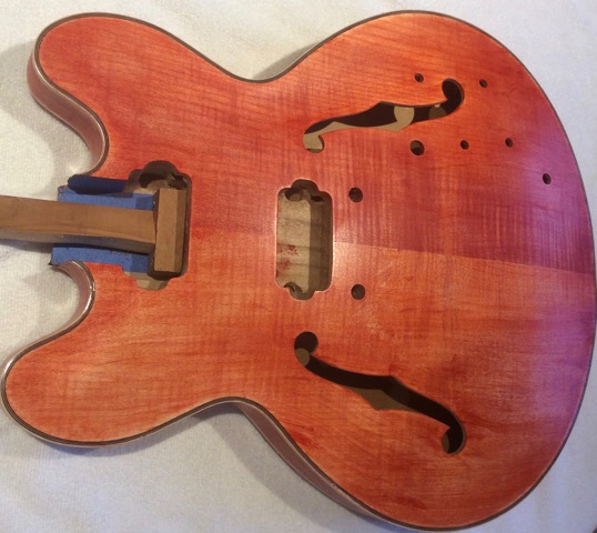

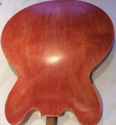

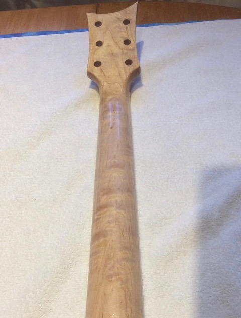

    Hi guys, quick update as I've been busy ordering some stuff and getting on with neck & body finishes...
    Neck: see the photo below. I've been applying TruOil, up to about 5 coats now which I think will do. It's come up a treat and really shows up the wood. Happy with it. You'll also notice a bit of a PRS'eque headstock going on... All good.
    Body: per photos you're looking at Wudtone Carmine Gypsy. One round of deep colour coat and one round of base Coat. Leaving to dry this week then will do another Base coat perhaps Thursday or Friday. I'm thinking 4-5 rounds of Base coat will do the trick but will see how it looks. No rush...
    Also the advice on the latex masking fluid was spot on so thanks for that. I've coated the bindings before painting/staining and it comes off with a bit of elbow grease with a pencil eraser/ cloth. Will give the binding all a proper clean up once all the rounds of colour are done. But a top tip. Thanks...

    I really like that colour. I wish i had the patience to order some Wudtone products and wait for them and get them through customs....
    are you indenting to sand/scrape the binding back in the F holes? It looks like they're stained.
