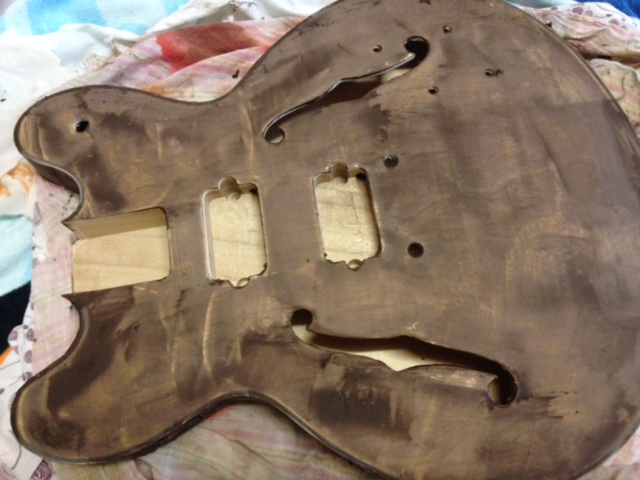

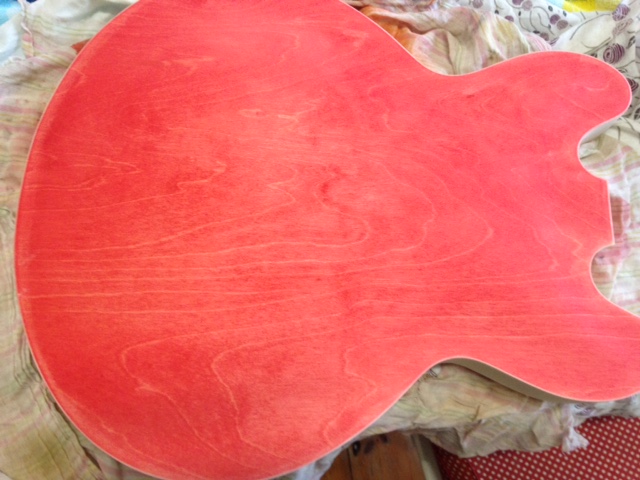

    Thanks guys for your encouragement, hope it looks as good as the after photos when its all done.
    Today did lots of work on the neck pocket and heal, the routing in the pocket was pretty rough with lots of tearout and the neck sat in the pocket on an angle (sideways). After lots of filing and sanding on both all looks good. Checked the break angle and thats fine too.
    After sanding to 400 I decided to whack some stain on the back to check the colour and what the grain was going to do. Turned out too pinkish for what I wanted so have now grainfilled and then will sand back and I may add a little red mahogany to the cherry red to get the depth of colour that Im after.

    I added some fountain pen ink to colourtone cherry red to get the darker colour on my J Bass as also found the cherry on it's own was too pale and washed out looking.
    Thanks waz, I just read your post about the ink, I used colourtone cherry red on this and it was way too pale. I bought the cherry for a custom job I did and mixed it with mahogany came out looking like redgum which is what he wanted, but I might have to try the fountain ink!
