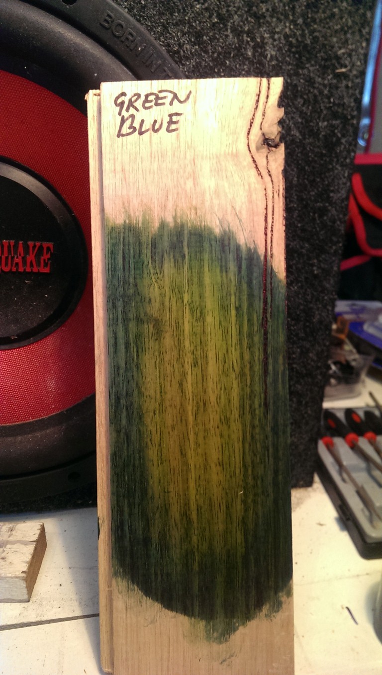

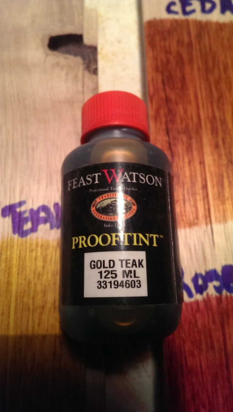

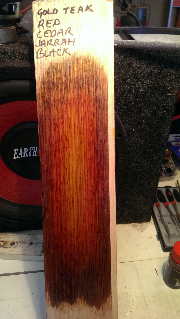

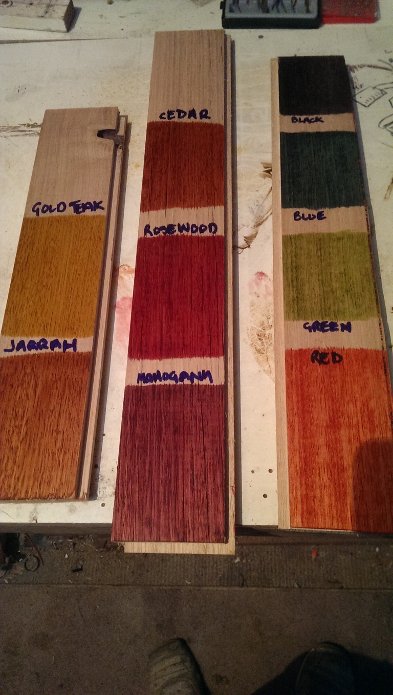

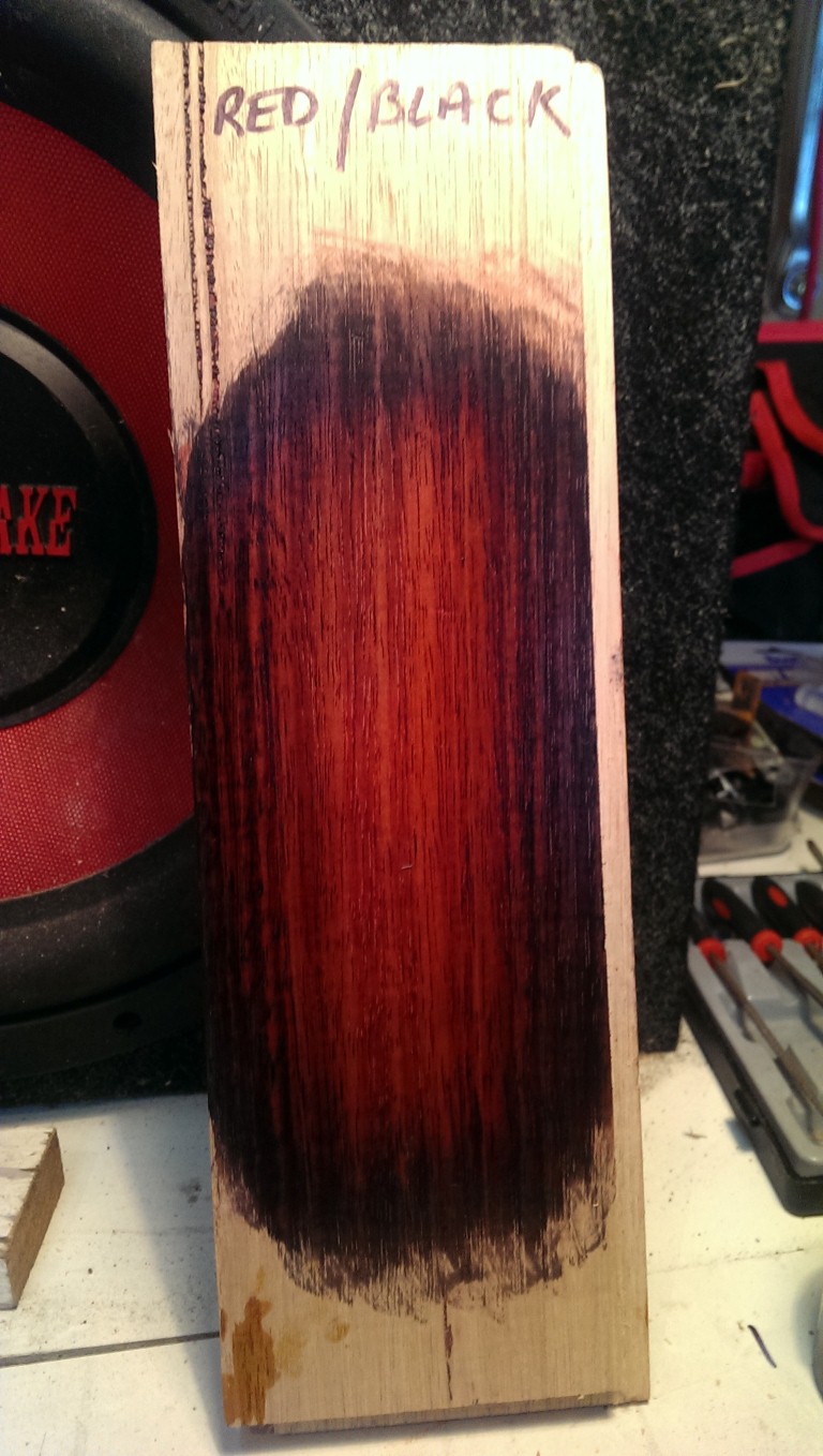

    Stains for 2nd guitar when im finished
    Been messing around with some stain colour combos for when i buy my second guitar. Thought some of you might like to see some colour variations.
    Im using feast watson universal 'proof tint", it can be thinned with water or turps. These are stains you can cheaply buy at any Aussie paint Place.
Name:	IMAG2476 (Medium).jpg
    these were applied in multiple applications without waiting for it to dry between coats. Allow at least overnight to dry before using a sealer or clear.
    Colours are written beside the sample.

    nice sample stain tests Nitro, I never knew FW proof tint came in blue, green and rosewood ? I've used all the other colours you have used.
