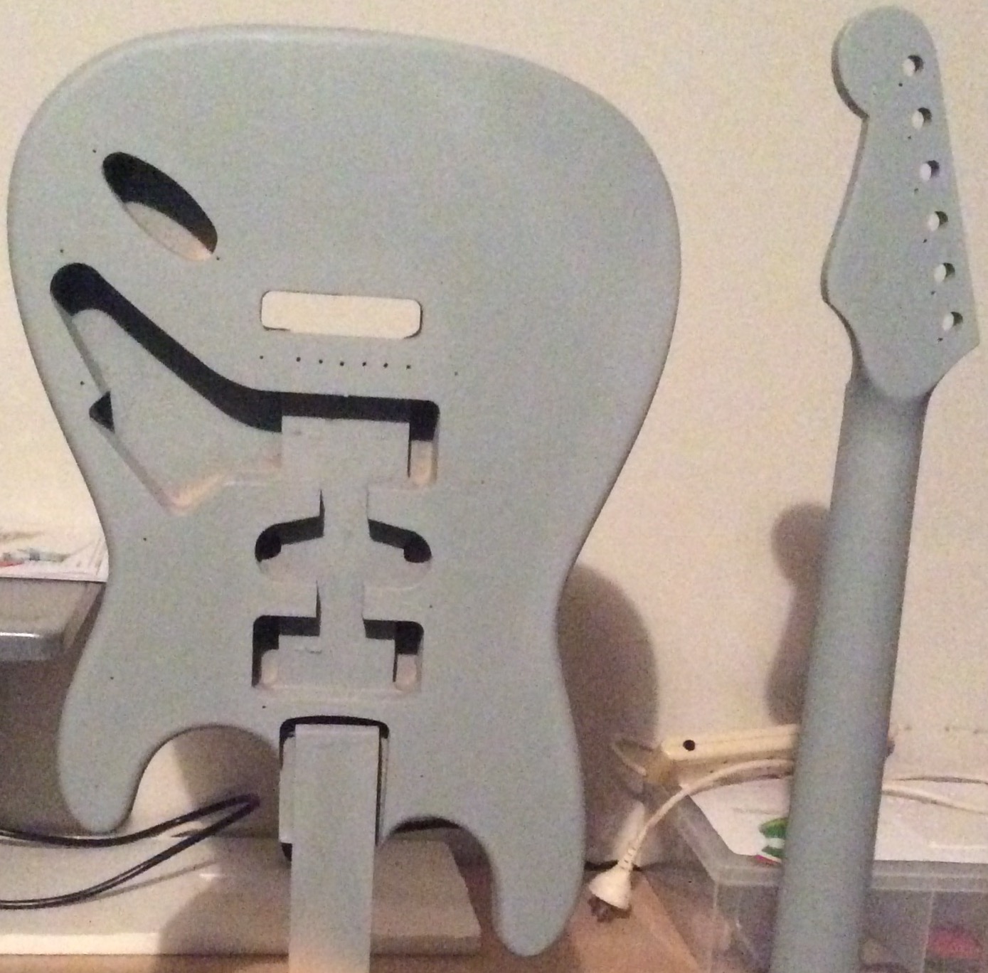

    First coat of acrylic primer on over the Timbermate and all looks good.
    Thanks for the tip Kimball
  5. #14
    Primer coat looks good Marelton. What is the final colour you got planned?
