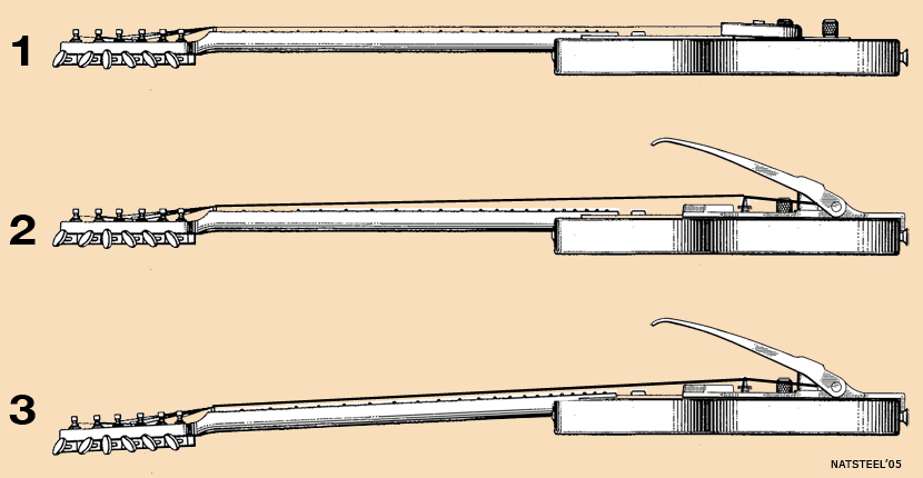

    I found this nice little graphic which for future builders if they look at this thread which would be a good visual explanation of whats going on here

    Your Build is Looking great! Yeah, I didnt know that the bridge should sit so relatively high with a tune o matic. I think 2mm sounds like a good goal to aim for initially then I can adjust the saddle from there!
    great diagram Storm, you can see in figure 2 what the string action would be like with no neck break angle !
    Yeah Diagram 2 would be awful / Unplayable. Initially I thought that all guitars are like is displayed in diagram 1, so I've already learnt something new!.

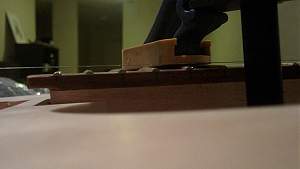

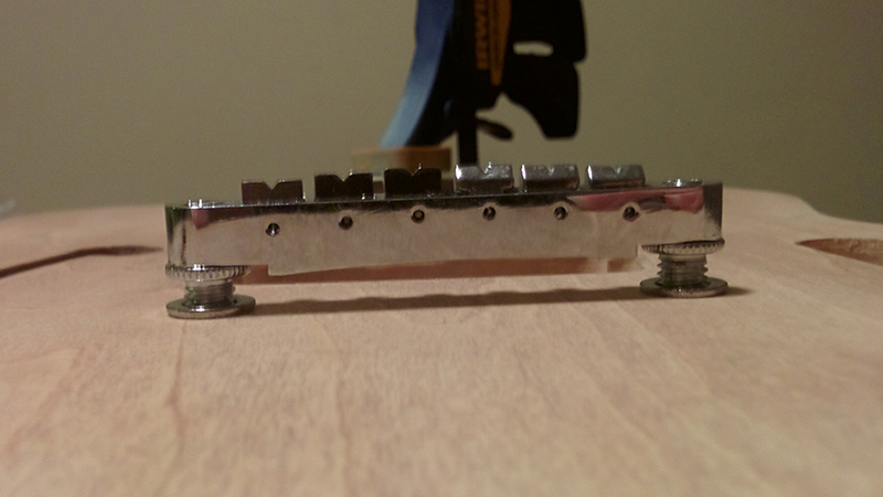

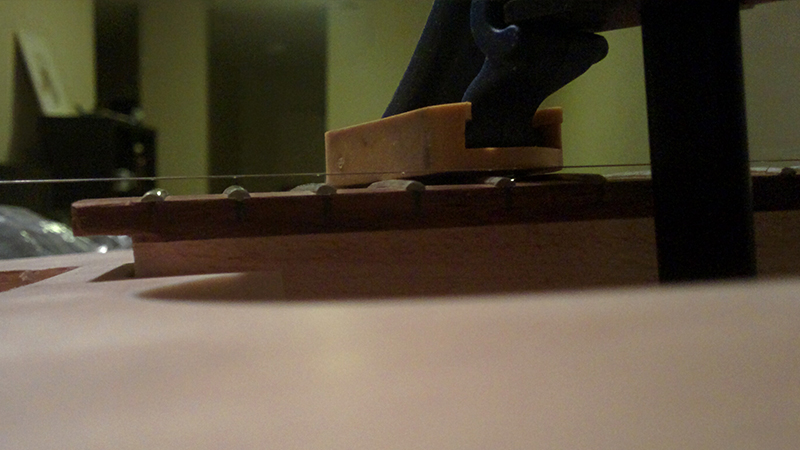

    So I got home and started checking out the relation of the neck angle to bridge. At the same time I also realised I should inspect the neck and I adjusted the truss rod in the end noticing that the neck was bowing slightly in the centre.
    I put the bridge up way higher than earlier and with a bit of eyeballing everything is actually OK!. :

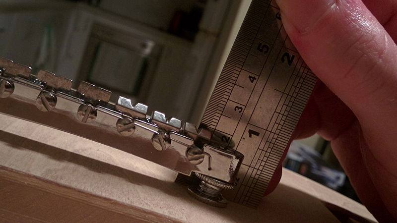

    So for a 2mm play height I've ended up with the low E string sitting in the saddle at around 19mm ish.

    The bridge wobbles in place currently, mostly from the threads on the posts. I think later on adding a little plumbers tape will help keep this from twisting around when playing.

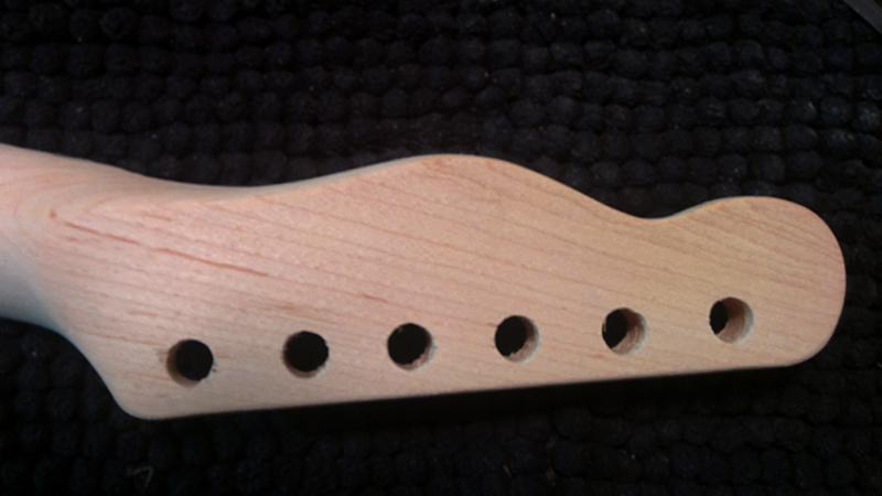

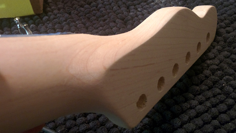

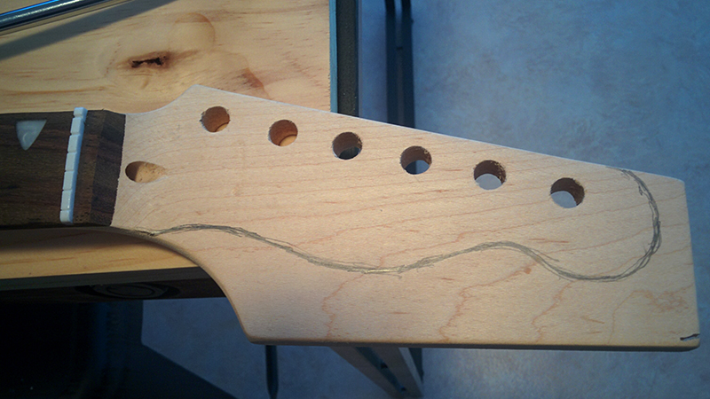

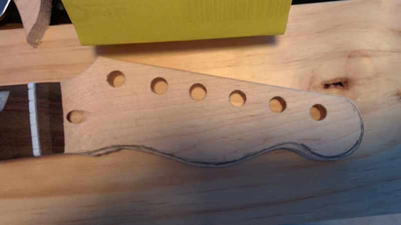

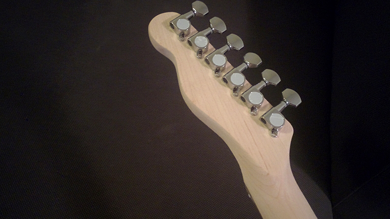

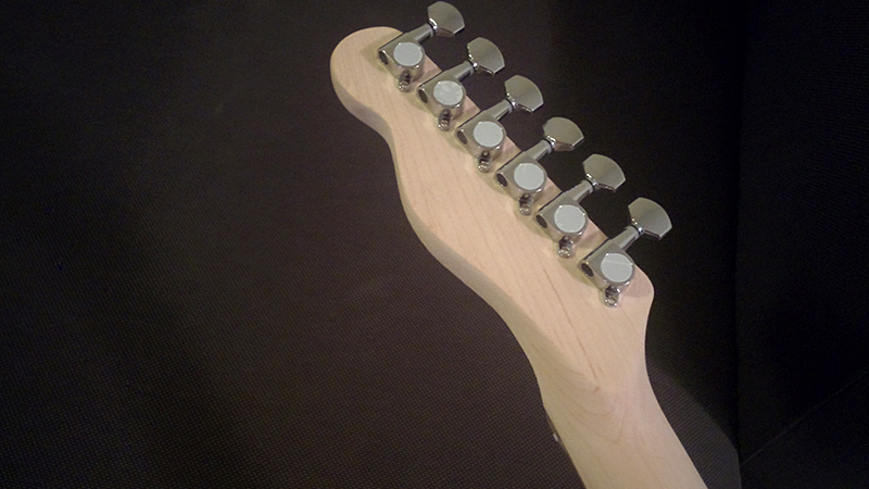

    Made some progress this week!
    Cut the headstock shape out with a coping saw, and spent a few hours shaping it and cleaning it with a file and sandpaper. Pretty stoked with how its turned out!

  7. #17
    Tidy work, Storm.
  8. #18
    headstock shape looks spot on Storm, well done, keen to see what stain colours you will be using ?
  9. #19
    Thanks Pablo and Wokka!
    I've got Minwax Sedona Red for the body. Will be keeping the neck natural so ill just be coating it with Minwax wipe on poly.
