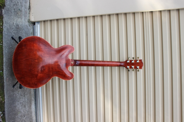

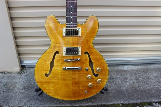

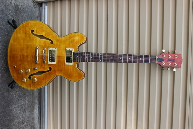

    Finished first build
    Pictures of the completed unit

    Nailed it! That looks great Doug! How does she sound?
    Wonderful work Doug, great stuff with the two colour finish.
    nice build Doug, assume its a ES-1G kit ? nice choice of colours, what's your next build ?

    Thanks for the positive comments guys. I couldn't figure out how to use this forum correctly & just stumbled upon all these nice comments. Firstly the guitar sounds great, mellow sort of tone to it, great for bar chords. It took me a while to set it up how I want & is a real bitch to keep in tune,(Grover locking machine heads for my next build which is an ES 5V waiting in the cave for me as I type this!) I am planning a sunburst finish on the new one so if you are interested I have just started a my build diary on the new one. The finish on the ES1G is Feast Watson stain, teak for the front & cedar on the back with a few clear coats of gloss sprayed on & then rubbed with 2000 grit wet n dry then I got some MAGUIARS ultimate rubbing compound from Supercheap Auto to give it a nice polish.
