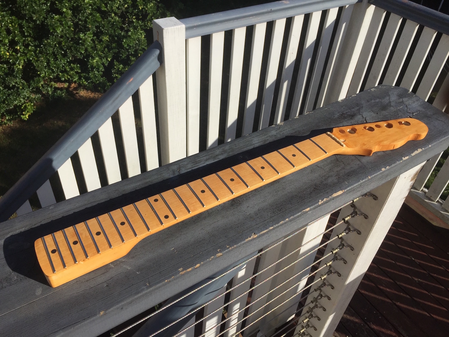

    We then went to work on the neck plugging the unwanted holes with dowel..
    Cutting off the dangly bits...
    and then bogging any gaps front and back..

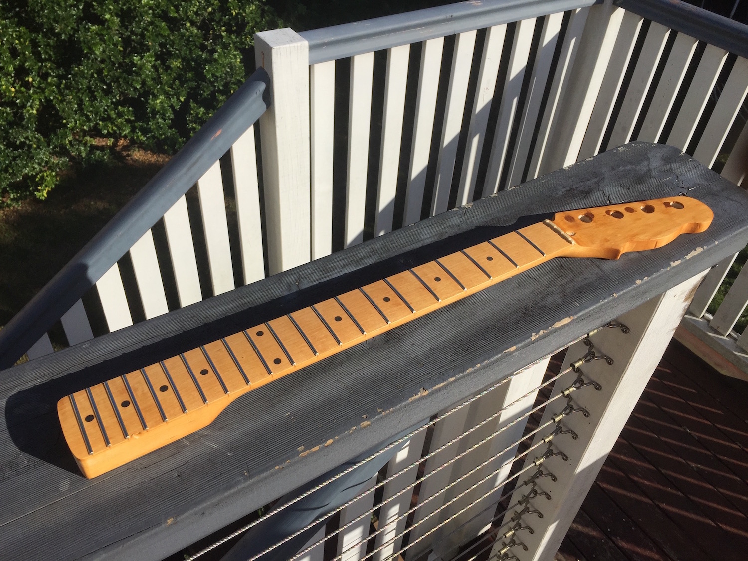

    At the end of March we took the neck over to Grandpas to use Great Grandpas drill press to sink 4 new holes that we templated up.
    Once the drilling was complete, we then ferreted around for some old stain so we could add some colour to the anemic neck.
    Lastly we cut and shaped the headstock after finding a suitable shape on the interwebs (it may or may not look similar to a Bill Crook headstock) and making a template with some of the cardboard from the box that the guitar came in.
    Here is the neck with the new bass nut.
    Now, where did that body go?.....

    Quote Originally Posted by apkane View Post
    here is the neck with the new bass nut.
    How do you intend finishing the body? If you're thinking of a solid colour, I'd recommend using the same colour on the front face of the headstock to hide the dowel ends.
