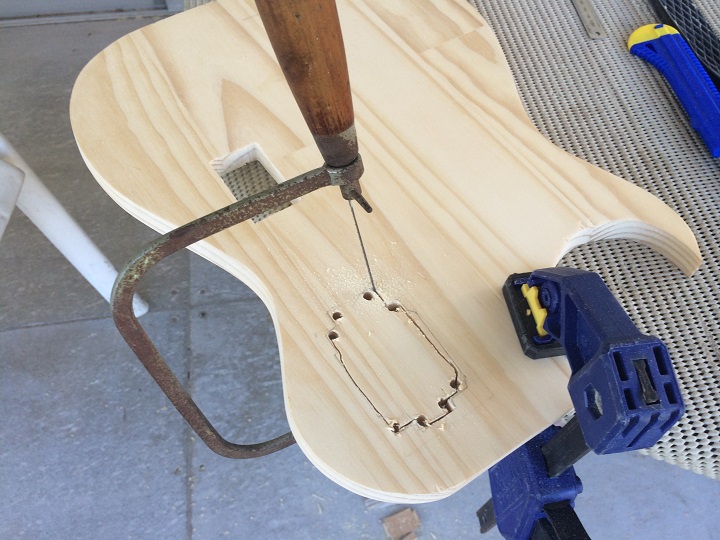

    I’ve been a bit slow of late so haven’t got a lot done, and I am finding that because I am making it up as I go I have to make decisions that may or may not create problems later in the build. So every decision seems to take forever as I try and second guess everything that I do.
    But I have started routing out the 3 piece body as best I can, trying to anticipate any future problems and will try and get it glued together in the next few days. Once glued all the major decisions will have been made and hopefully it will be full steam ahead.
    This is the back of the guitar and I am cutting out the recess hole for the pre-amp. The other access hole you can see is for the remote 9v battery.

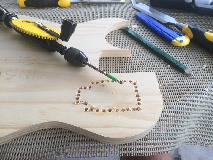

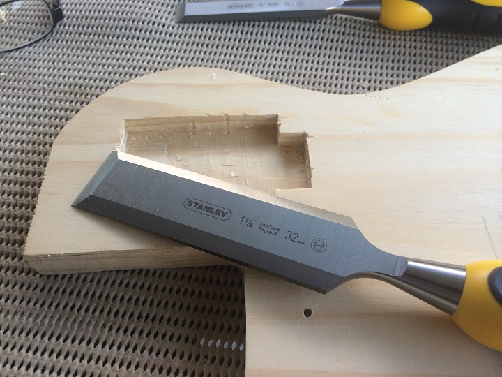

    With the front of the guitar I have to be a bit more careful as the pre-amp nearly goes though the full width of the body. I drilled a lot of "depth gauge" holes so make sure I didn't go too deep.

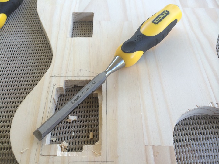

    Then roughly finished it off with a chisel. Its hard to tell from the photo but there is only a few mm of wood left before I break through the front. Whew!
