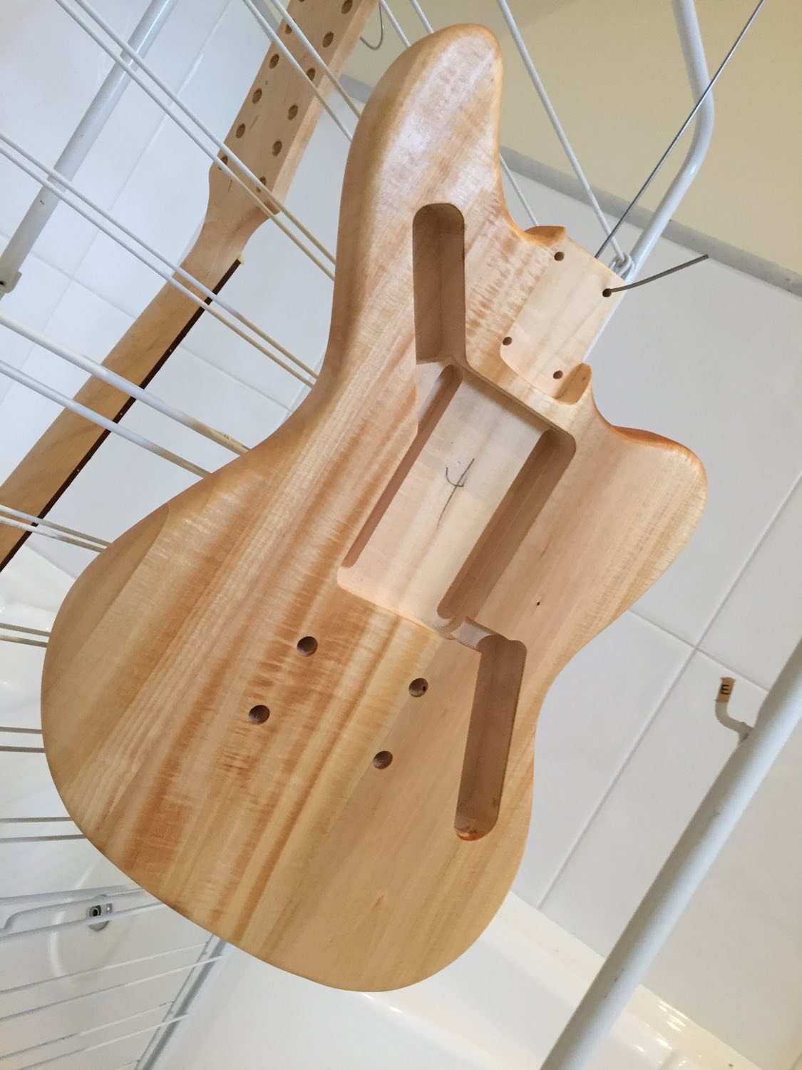

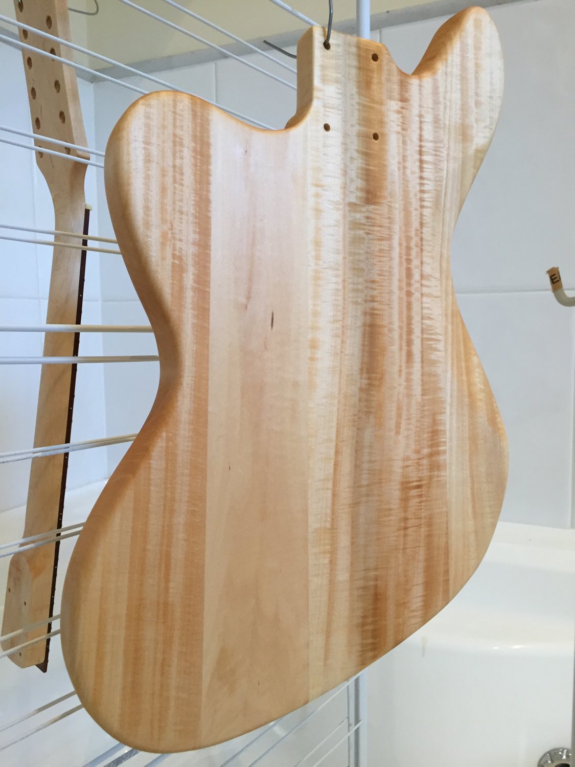

    Natural stain'n'grain.
    I notice now that the 2nd plank from the bottom has been sawn at 90 degrees to the other three, hence the absence of grain. (It's also clear when you look end-on at the cutaway). I don't think this will be too visible behind the pickguard etc, but imho it is a minor QA fail (and one that my initial inspection didn't detect).

  4. #13
    looking good RJI, I wouldn't worry too much with the variation of grain, once the pickguard is on and all buttoned up doubt it will be as noticeable.
  5. #14
    That finish looks great! Is that the natural DT? IMHO that basswood grain looks awesome.
  6. #15
    Sometimes you get lucky with Basswood as you have on this occasion. The natural stain works really well too.

    Well, I did order ash! 😉
    Natural dingo tone. The first coat soaked up about 2/3 of the bottle, so I may as well splash the rest on at the weekend.
    I notice the neck absorbs barely any of the stain - presumably because the maple is less porous.
  8. #17
    Spot on. They don't call it rock maple for no reason. You will also find that 1st coats are extremely thirsty and 2nd should go on a bit easier and spread further.
  9. #18
    RJI I'm pretty sure the body is basswood looking at the raw pics early in the diary. There may have been a mix up at the factory. I wouldn't worry too much the grain looks pretty good.

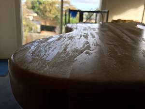

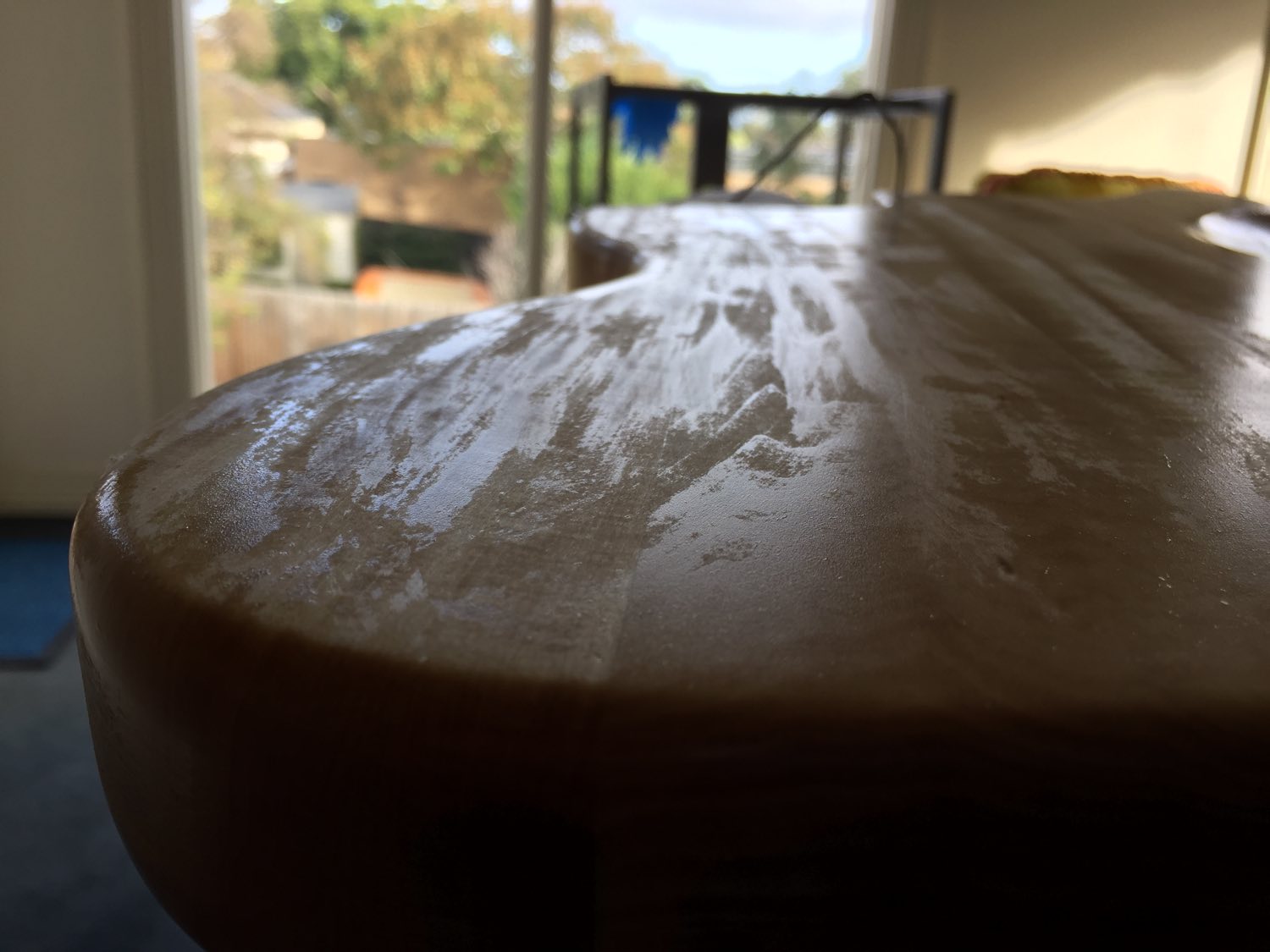

    Well, in answer to my own question, it looks like skipping the intensifier is a pretty bad idea.
    Time for option c) - a bit of sanding.
