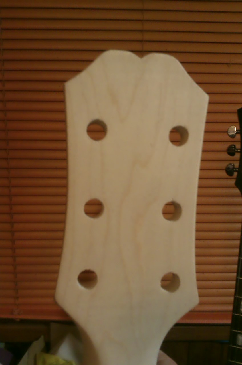

    Headstock
    So I am thinking of something Epiphoney (see what I did there?). Still some smoothing to do, but it's getting there. I cut the corners off with a tenon saw and shaped it with a rasp.

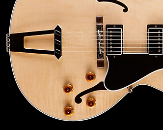

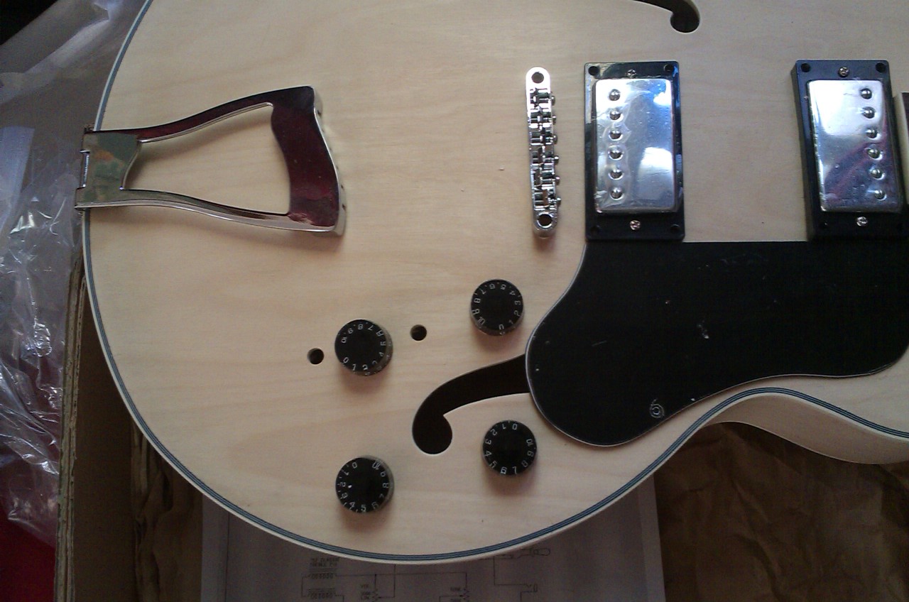

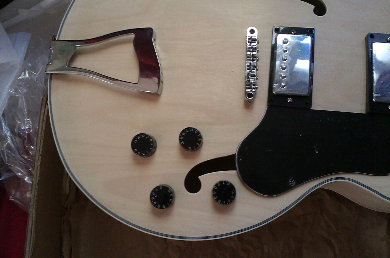

    Control layout
    Getting a bit ahead of myself but I would welcome opinions. The holes for the volume and tone controls have been made in a sort of "Southern Cross" pattern (first photo.) I could fill and re-drill for the neck volume and keep the repair concealed under the knob (second photo.) To get a more accurate ES-175 pattern (3rd photo) would require repairs beyond my capabilities especially as I am considering a natural finish. EDIT: added a photo of an original 175. I suspect that the hole cutting template was applied about 90deg out of whack on mine.

    Quote Originally Posted by Taswegian View Post
    Your, lucky one of my was way too close to the binding.
