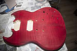

    Problem solved! I sanded very carefuly and the gap now is soooo small it's hard to see, I meassured like you said, the two outer strings to the bridge and that seems to be perfect.
    I sanded the top of the body down to 600 grains then gave it the first treat of red tone which I received from England today. Most of it got as I wanted it, but I think I'll sand down the sides a little more since it seems darker there. Maybe I didn't get the sides as fine sanded as the top of the body. So sand sand and then sand again tomorrow. I like the red colour though
    Picture just before the first coat of guitar toner:

    Here the top of the body got one coat of red guitar toner:

    Plan after coating is to give it a french polish with several coatings of shell laques.

    That colour looks great! Good work so far

    Hi Johnny, the sides will go darker due to the end grain which soaks up more of the stain.

    love the colour Johnny, well done
    glad you sorted the neck heel/pocket issues/
    I figured that out dingo. I have given the top and bottom two more coatings so it looks more simmilar. I can't wail til I can give it french polishing to make it shiiiiiiineeeeee.
