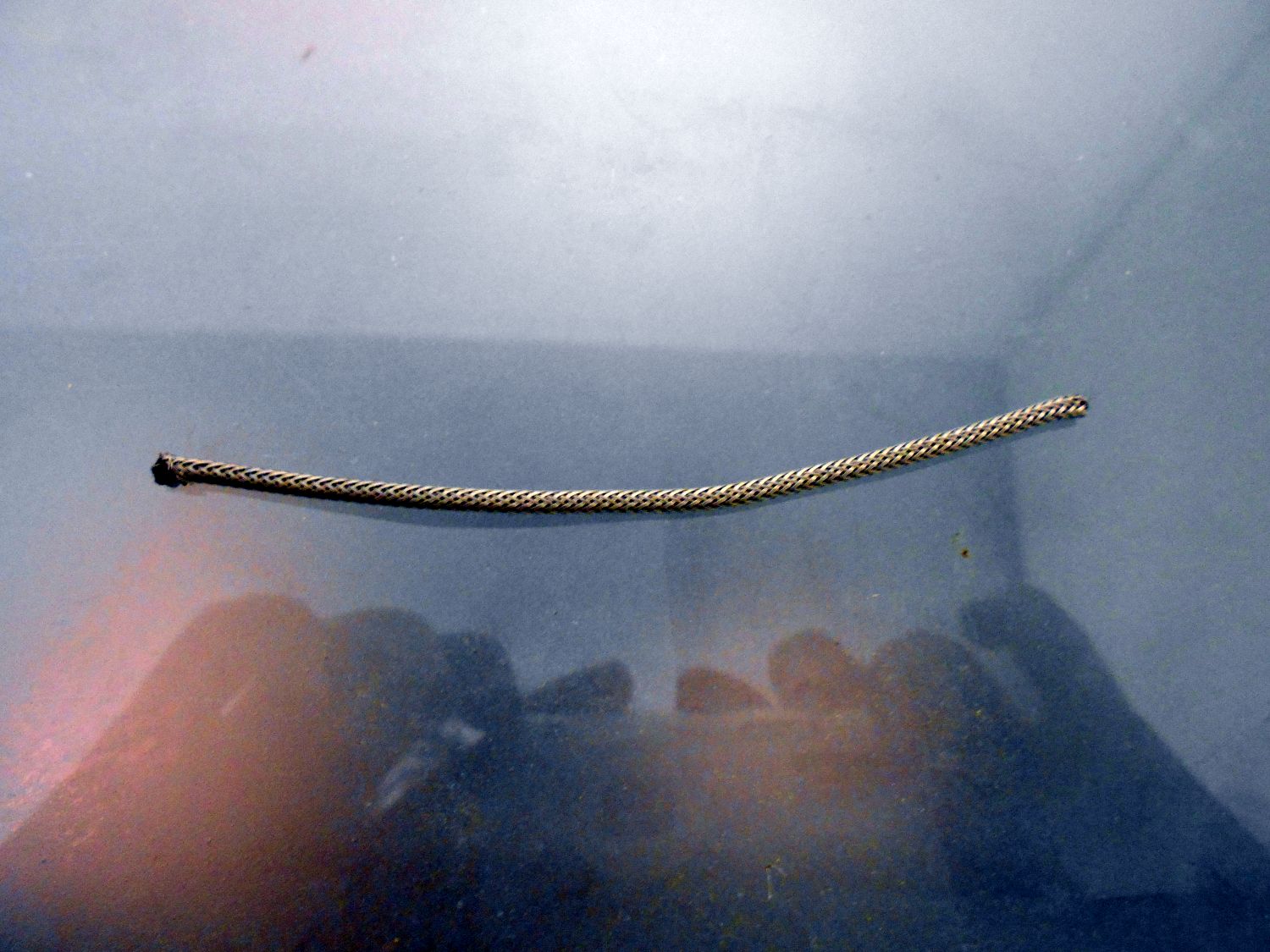

    Here's how I prepared a piece of vintage braid-shielded cloth-wire I used for the output-jack in my Strat build ( I'm using a short leftover piece for this):
    I started off by cutting the wire to length:

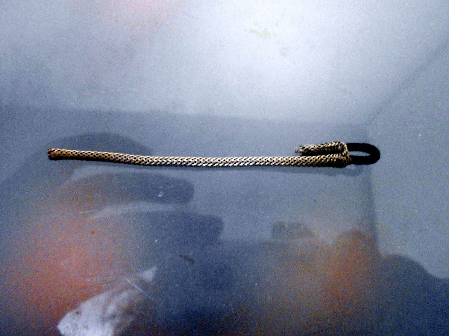

    Next I held the wire between my thumb and index finger about 13mm from the end of the wire , and carefully pushed the braid back till the inner-wire was exposed:

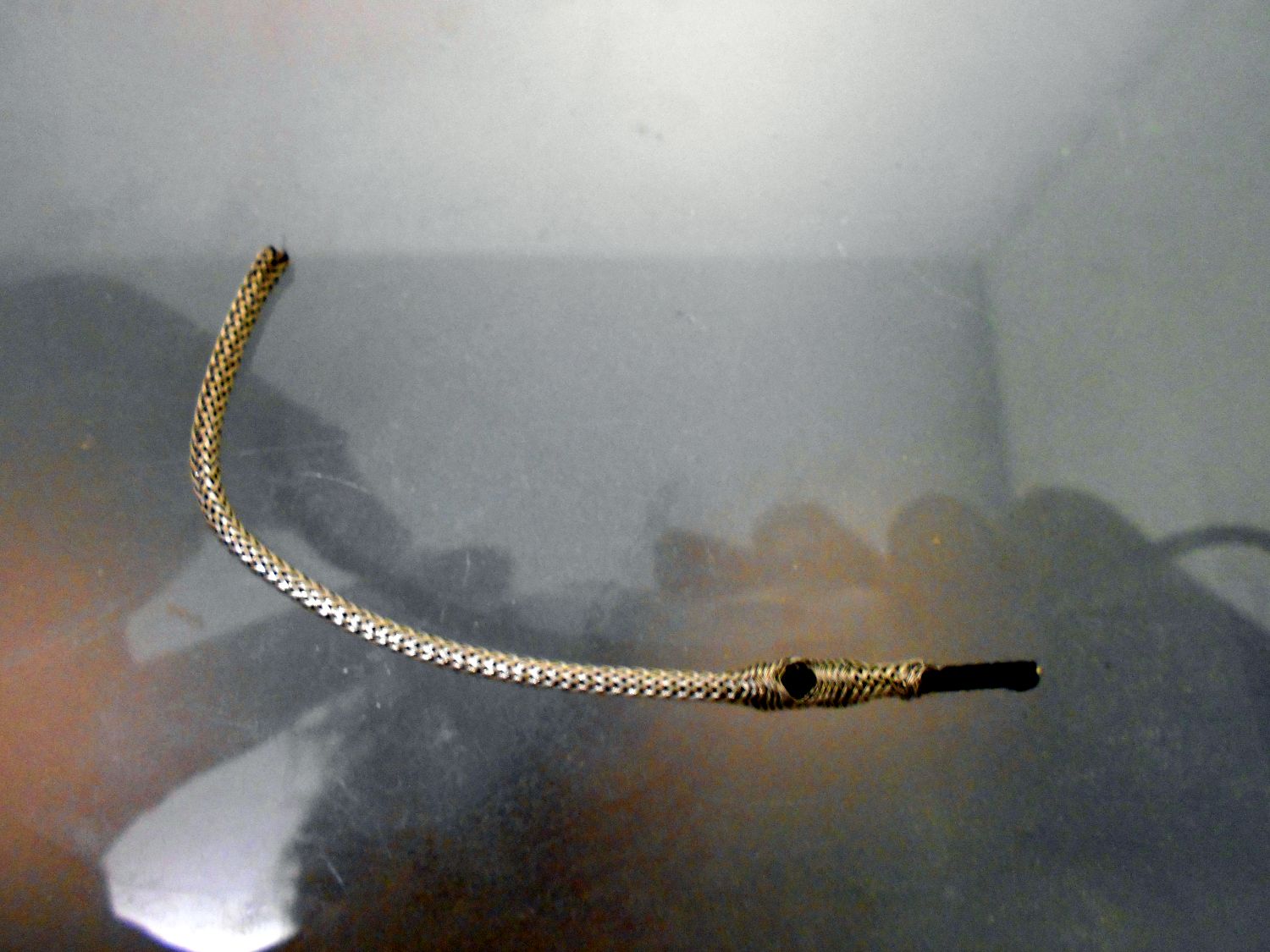

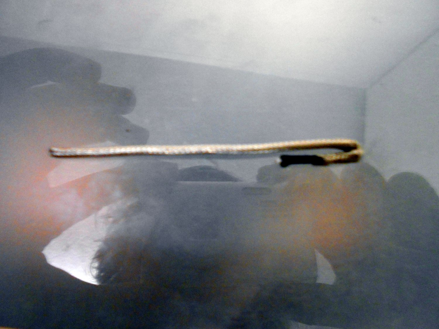

    Next I bent the wire back on itself where the hole in the braid was:
    After doing that, I used the multimeter probe to enlarge the hole in the braid, and then I pulled the inner wire through the hole in the braid:

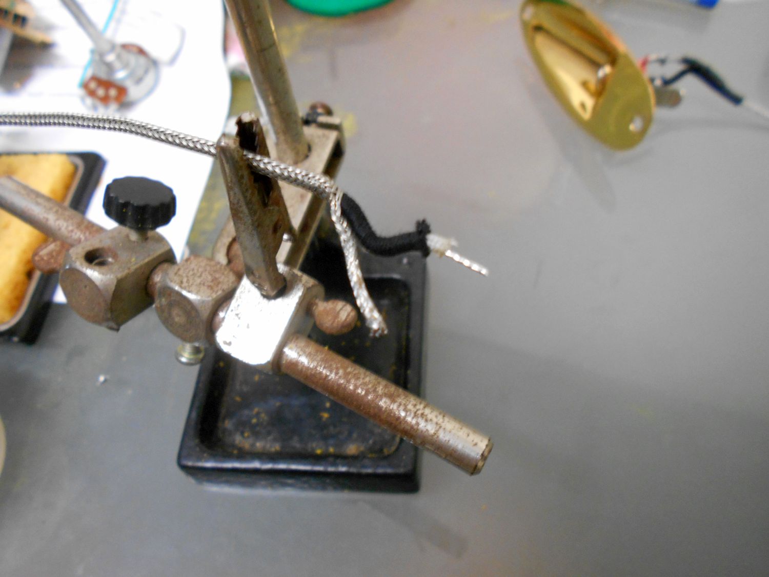

    After doing that I pushed back the inner-wire cloth insulation to expose the inner-wire:

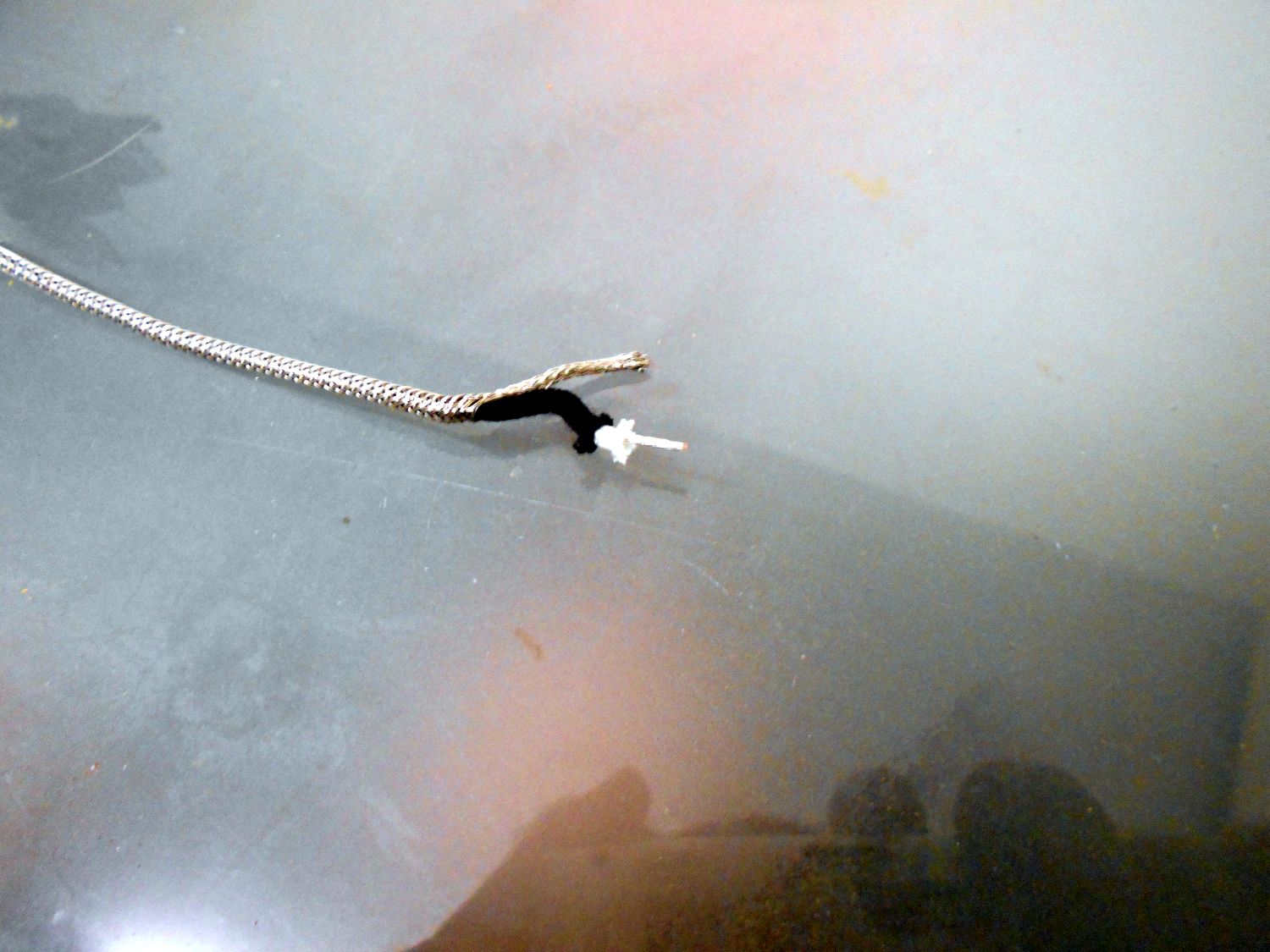

    And then I put the wire in a holding device called a Third-Hand, and tinned the exposed inner-wire and the braid:

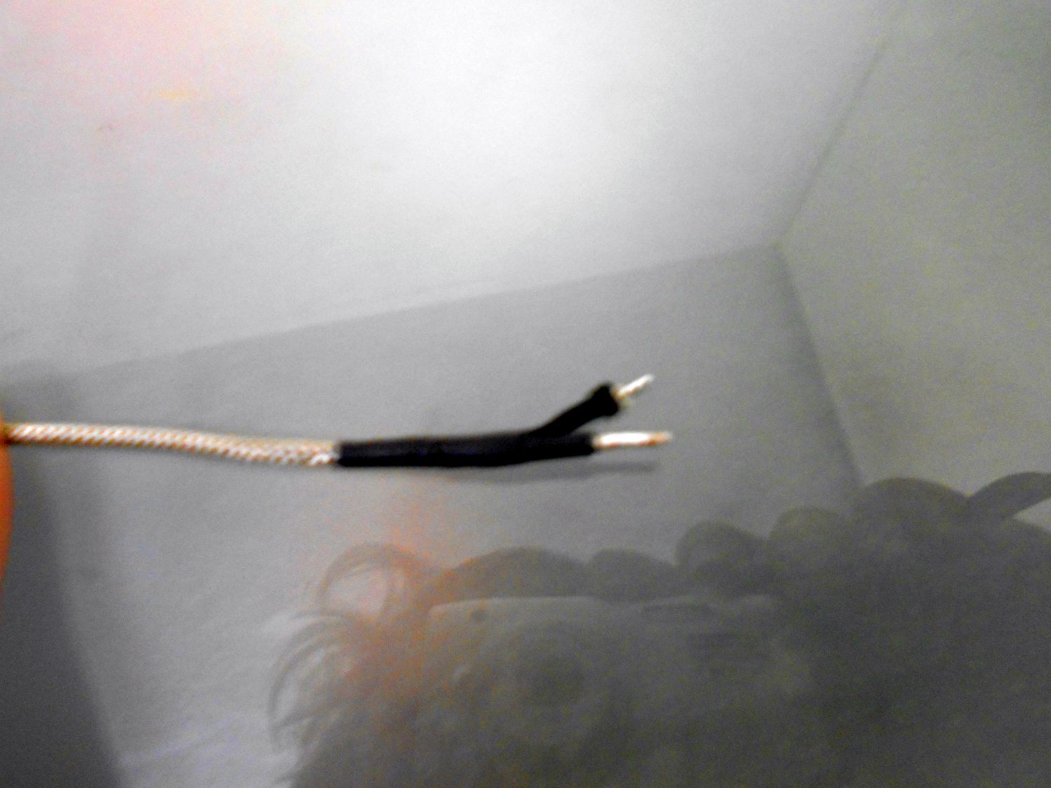

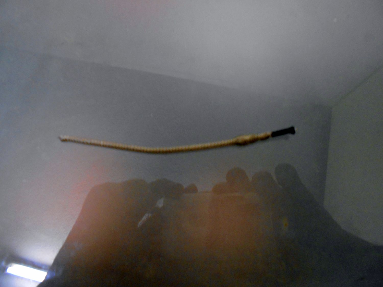

    Next, I cut two short pieces of heatshrink tubing, I slipped one of the pieces of heatshrink over the wire and the other piece over the braid, then I used the tip of my soldering iron to shrink the tubing on the braid, after I did that, I slid the other piece of heatshrink-tubing into place and used my iron to shrink it, I ended up with a neat looking piece of shielded wire:
