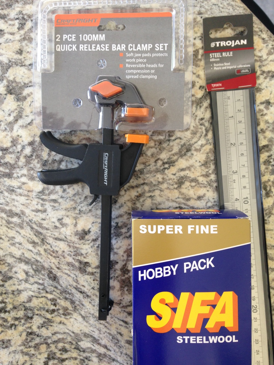

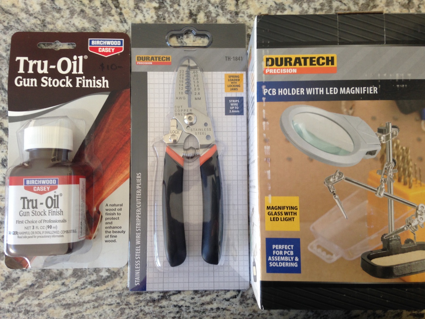

    No actual build progress. I am mulling a few things over but I have bought some goodies.
    Interested to know if anyone has seen the "3rd hand" jig. Might be handy to hold soldering iron if nothing else
    nice collection mate

    the helping hand is invaluable. Nice choice
