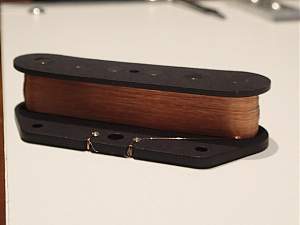

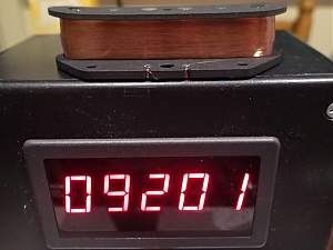

    Hot off the winder Wok
    between 1951-1964 they scatterwound tele bridge pickup to 9200 winds, today they machine wind to about 7800.
    Heres a good look at your new Pup Wok, bit more to do on this yet, solder the wires solder the plate and pot it oh and wind the neck in thin thin 43AWG when i get a chance. I call this place wire snap city using that stuff. you can hear me calling it names all the way to WA haha

    Now we are unravelling, my phone goes, grab for it, catch multi meter prong on the lead in wire and snap close to the winding, no saving it.
    Why couldnt it have been the lead out wire grrrrr one wind back and you can save it...
    Oh well time to go again tomorrow.
    heres your pickup, dont think it will work lol
