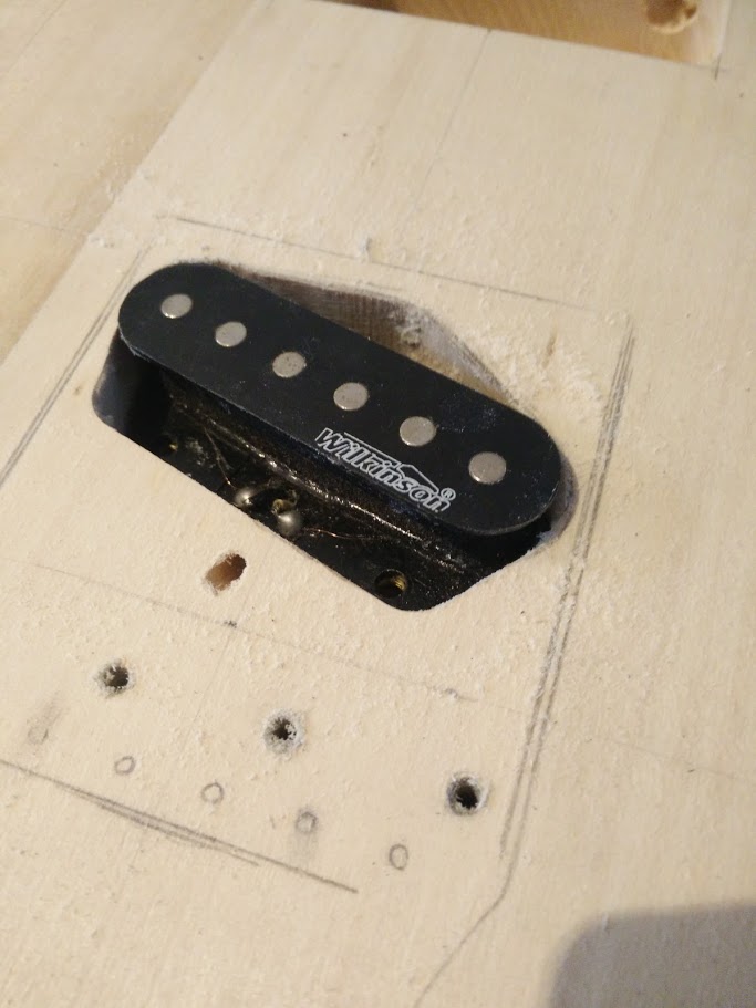

    Found a few moments to try a quick mock up, and found issue 1:
    My Wilkinson tele bridge pickup won't fit into the hole.
    Not much bigger than the hole, but enough that I can't force it. I also want a bit of wiggle room to be able to locate the bridge properly. So the hole needs to be bigger.
    I guess I can use the dremel or a chisel to do this - but would appreciate any advice before I start chipping away. Surely others have had this problem?
    I used a drum sander on a drill, a couple of diff sizes. As you say it's not much to take out

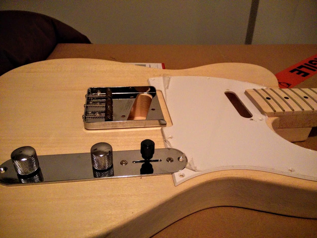

    Mock build - look Ma, no screws!
    Rightio, thanks for the tips on the routing and body hanging everyone! Gonna hit up the hardware store for some sanding drums on the weekend.
    Meanwhile, finished a quick mock up. Nothing is screwed in yet, just playing with the spacing. Neck fit is snug and appears to be on straight - i followed the neck positioning guide in the instructional forum.
    @Wokka for bridge positioning, I measured the distances from the flat face of the nut (fret side) to the crown of the 12th fret - 322mm. I then moved all the bridge saddles as far forward as they could go, and positioned the bridge so that the high E saddle was 322mm from the crown of the 12th fret. Is that correct? I feel like there's no room for correction if I needed to move the high E saddle forward during setup?

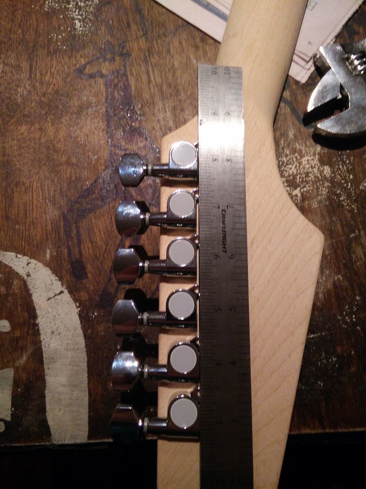

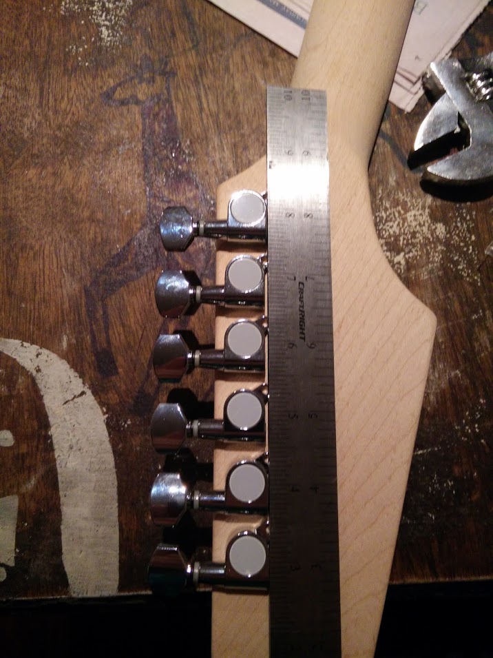

    First step was machine heads. The holes aren't exactly straight, which seems to be a thing with some of these necks, but honestly not enough for me to replug and redrill.

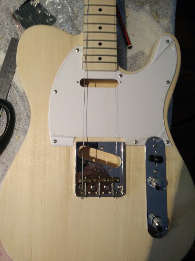

    Next was neck attachment. I widened the holes on the body for the neck plate screws, so that I only threaded into the neck (not the body). I then placed the pickguard and control plate.
    I lined up the bride using the E and e strings, pretty happy with the location. Spent a bit of time making sure the spacing between the pickguard and bridge was even.
    For reference: distance from nut to crown of 12th fret was 323mm, so I placed the bridge so the high e string saddle was 323mm at maximum length.

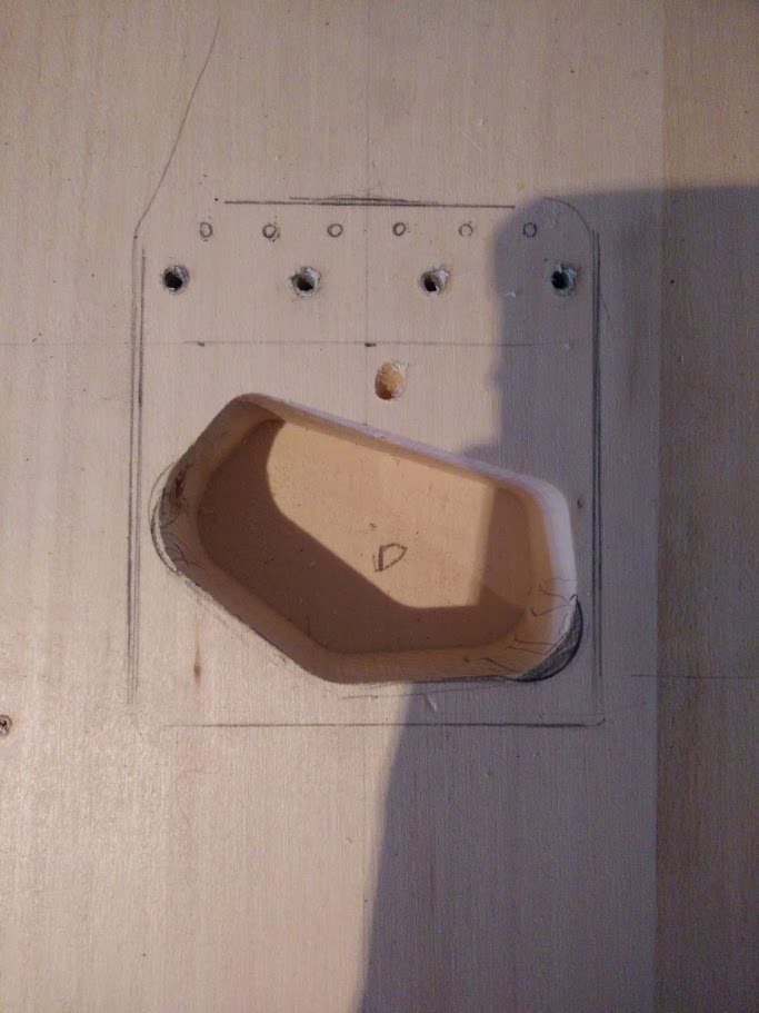

    I was able to mark out how much to route the bridge cavity. I went with @wokka's tip - got some flywheels on my hand drill, took about 4 minutes of careful removal, but the pickup fits now

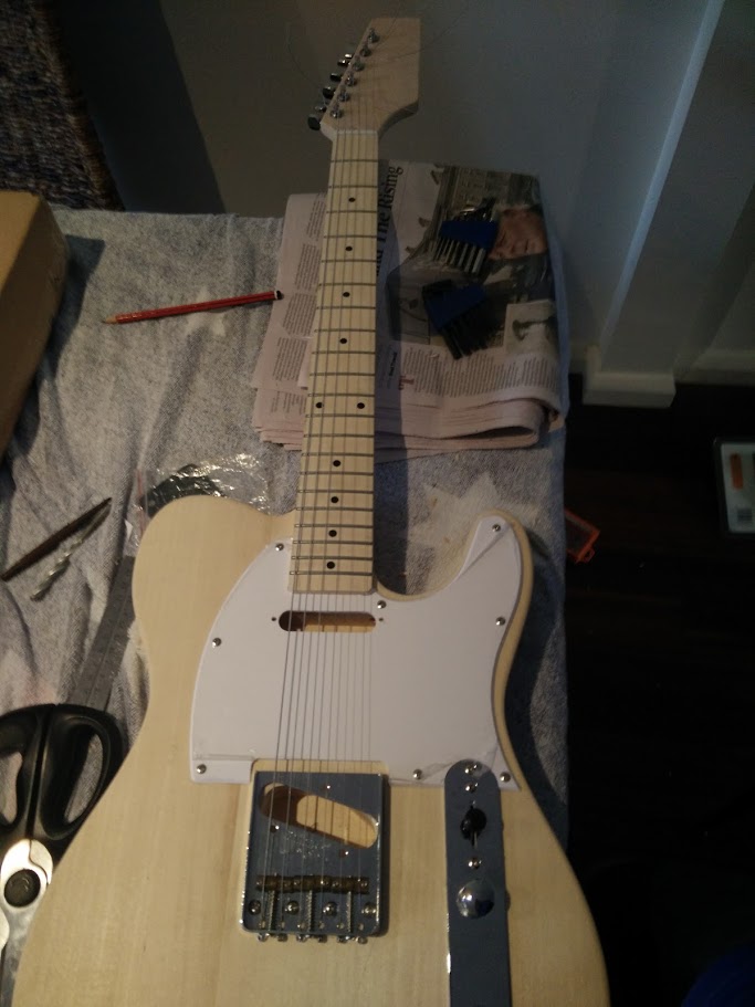

    I strung her up and had a strum - getting heaps of open string buzz.
    I haven't tried any set up or anything, but it looks like the strings are pretty much touching the first fret. Is this something I should look at now, before starting sanding and finishing?
