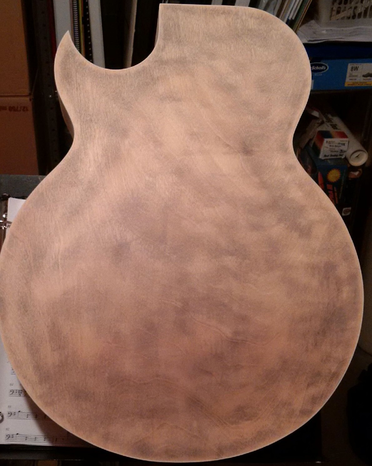

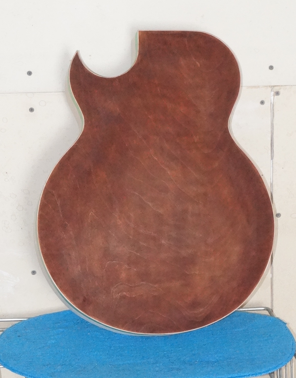

    Decided the back was too dark and sanded it back down. That dye really sinks in deep though and I'm not sure how even I can get it. Will try restaining tomorrow with a 50/50 mix of burnt sienna and brunt umber.

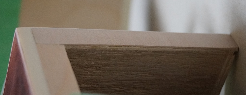

    I've also replaced the piece of veneer on the lower side of the neck cutout. Needs just a touch of wood filler maybe, but it's worked out well I think. Most of the repair is hidden by the overlap piece of the neck anyways but I wanted a good surface for it to sit on and glue to.

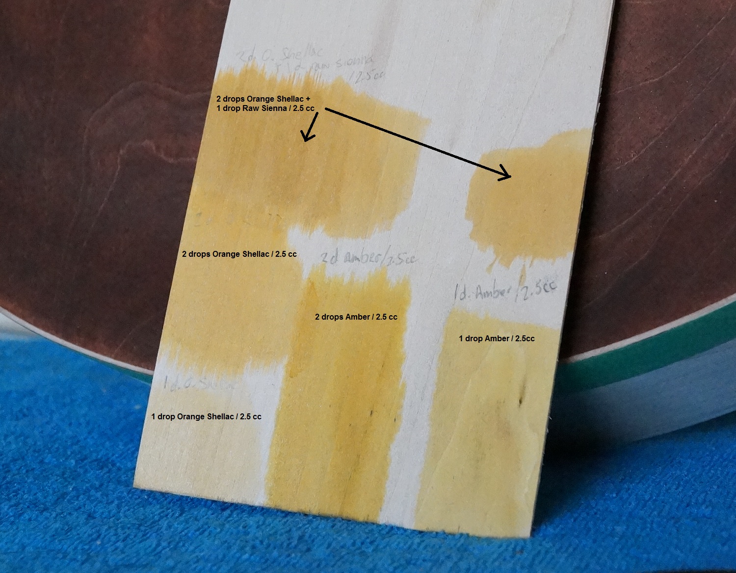

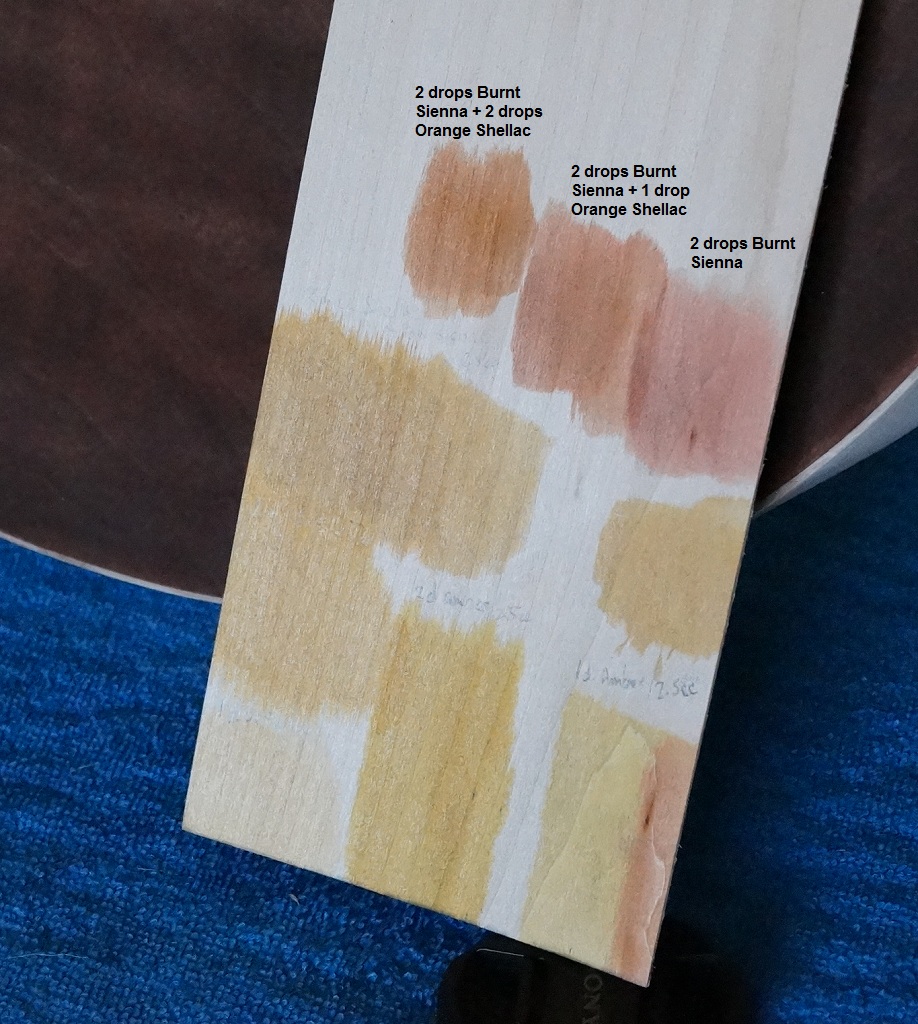

    Since I had all the dyes out, I thought I'd try a few samples for the side and top colour(s). I want to go lighter but still keep a bit of the reddish hue from the back.
    Anyone have any thoughts about any of these samples? Good, bad, terrible?
Name:	front colour choices.jpg
    Member peterh's Avatar
    Peterborough, ON. Canada
    133
    One more set of colours. Diggin' the reds lately.
    All these colour samples were just one application of dye.
Name:	front colour choices 2.jpg

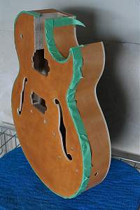

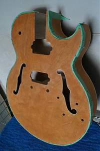

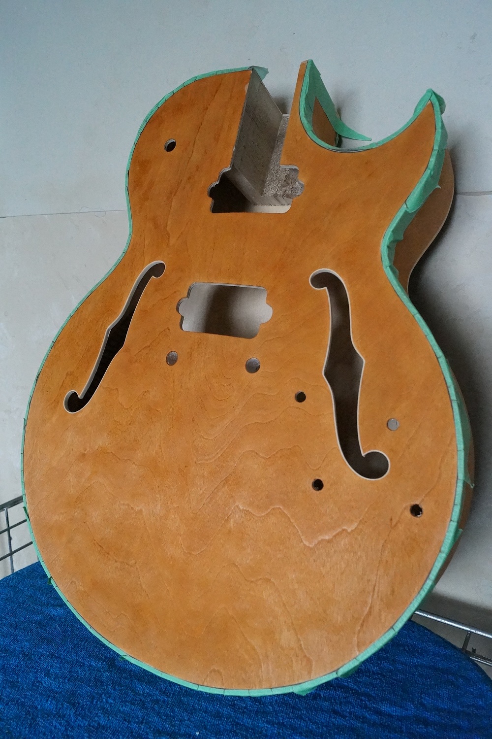

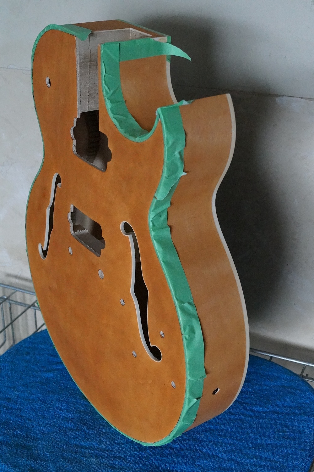

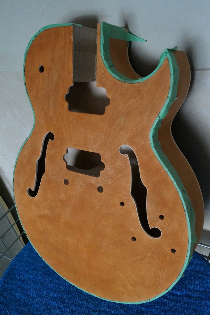

    After pondering for a while over a beer and consulting with my son, I didn't go with any of these choices
    Well, okay, almost but after a couple more test samples I decided on 4/4/1 drops of Burnt Sienna/Yellow-R/Raw Sienna in 20cc water for the first and second coats on the sides and first coat for the face plus 4/2/2 drops of each for the second staining on the face. Here's the end result which I'm really pleased with - it's kind of a mapley colour. The side angle shot showing front/side is pretty close to the real colours.
    In a moment (several actually) of over anticipation, I forgot to mask of the binding on the back/side when I stained the sides, so I'll have a bit of extra cleaning up to do at the end.
    This got me to thinking.... when you apply the finish (Tru Oil for me) do you go right over the binding and if so, do you scrape it down later or just leave the finish right over the binding?
Name:	front stained.jpg
Name:	front stained 2.jpg
Name:	front and side stained.jpg
