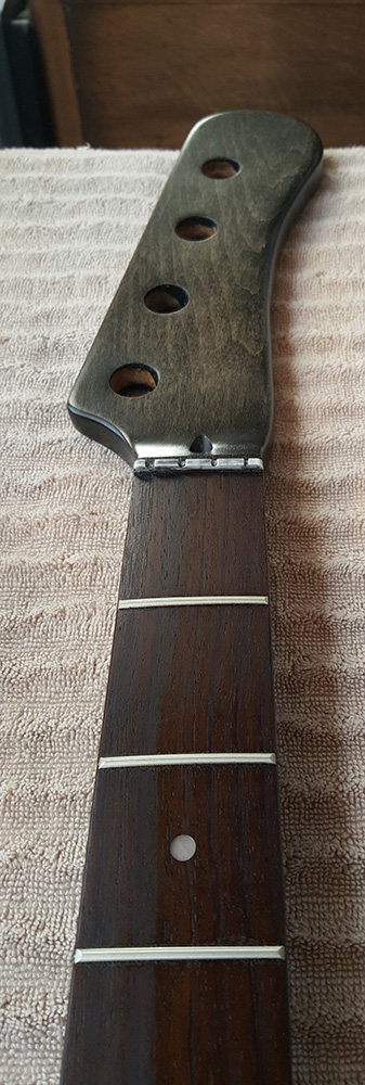

Hi. A little behind on posting, work and such has been a little over the top. But had a minute so I thought I'd post some of the progress. My dad got me a VP-4 for my birthday. He's PapaKen, built the ES-1GT in the Feb GOTM (which is a freaking SPECTACULAR guitar - I got to see and play it in person, I know pics don't do justice but it was phenomenal). We had been chatting and I was talking about wanting to start another project, and I love the big chrome pieces on the VP-4. So, for my bday, one showed up in the mail.

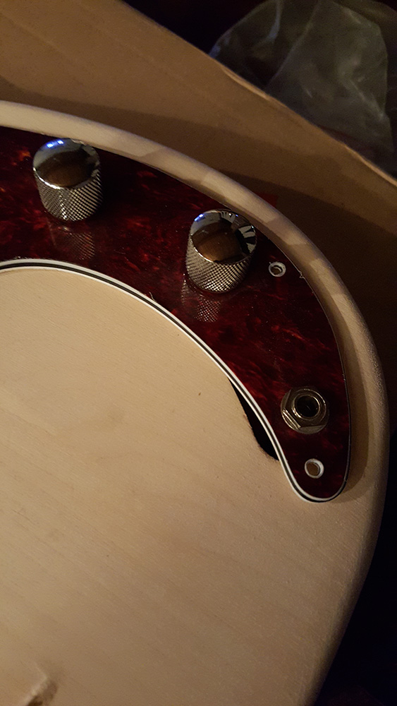

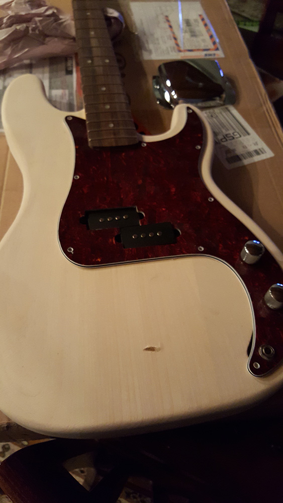

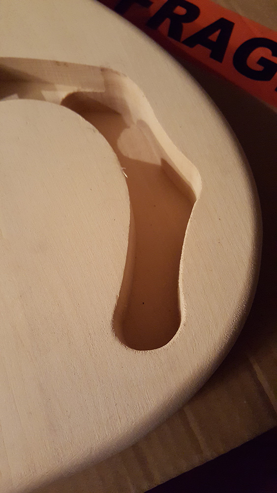

Right out of the package, I was a little disappointed to be honest. The ground wire on the pots was literally hanging by a wire - it fell off as soon as I pulled the pick guard out. No biggy, I love soldering anyway. Then I did a dry fit - the neck and pocket have a very noticeable gap when dry fit. I couldn't get a good picture since it just looks like a shadow, but imagine if the pocket was cut so the sides were lower than the center or the neck was cut so the middle was thicker than the sides - there is a noticable gap on each side. No biggy, just some sanding and leveling. The pick guard... there is a huge gap at the end where the jack is. The guard comes to a point, and the routed hole actually widens. It can be moved to cover the hole, but then the neck cut out is waaaaay off. Even trimming up one side of the neck cavity part of the pick guard so it will fit around the neck and cover the routed hole isn't an option, because then the *other* side of the neck cutout on the guard is way off, and I can't *add* material. No biggy, I don't like that red in person and so the first thing I decided was I'm going to order a piece of pick guard material and make my own.

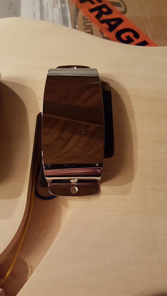

Also, the chrome cover that goes over the pups, looks like one side will just mount to *only* the pickguard. Not sure if that is normal or not.

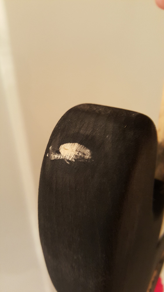

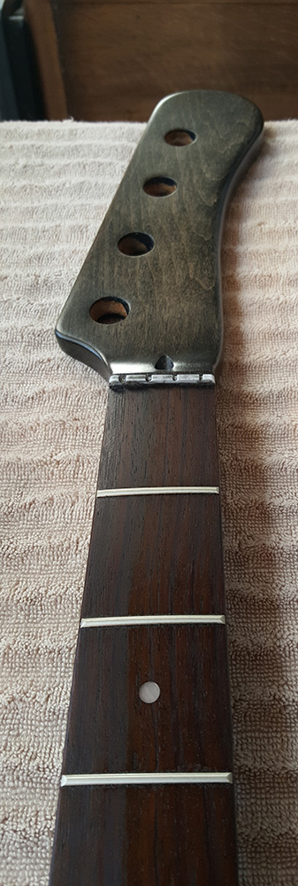

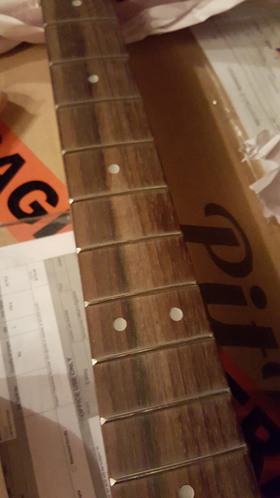

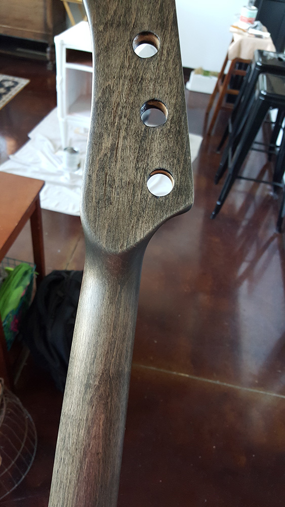

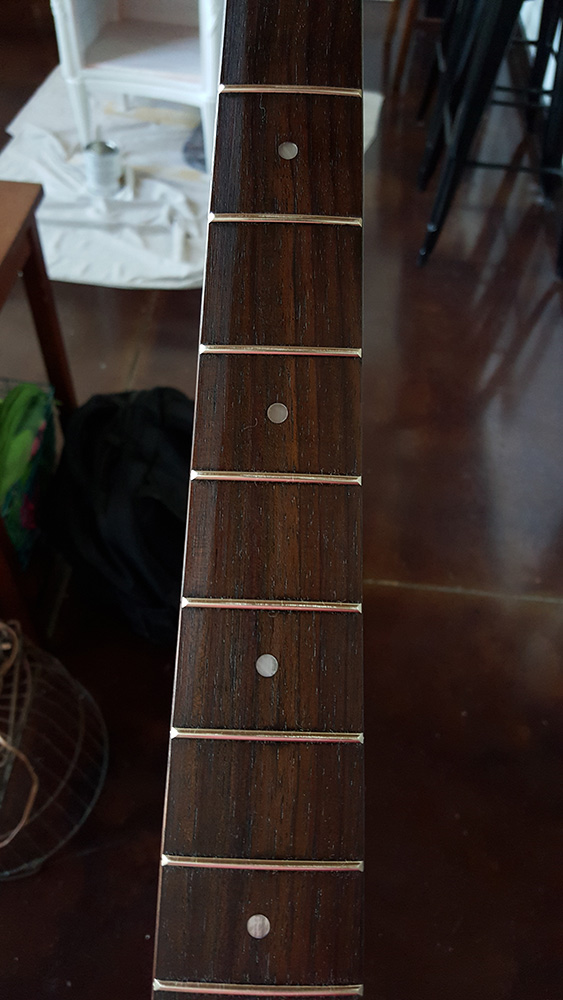

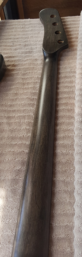

The neck had some spots that were visibly softer, and easily dented with only moderate pressure and a fingernail... But who whould press on a neck with a fingernail... My plan was to use a superglue solution to help harden the soft spots so we'll see how that goes.
