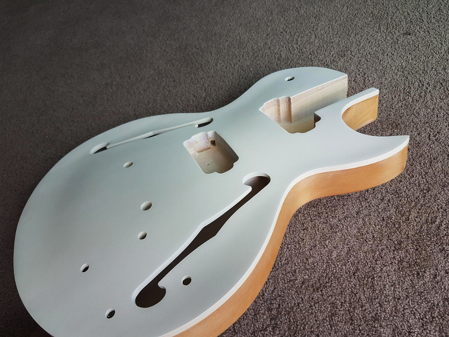

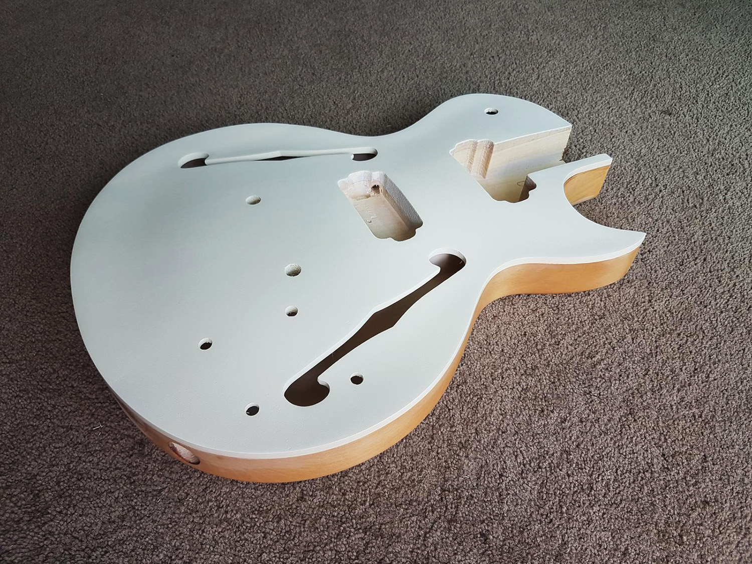

    Just finished sanding back the second coat of Montana Black, all taped up ready for the third and hopefully final.
    I want to give the top a solid layer of paint to then clear over and cut back to a sharp finish.
    Sanding all the orange peel back made it look really nice but some spots did go back to the white primer. The weird discolouring in the horn is from the stain sinking into the wood filler that must have been used in the factory. Its not too obvious in person so im ok with it.

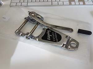

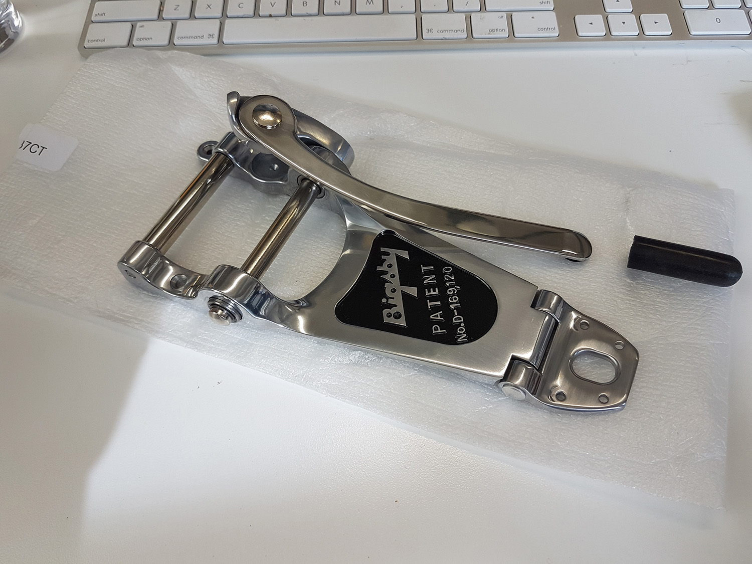

    This just arrived at work, will most more mockup pictures tonight to see how its all coming together.
    Think i may ditch the pickguard for a cleaner look with this beast on there.
  10. #20
    nice Bigsby Matty, looks like a genuine one !
