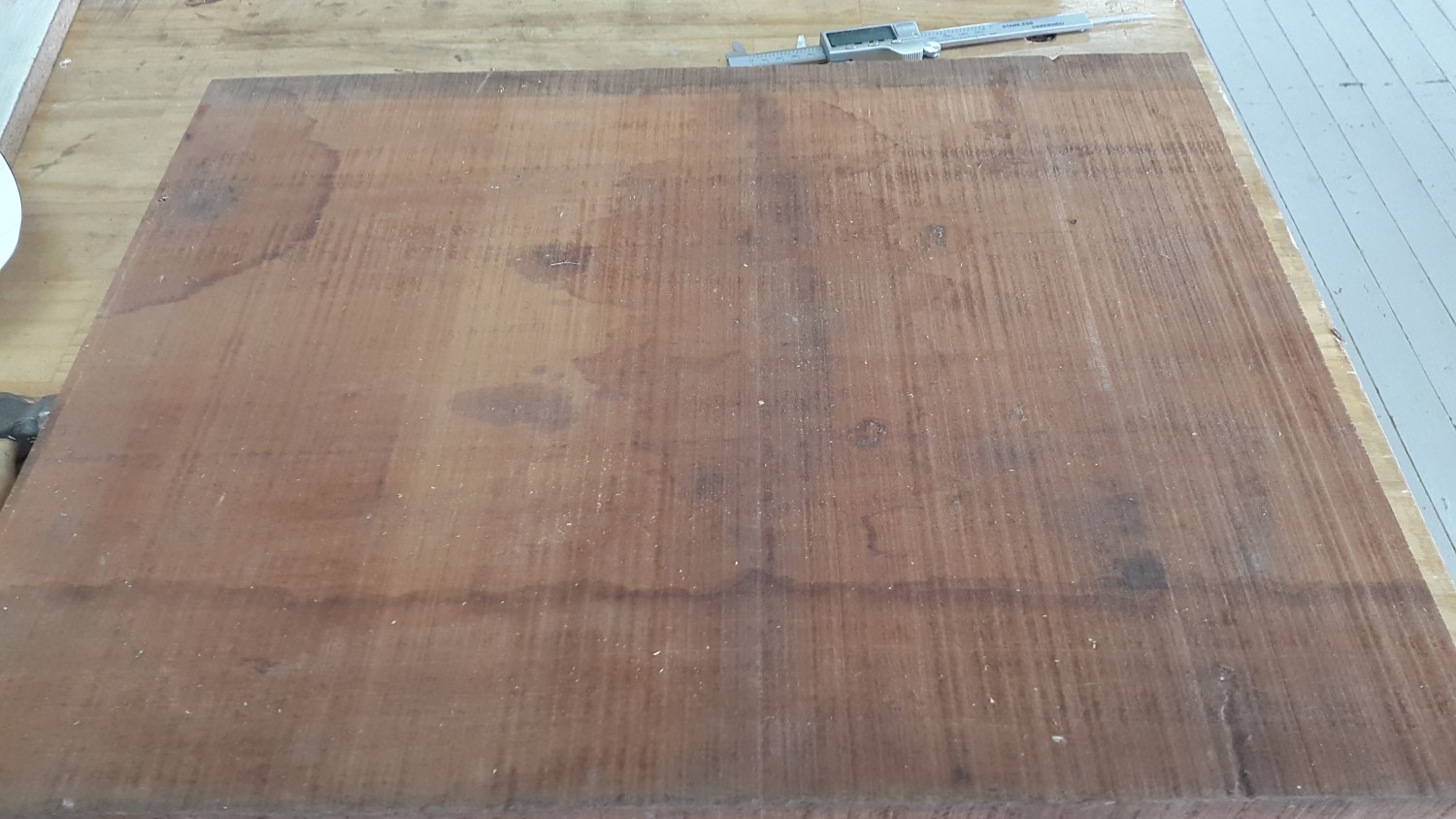

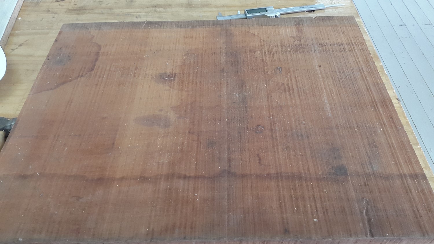

    So I got my piece of Jarrah today for the top. There was 3 bookmatched pairs to choose from, and well it basically came down to "which looks more figured" so yeah... It was actually fairly easy to catch this figuring on camera, I expected it to show a little less, because while it's definitely there, it's not amazingly striking right now, but of course it will come out much more after it's been worked with.
Name:	20160408_100836 (Custom).jpg
    Aaand plenty big enough for the body.

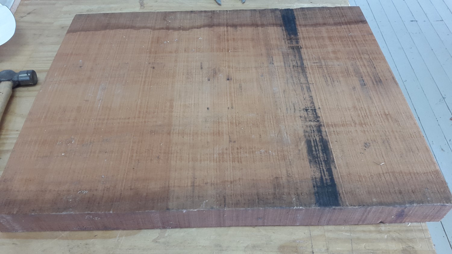

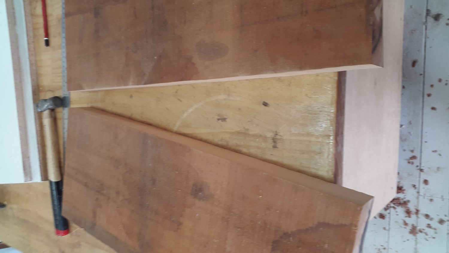

    I also got my slab of Mahogany!! It's much lighter than I expected too. It should have a bit of ribbon figuring through it, as there's 2 other guitars at the workshop that have come from the same piece of tree, and they've got some nice figuring in them. I need to remember to get pictures of them next time I head in there now that I mention it.
Name:	20160408_113733 (Custom).jpg
    Pretty dirty and messy for now but hey that's how it all starts!!

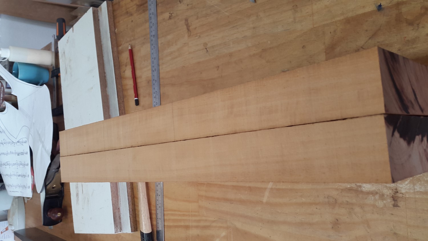

    Unfortunately, it's not going to be the "one-piece" dream. Not quite. The long story-short is that it would be less stable in the middle of the guitar, and be at risk of splitting and etc down the line, so for stability's sake, we're splitting it down the middle, and flipping the pieces around. And as you can see, it's much nicer on the inside!
Name:	20160408_114717 (Custom).jpg

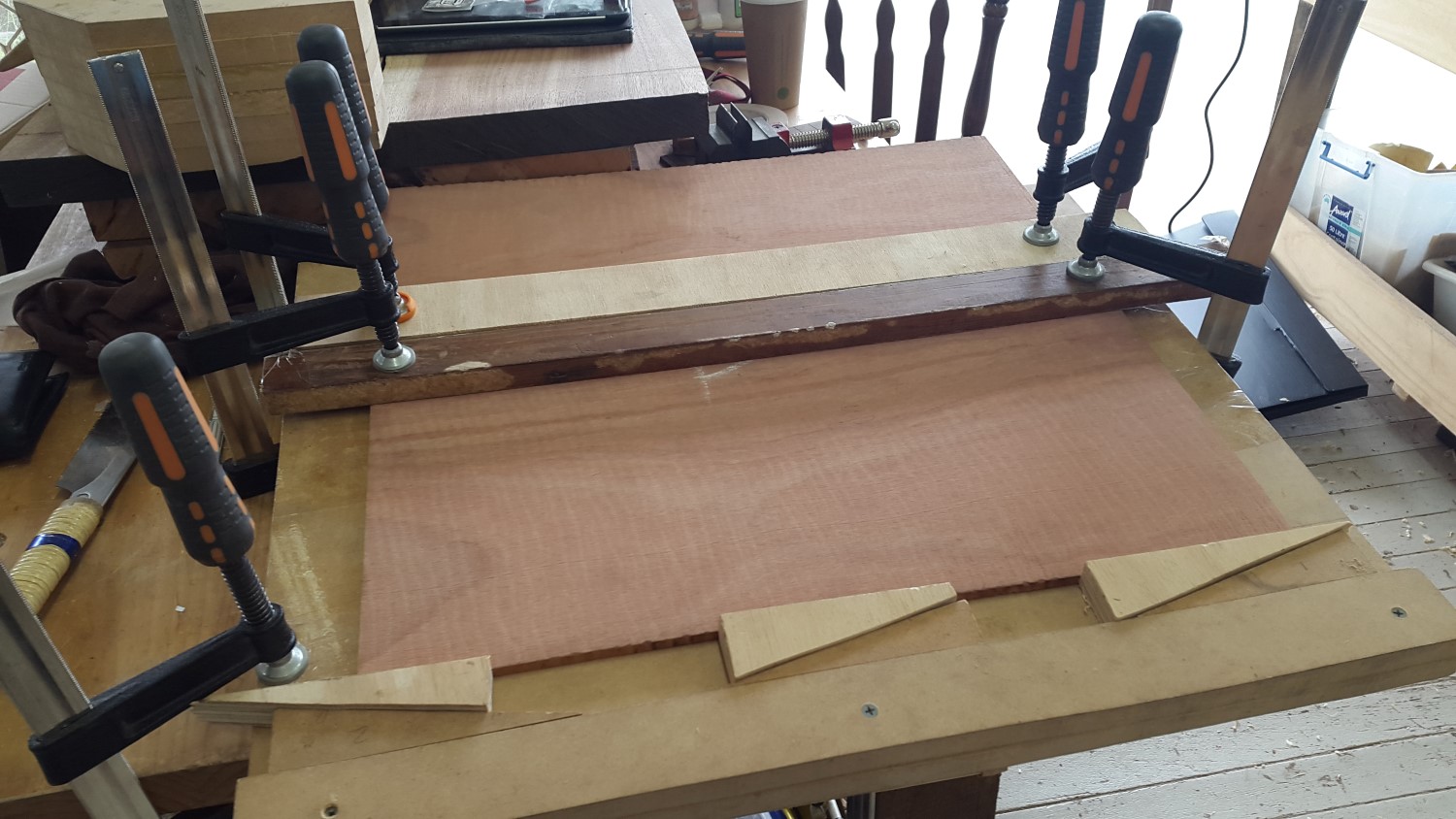

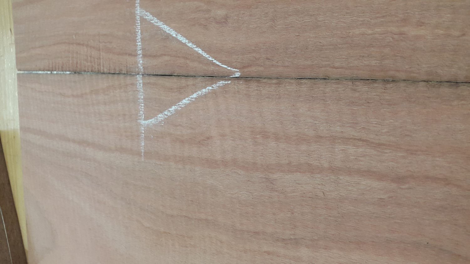

    So first thing to do today was glue up the Jarrah. The piece was already nice and even in terms of thickness, so didn't have to worry about that at all, just had to clean up the sides and get them nice and even. The figuring also became reeeallly visible there too, makes me quite excited to see how it will look later.
Name:	20160408_103815 (Custom).jpg
Name:	20160408_103819 (Custom).jpg
    After that, clamp it up, wedge some wood in, and clamp it up again, and there we have it.
Name:	20160408_112842 (Custom).jpg

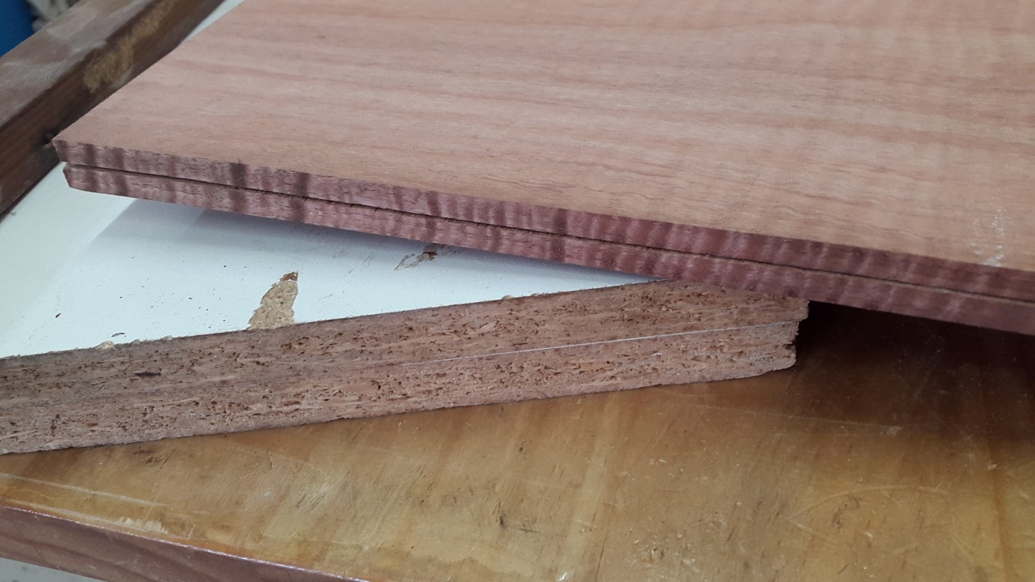

    After that was when we chopped the Mahogany in half. Then planed off the outsides to get them nice and even for gluing.
Name:	20160408_114726 (Custom).jpg

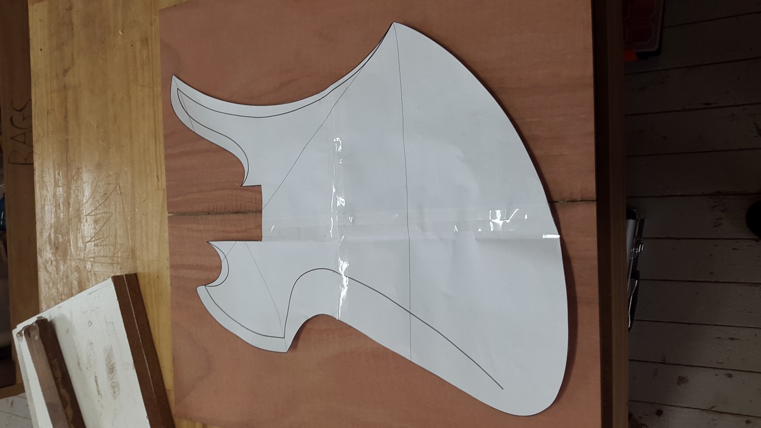

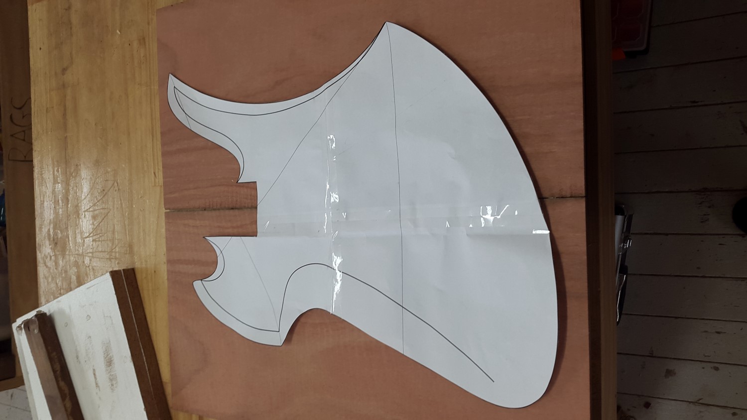

    The last thing that I did today was make up an MDF template of the body. In doing so I discovered that I'm bad at cutting accurately with a bandsaw, and so a couple of little sections had to be shifted inwards to accommodate. Not a big deal in the end really.
Name:	20160408_133558 (Custom).jpg

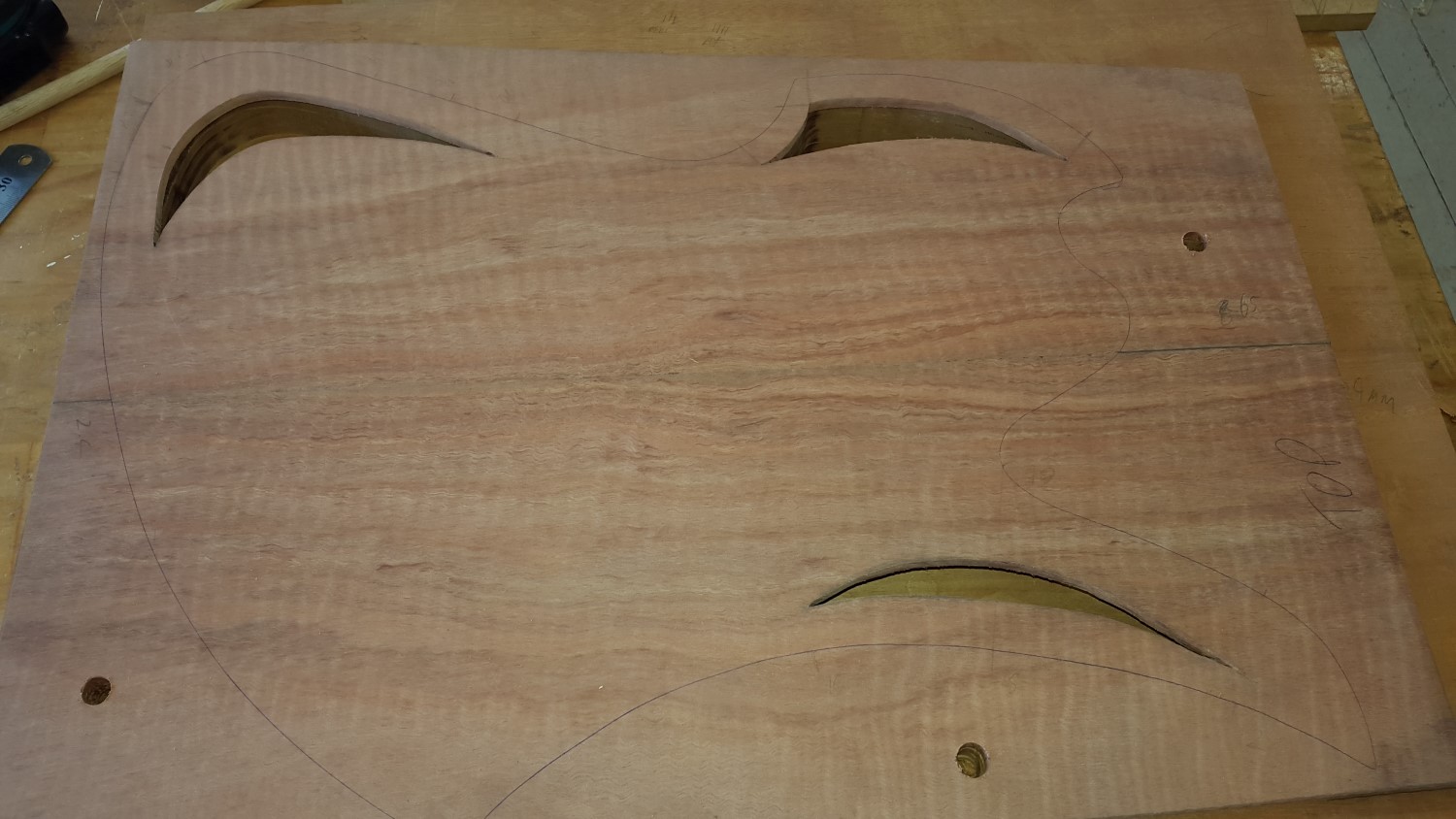

    Finally, cleaning up the Jarrah top. This was basically just running it through the Drum Sander a bunch of times, levelling out the rips from being cut and so on, and getting rid of all of the glue. I looked at it after that had been done and was a little disappointed because it looked like the figure was going to be much tamer in the centre, but we popped some Metho on it to bring out the figure and it's DEFINITELY there, and definitely heavily figured. Will make sure I get photos of that next week.
    Between then and now I have to plan the F-holes on to my template, and the chambers. But yea sorry about the lack of photos today, I'll make up for it next time!!
