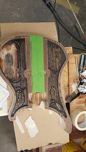

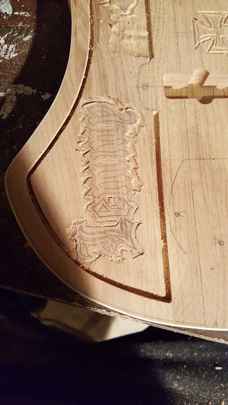

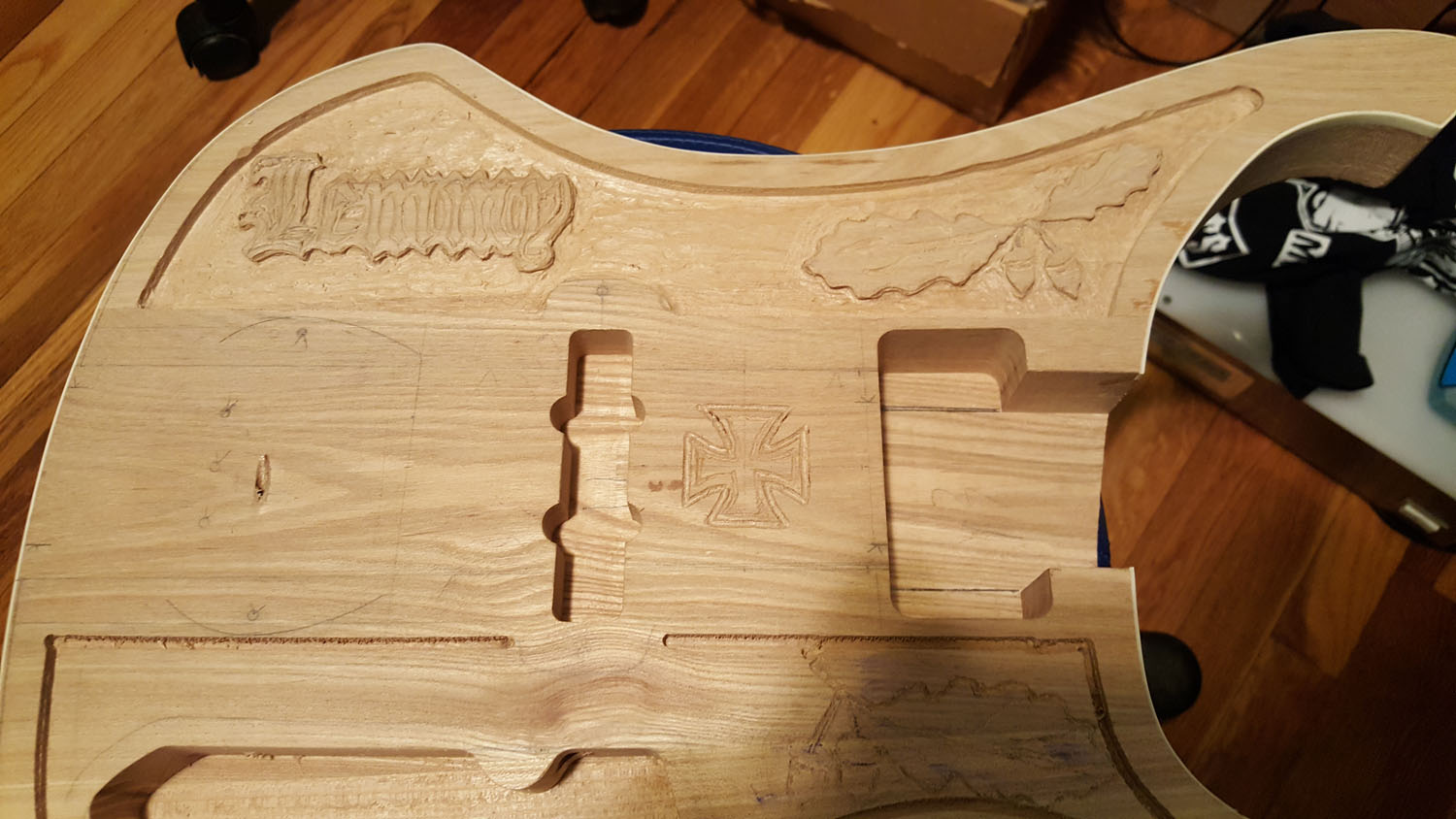

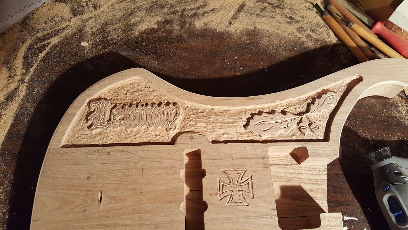

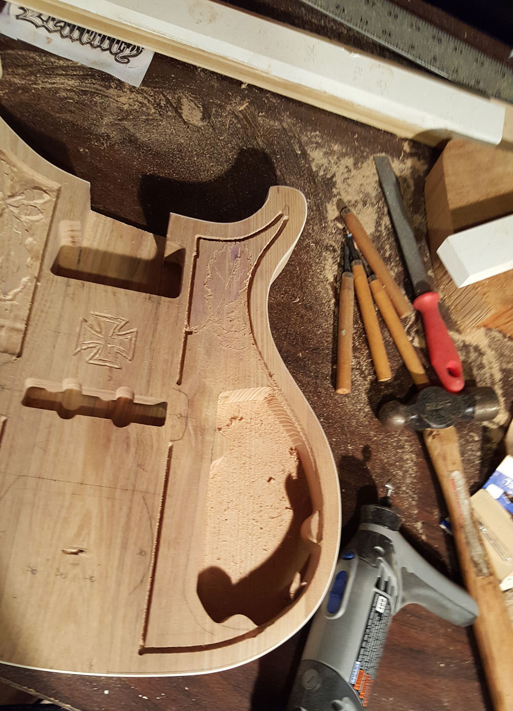

    Hello..

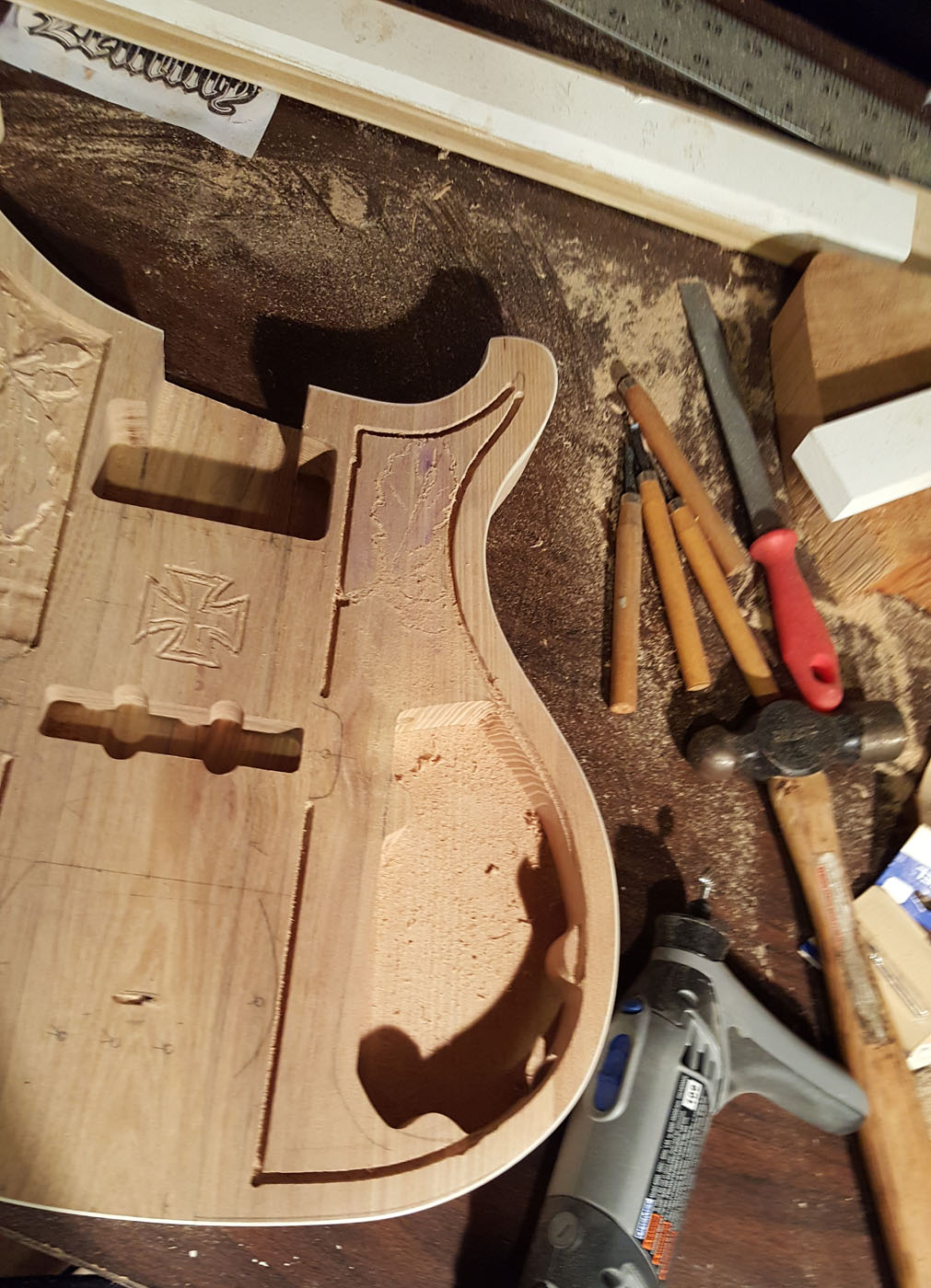

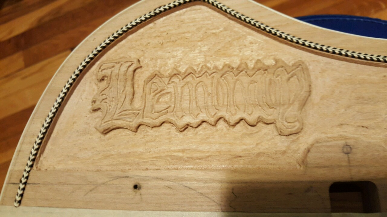

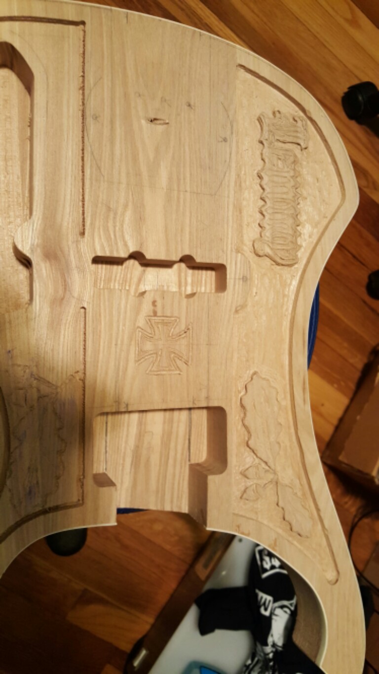

    So I started working on "Kilmister One" today.. I am now wavering on messing with the binding.. I can still do it on the table router, but I dont know yet..lol. I laid everything out, got the neck and bridge positions measured and marked, and the body marked for carving. I have ideas for a wooden humbucker ring as well as a flush mounted, wooden control cavity cover.
    I am past the point of no return! I learned something today.. .. Don't route out the boundaries of your carving areas before you carve.. seemed like a good idea until I slipped across the channel with the dremel and took a few nice chunks out of the side that isnt supposed to have any chunks out! I think I have an idea to fix that though...stay tuned for that. The carving is going fairly well. Im doing a combination of hand gouges and dremel. I started by drawing a pencil outline on the wood and engraving it in with the dremel, then went to town on it. I really wasnt sure until I got going.. now, I'm pretty happy. I still have a ton of shaping and smoothing to do, but it's getting there! I didnt want to do a Lemmy replica, but wanted to tribute HIM as well as his Ric... Enjoy the pics... more work tomorrow!!
    Dave

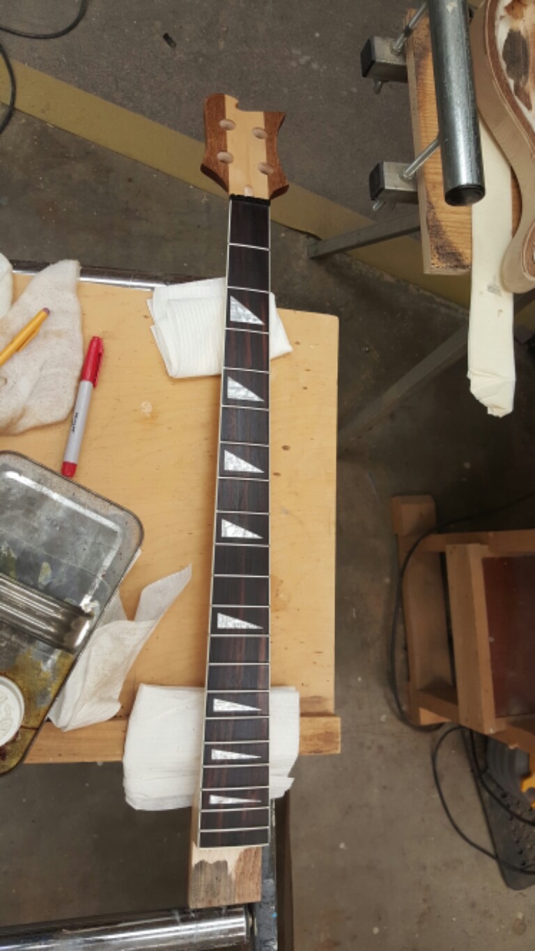

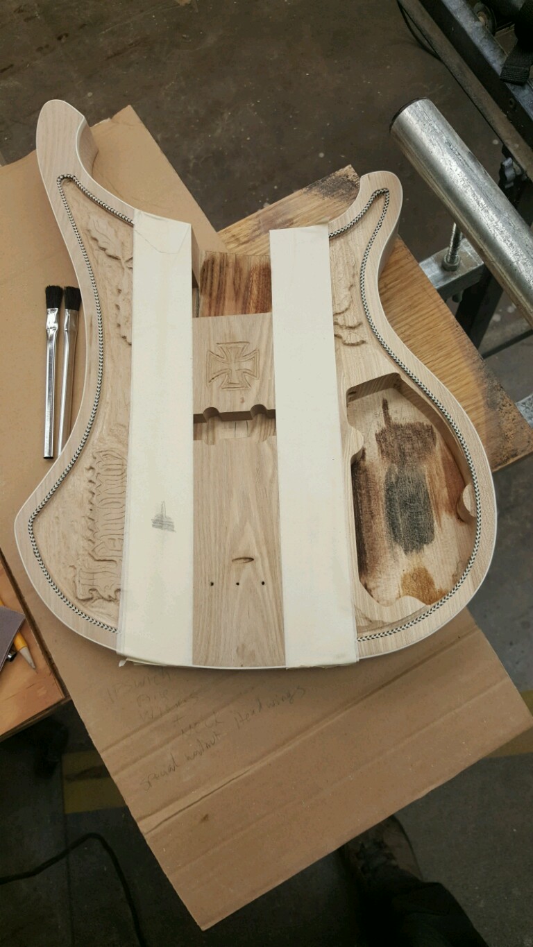

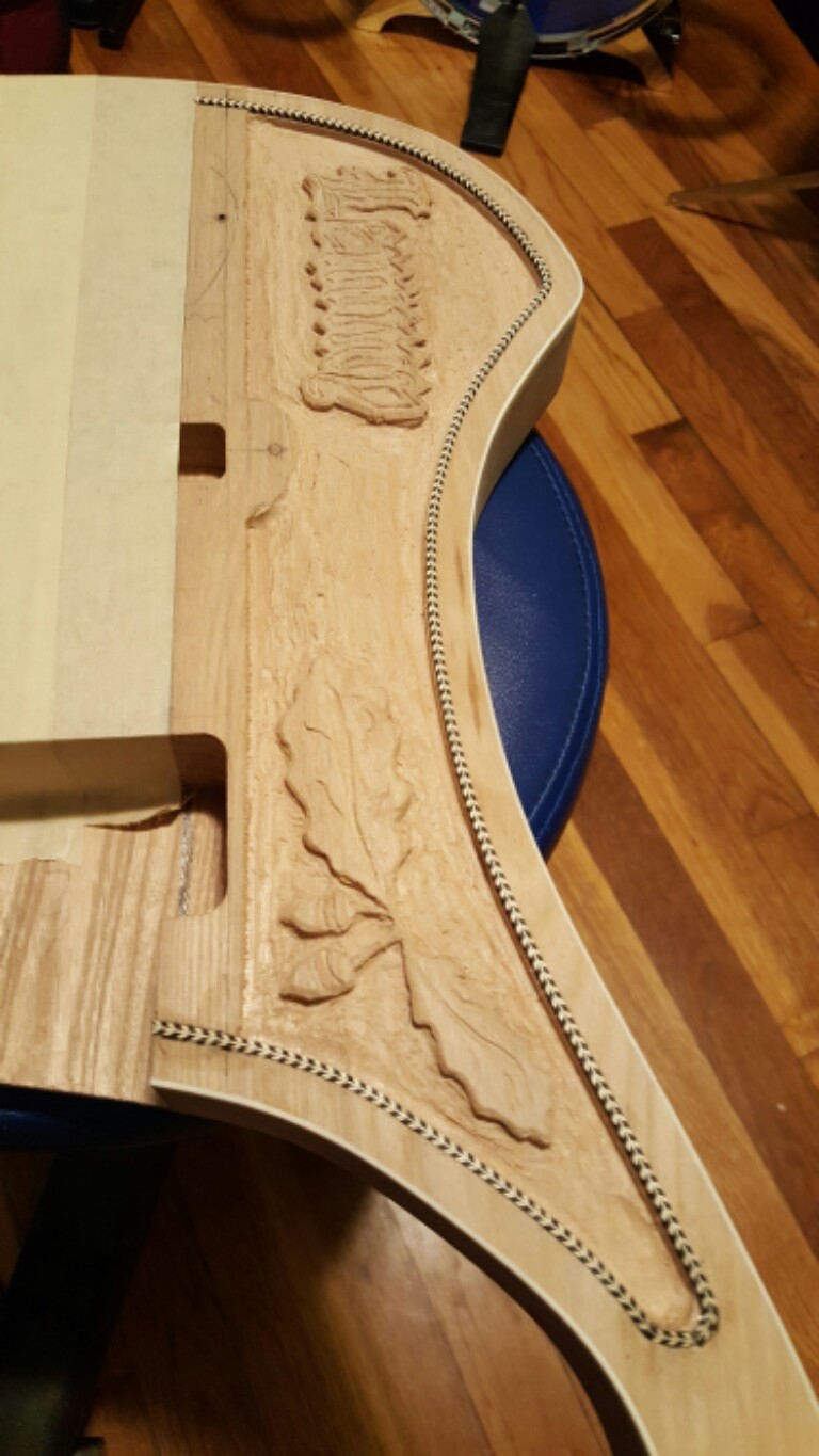

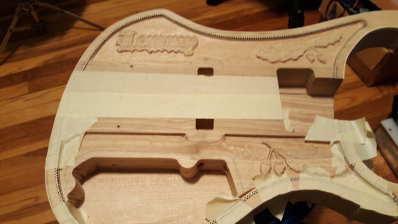

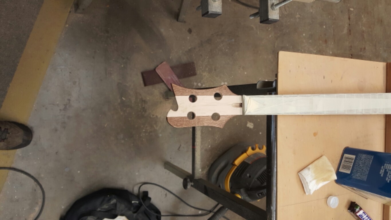

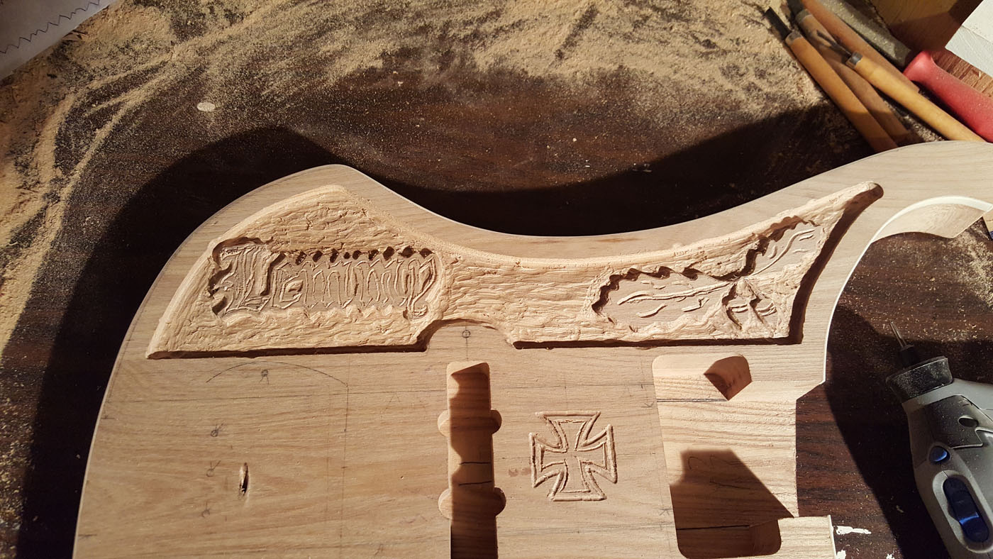

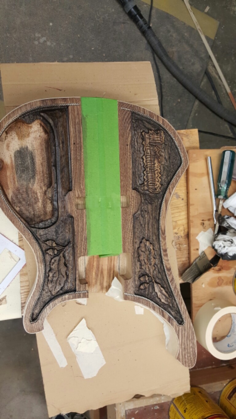

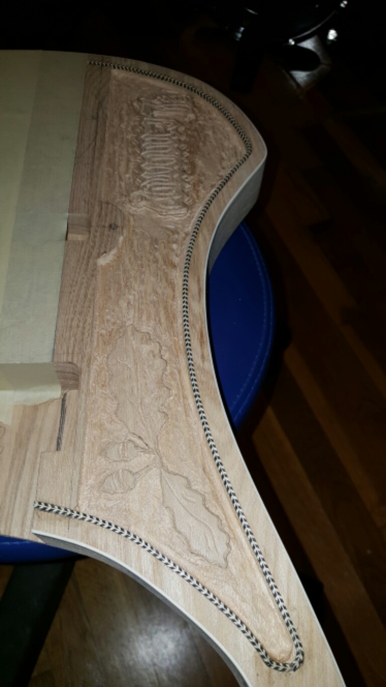

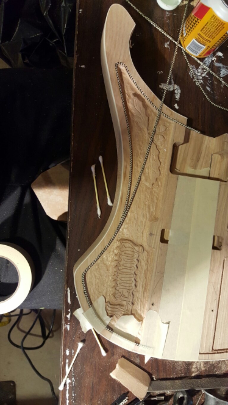

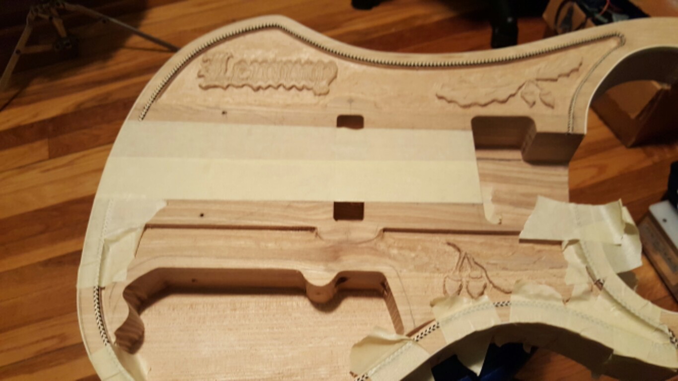

    Hi all... I have been working like crazy on the bass every chance I get. Ive been taking pictures, I just have to resize them to post.. The carvings are done.. I ended up using the black and white binding stuff (which is more like purfling), to fix the chunks I took out of the edges.. Im glad I did. It looks really sharp! I did some stain tests in the cavities and chose my stains. I am leaving the neck natural, with a Behr Tung oil based, wipe on varnish.. Its smooth as heck, and satiny-low /gloss. Sand, sand sand and the front is stained! I had a bit of a setback today.. Im a moron, and assumed that Id be able to scrape any stain off of the binding... the cream was a piece of cake, but not so much with the black and white stuff. I ended up removing it (pain in the a$$!!). In doing that, I put a couple scratches in the field of wood around the edge.. soooo.. sanded the areas back, scratches out, re-stain, move on. I replaced the binding stuff, and made my flush-mount, walnut cavity cover. It started as a 3/4"(19mm) thick board.. thank god I have a thickness planer at work! I got it to about 3-4 mm, and it fits perfectly flush with the top... the pictures will make sense of what I just said..lol. I also made my pickup ring from the same planed piece of walnut... Next, I will move on to the edges, which will be stained black. Ill probably sand the back some more, and then I am creating a new "color" for the back. I will explain that when I post pics! Lol...
    Stay tuned..
    Dave
