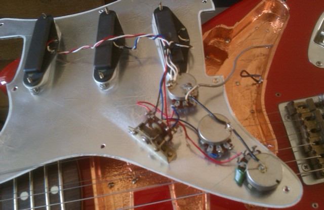

    Garden centres sell adhesive backed copper tape about 1" (25mm) by several metres for under $10. It's slug repellent. You stick it around the rim of your plant pots. I shielded my Strat copy with it. A few solder blobs across the joins because the adhesive may not be conductive, but it takes solder really well.
