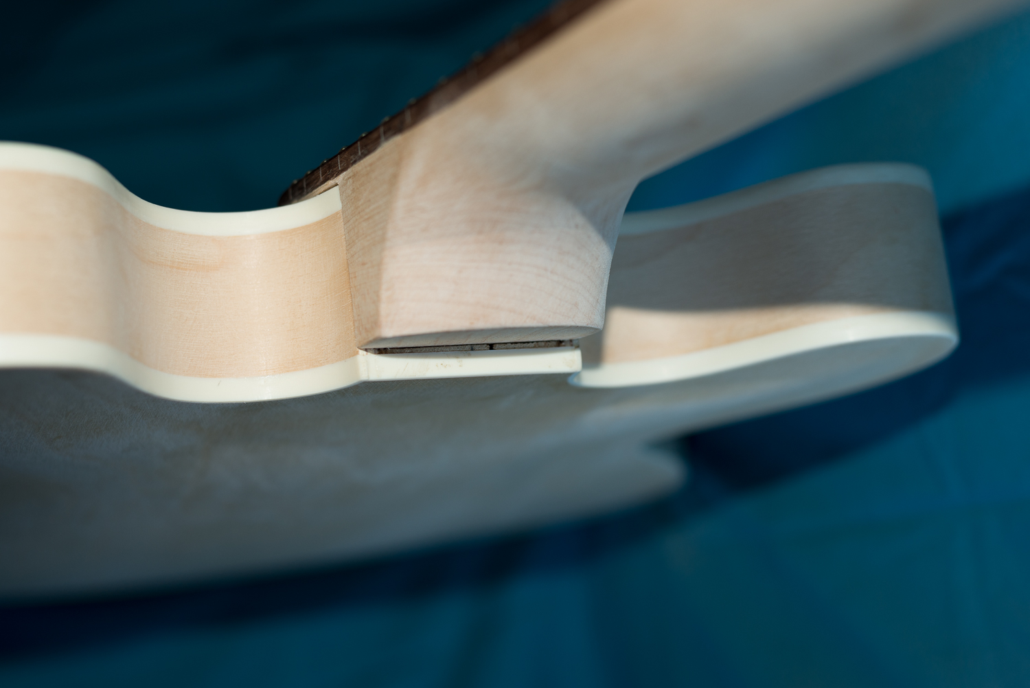

    Speaking of the neck / body joint of this ES-1 kit, it seems I'm suffering the same problem as another forum member currently building their kit, with a cavity/ gap showing between the rear of the neck joint and the rear of the guitars body [see photo]
    Attachment 8506
    NO, I am not going to fill it with anything.... I intend to extend the rear of the neck joint with a small block of suitable wood glued on, I couldn't find maple, but I got a rolling pin that I think is made of Palm wood, which has a very similar grain/colour and density to maple, I'll use that, and shape it so the extension covers the gap, and is flush to the guitars back, so it looks and feels like my Gibson ES
    QUOTE]
    Tweaky, PM Me, I have many small scrap pieces of American Rock Maple from the rework of my EXA-1 Kit.

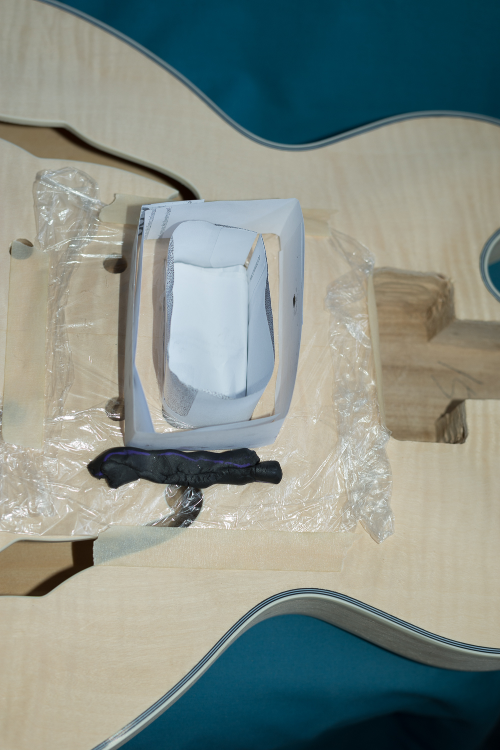

    Well you can certainly make replacements with polymer clay.....How you go abut it is up to you..here's two.
    There are certain specific problems to overcome though, the first is that during the baking process polymer clay goes soft before it hardens, so for thin strips of clay made into a shape of a pickup ring that is shaped specifically for a guitar with a carved top, you would really want some sort of mould of the top of the guitar that you could have the clay rest of while it's baking so it retains it's shape.
    That's possible.....bear with me, this is only a real quick mock up that I made in 10 minutes just to photograph on how I suggest you go about doing this.
    Basically fill the cavity with something to support plastic cut to make a centre well, a Yought or ice cream container plastic cut up will do...use plasticine or putty etc to seal the edges from inside the cavity.
    You want to cover to top of the guitar to protect it from the moulding media, so cover it in cling wrap or alu foil.
    Make a ring around that centre ring using the same material, but at the desired width of the pickup rings you want, again use putty etc to hold it upright, but from the outside.
    Make up some Gypsum /Plaster of Paris and pour it into your mould...you only need it to be about 1 cm deep...let it dry, remove, you now have a mould of the exact area of the top of you guitar....turn the mould upside down, and the curved area is what you use as the template, build your polymer clay pickup ring on that, then bake it the oven.
    The other way is not as involved....you could basically make you ring in parts....rest the moulded clay parts on pieces of cardboard cut to shape, then bake...there is Liquid Polymer clay, you can use this to join different pre baked polymer clay pieces together into one seamless whole...you just brush it on like glue, then bake a second time.
    One last way is to build a small wire frame smaller than the pickup ring and cover that with clay and bake, the wire frame should stop the clay from deforming when baking....but, since the pickup rings are likely to be pretty thin, unless using coat hanger wire, most wire wouldn't be thick enough to hold the weight of the clay in the shape wanted...that's why it's a maybe, maybe not sort of idea for this purpose.
