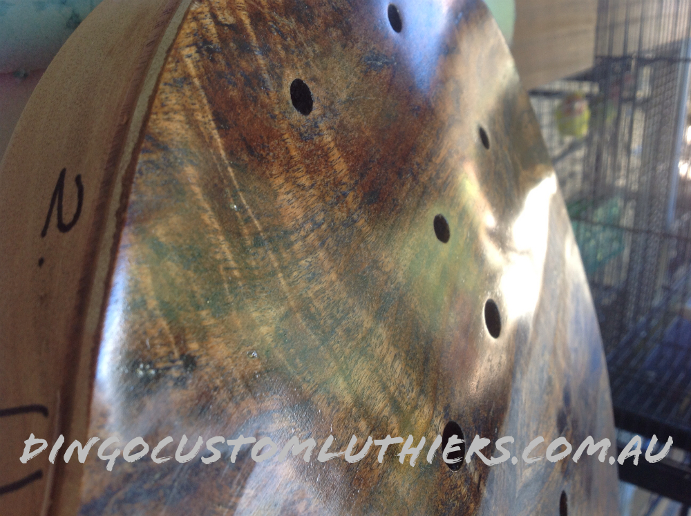

    Sneaky peek at results.
    Three coats of intensifyer coat, I haven't cut this coat back yet but it shows the extra gloss and luster MKII is giving.
    Last coat was applied at 3:30pm yesterday and it is touch dry now.
    Ambient temp 30*C, humidity 35-40%.
    I will leave it now for a few days to allow these coats to cure a bit more before I start on the finish coats.
    (These tests are on a body that was stained with MKI)

    looks great DB, is that a spalty LP body ?
    what is the DT MKI stain colour you used ?

    The stain was an early blue that wasn't lightfast.... But the effect on the Spalt looks ok I guess.
    it's still had a cool effect, deepened some of that grain. That early blue went to grey so it's worked ok
