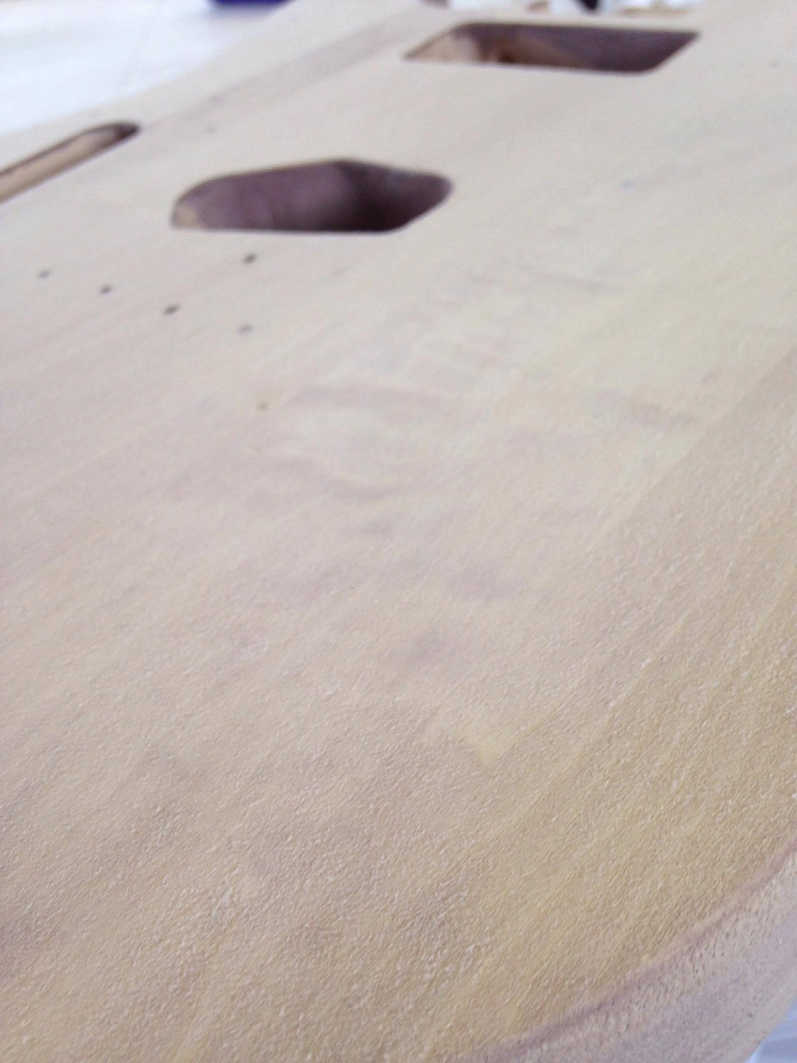

    Yesterday afternoon I used the timbermate on the body of the guitar.
    today I started the sanding. Unfortunately the grain has not taken the timbermate well. and looks really muddy and gross.
    the timber has gone fluffy and im pulling my hair out just trying to get it back the way it looked. what a catastrophe.
    will keep sanding as I really want a natural finished tele, it may end up being solid colour for this one.

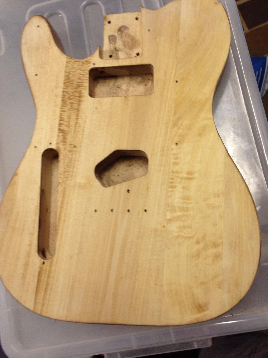

    Another picture of the body.

    The fluff might be from the water mixed with your timber mate, the water will raise the wood fibre and they will need to be sanded

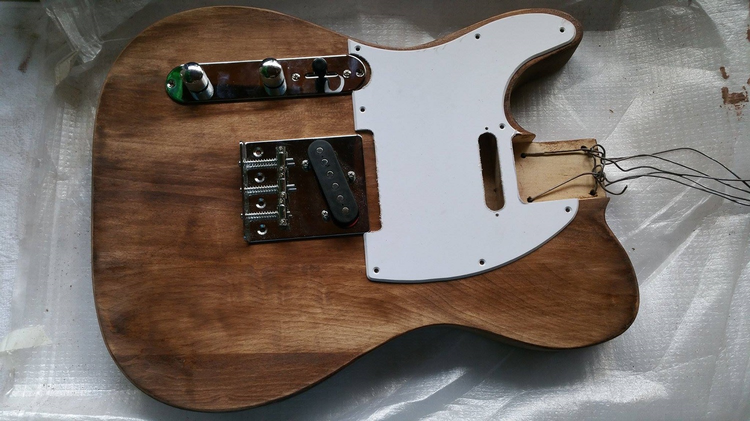

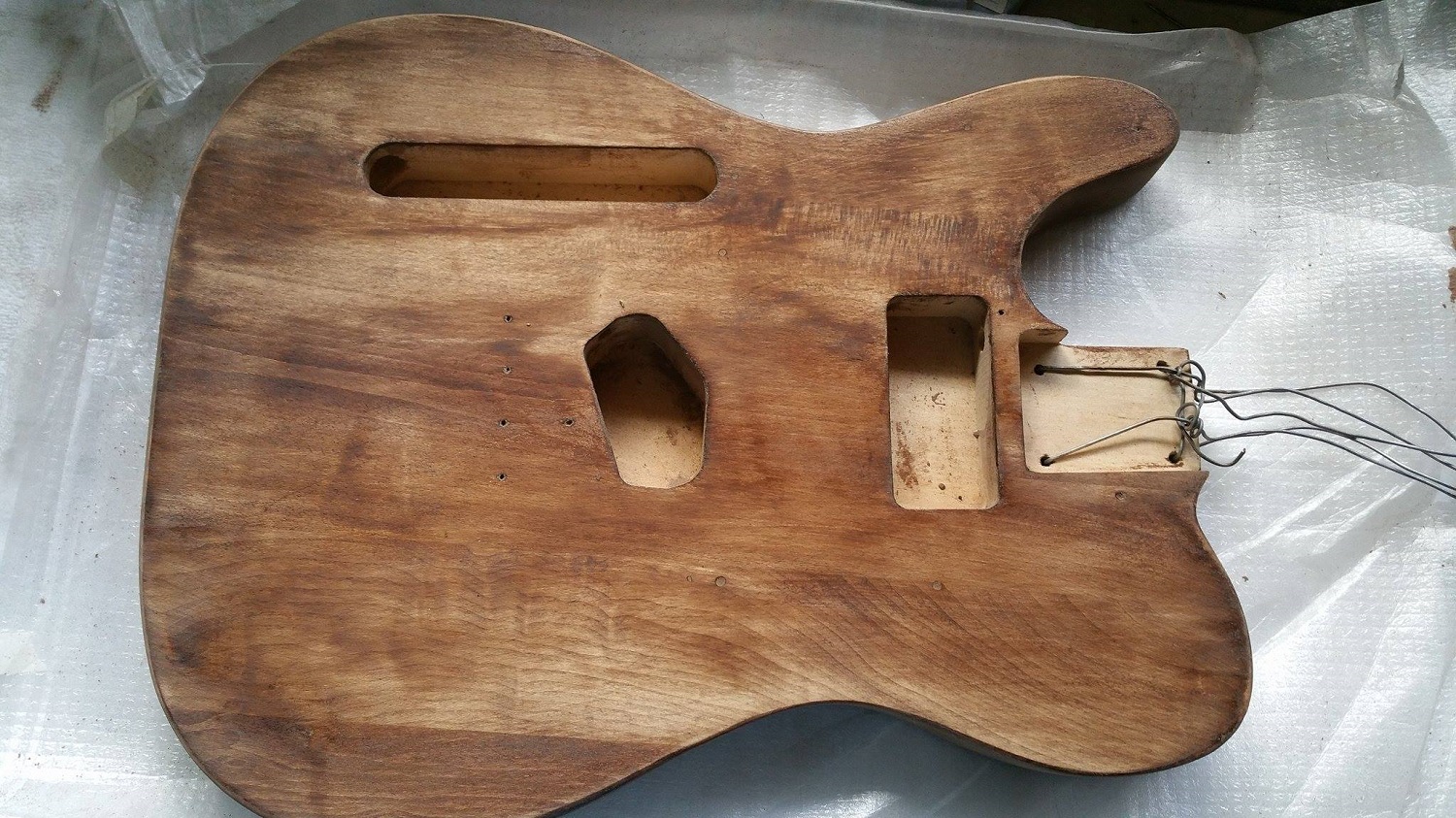

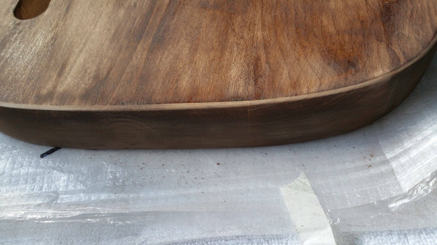

    Hey guys, Been a while Since Ive posted an update on my build.
    After sanding the body back to bare timber, I decided on a different approach. Feast Watson choc walnut stain and varnish. I found it really tacky and hard to spread, and I was a bit heavy handed. but Alas after sanding back the first coat, I was presented with a blotchy, uneven colour that I quite liked. tossed up weather or not I should just put a top coat over it, Then decided another coat would be worth the trouble.
    I also had the idea to sand back the edges of the body to bare timber to give a of a clear ''imitation binding'' effect.
    opinions?
ID:	8354   Click image for larger version.
ID:	8355   Click image for larger version.
