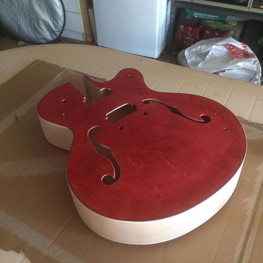

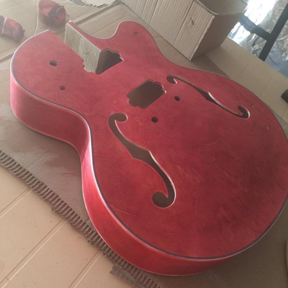

    First Stain have been put on the top and the side. Very happy with the colour so far, but I think I want to get it a little deeper in red.
Name:	Top Body coat.jpg

Name:	Top Body and side coat.jpg

    Now for our new favourite segment, 'What did Daniel learn this week?'
    1. If you use cloth size bigger than the recommended 5cm x 5cm, it absorbs way too much of the stain.
    2. My idea of using the bottom of an old cardboard takeaway coffee cup may not be the best idea aswell, as I'm pretty sure it also absorbs the stain. Yoghurt containers it is.

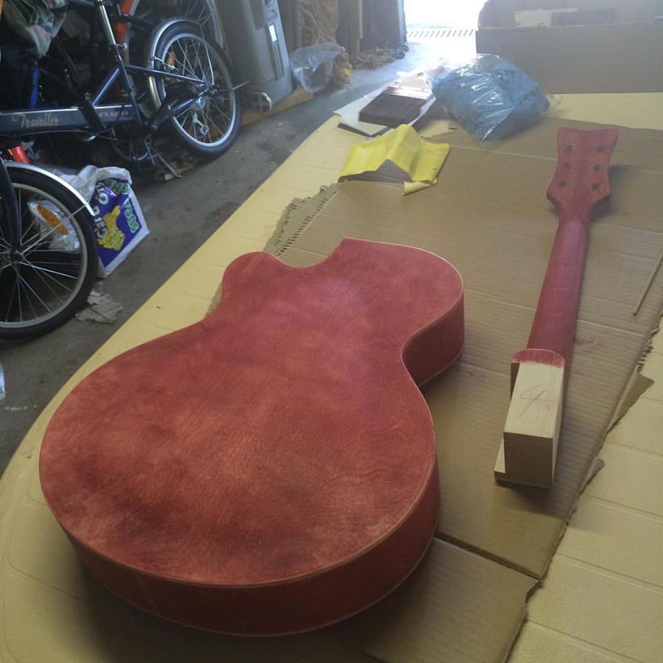

    Bottom and neck now done.
Name:	Back and Neck.jpg

    Will probably leave it for a couple of weeks, and see what the colour does before I think of adding another coat on.

    Now that is what I like to see, someone taking their time with the finish
    I love Karijini red. I would go about 3 - 4 stain coats, if you can stretch it that far. When you use the intensifying coat, it will deepen as well.
    Yeah was going to put on two coats, then see how it looks.
