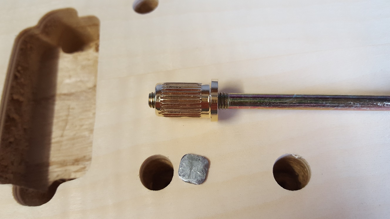

    Regarding the reversed strings, it's my wife's call. She had a Ibanez 12 string 25 years ago strung that way and she loved it. Our son took that guitar to too many gigs and destroyed it. She's longing for that sound again, if she finds it it's a win, if not it's a new nut.
    With the bridge posts ... I figured out I can put a small steel foot in the bottom of each hole, fit the posts to check the neck then use a long bolt as an extractor to remove the post. Straight in and straight out, no lateral pushing and pulling. If when fitting the second and final time I'm not happy with the tightness I can put a smear of glue in but I don't think it will happen. I'm still looking for comment as I haven't committed myself yet.
    Edit ... Now committed, posts fitted.
    Photo shows steel foot to go into hole and long bolt that will extract by pushing against foot and pull post out.
