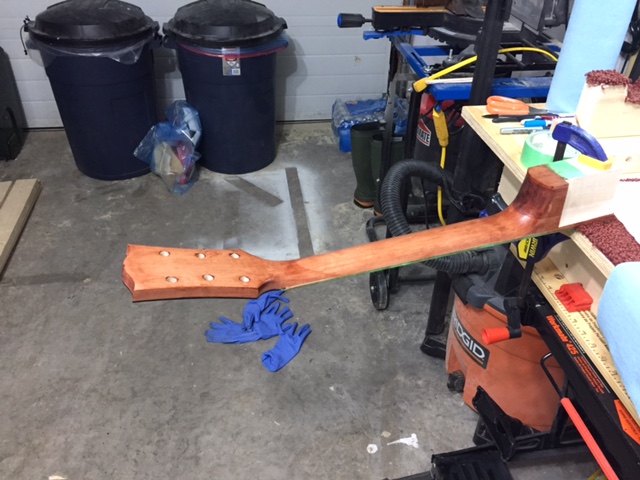

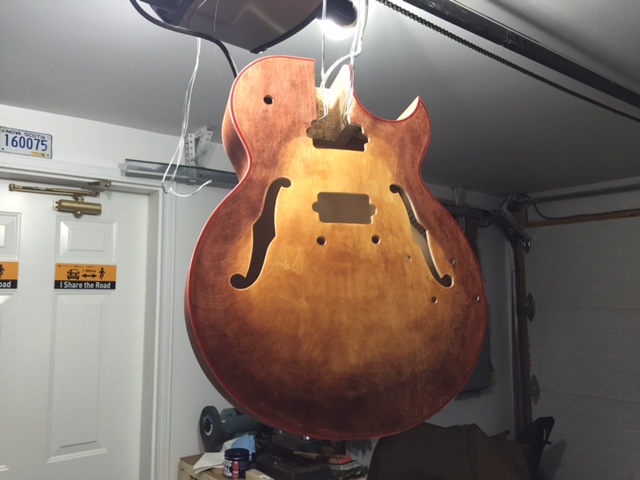

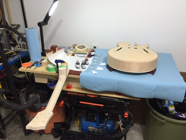

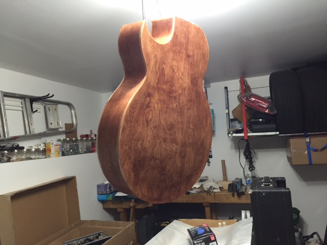

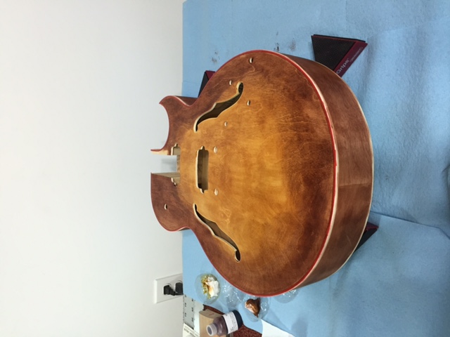

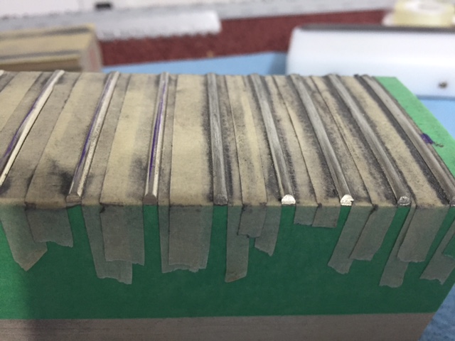

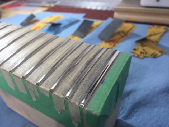

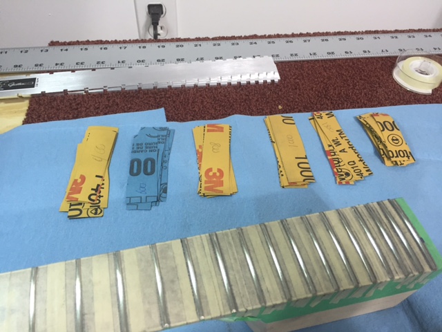

    ES-3 Update 3
    more photos attached because an update just sucks if you can't see what the hell is going on…...
ID:	8459   Click image for larger version.
ID:	8460   Click image for larger version.
ID:	8461   Click image for larger version.
ID:	8462   Click image for larger version.
    ES-3 Update 4
    more photos yet again….
    hope everyone enjoys……
    cheers. I'm going to shovel now.
ID:	8466   Click image for larger version.
ID:	8465   Click image for larger version.
ID:	8464   Click image for larger version.
ID:	8467   Click image for larger version.
    Like the ES build Whale, coming along nicely and keep the photos coming!
    Banned
    Dec 2015
    1,171
    I really like where your going with that finish, nice work keep it coming.
    Great progress pictures. Though I feel the need to go home and carpet my workbench now. I have guitar and workbench envy, wonderful.

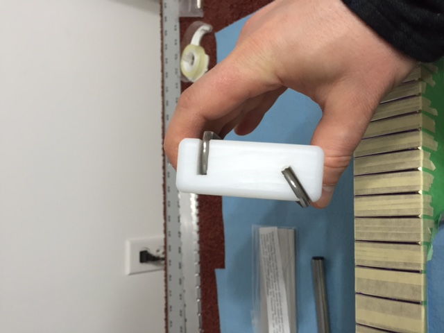

    Oh, BTW what's that white block in your first photo at the top of this page?
    @peterh, I think you'll find that block is a fret dressing block for dressing and angling the edges of the frets.
