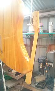

    Just did the 0000 wool great advice, went a little harder than the dingo tone instruction video (which is very helpful) and between the sun thank f$#$ its summer and a good rub not quite so yellow. Gonna go and do the final coat now.

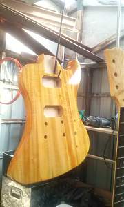

ID:	7976Click image for larger version.
ID:	7977Sorry about that, I forget to take camera out to the shed. The first coat of finish went on well, Give it a week or so and Ill rough it up and do it again.

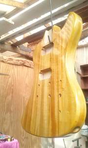

ID:	7978Not the best light to get good photos, the back is more yellow than the front. Didnt spend as much time on it.
  8. #18
    Hard to capture the exact colour in a photo isn't it?
    Looking good and has similar toning to my CG EX-1.

    dtroy, nice colour and has really enhanced the grain. good score too on the basswood as there is a good consistent pattern across the body.
