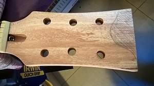

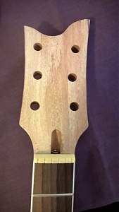

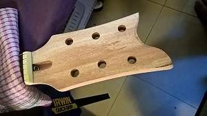

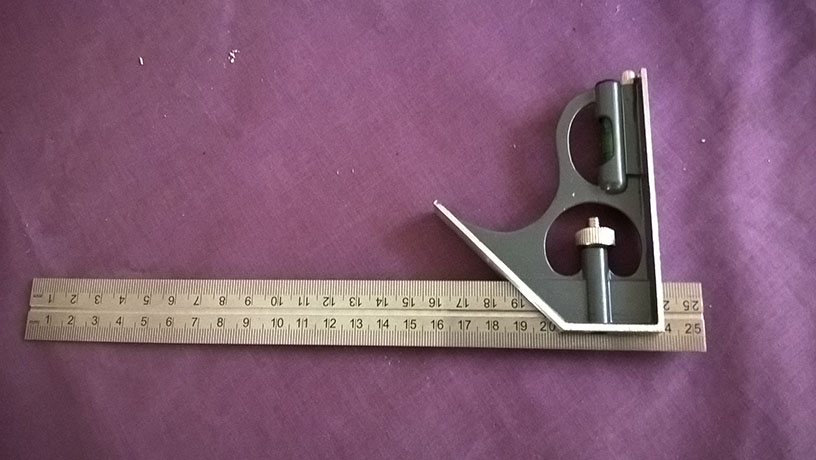

    I shaped the headstock to break up all the sanding. It's just a freehand design, but smoothed out the curves using a cheap set square from the greenish shedish place.
ID:	7319Click image for larger version.
    Cut using a coping saw.
    The cut was pretty clean so it only needed a bit of filing to finish the shape.

    cool headstock shape BH it's original ! I got one of those adjustable set squares and they are very handy for measuring depths of cavities when you start building scratch guitars !

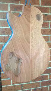

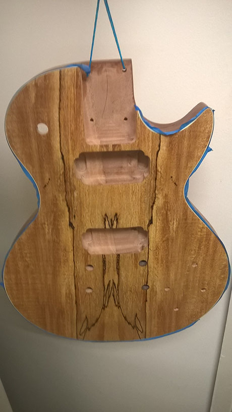

    So much sanding. And just when I thought I'd finished, I noticed I'd managed to take a piece out of the top veneer. So in went the ebony timbermate and now the guitar almost has mirror image scars.
ID:	7542 Click image for larger version.

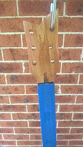

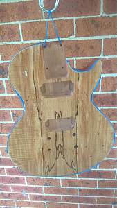

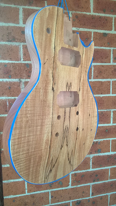

    First coat of stain is on. The natural stain was effortless to apply after doing the burst on my JM-1 kit. Only a couple of small stain repelling spots. I suspect this will be finished before the JM-1.

    That mahogany grain on the back is beautiful!

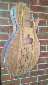

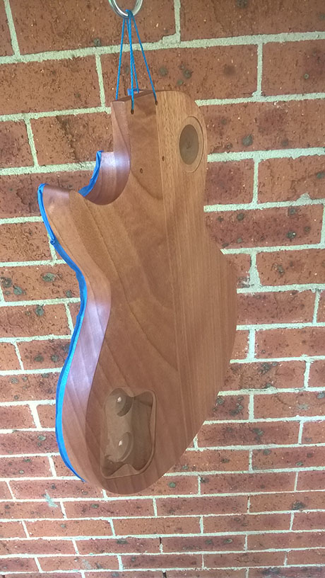

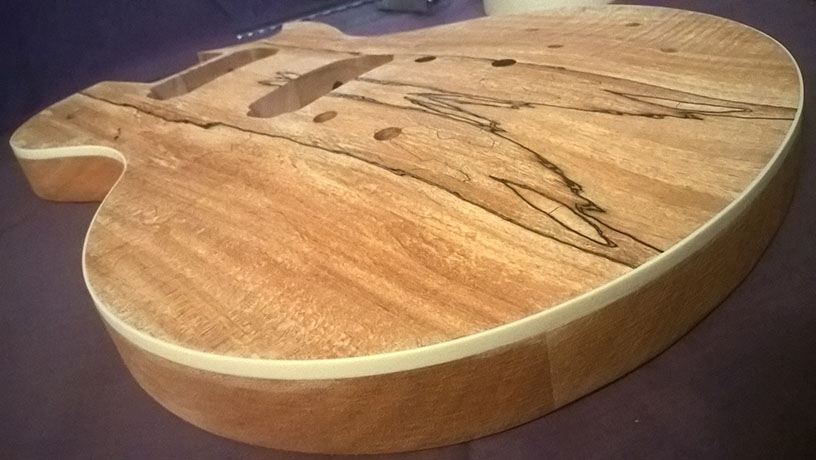

    In contrast to my JM-1 build, this one has been progressing smoothly. Applied the 2nd intensifier coat today. I think I'll start the final coats next week.
ID:	7676 Click image for larger version.

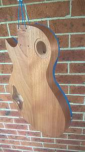

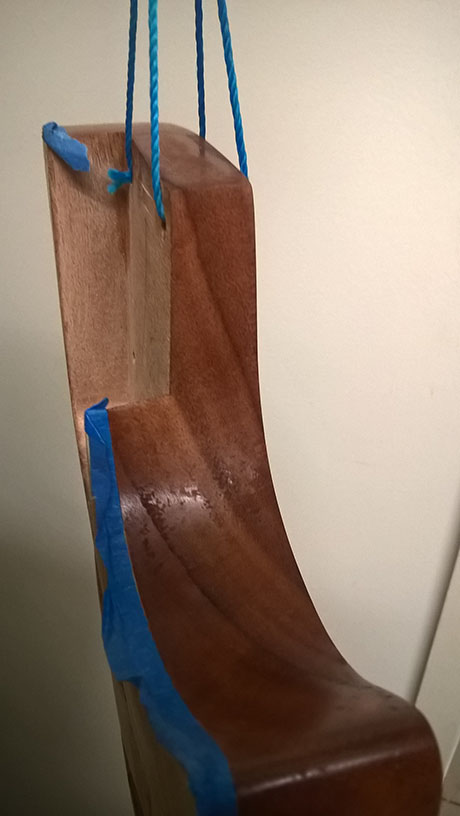

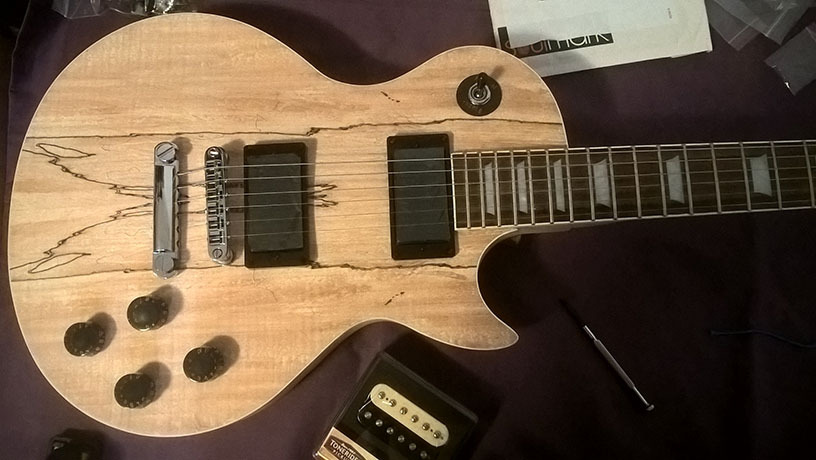

    First application of the final coat:
ID:	7815 Click image for larger version.

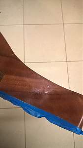

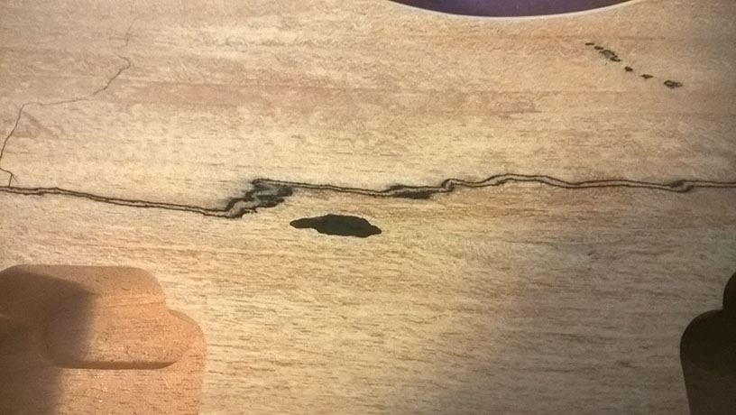

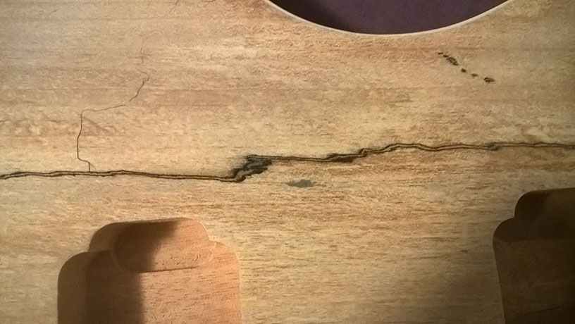

    The colourless finish helps hide imperfections in the finish. It's very hard to see but there is some patchiness in the final coat. I've read about this in other build diaries so was sort of expecting it. The weather has been bad in Sydney and looks to continue so i think it will be a while before I have another go at it.
    The cutaway is where the patchiness is most evident.
ID:	7817 Click image for larger version.

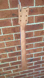

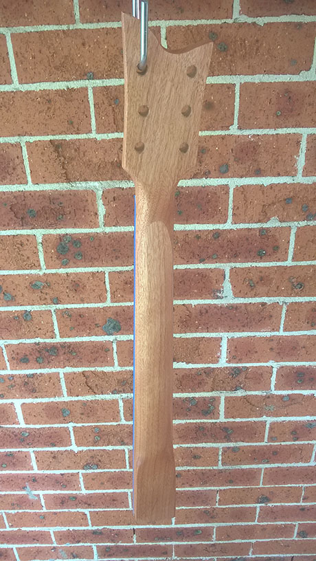

    One thing I noticed - I did the body final coat and neck final coat at the same time and the neck has come out with no issues, in fact I did two necks and they have come out looking and feeling great. If I don't have luck with the body final coat, perhaps I'll try using the neck final coat before I resort to trying.. a certain popular oil product.
  10. #20

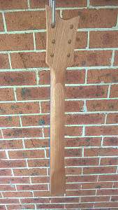

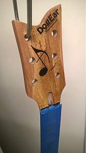

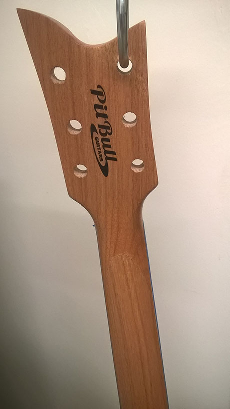

    And this is the neck with first final coat:
ID:	7819 Click image for larger version.
    I was too indecisive to order decals so I bought a cheap laser printer and decal paper so I could experiment and change my mind.
