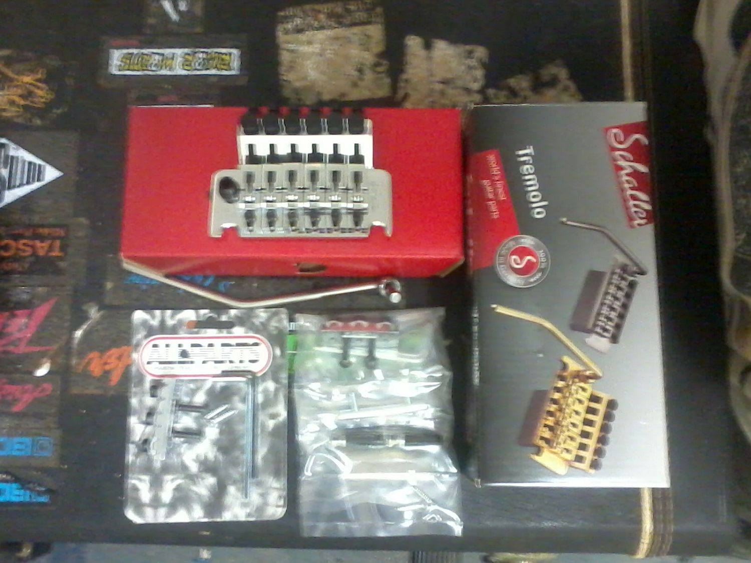

    Update 4:
    It's finally here!!
    I've just gotten back home from picking up the parcel from the Post Office, sure enough it is the new Schaller Lockmeister Floyd Rose Trem Bridge and Schaller R3 Locking Nut, here's a pic of what was in the parcel:Click image for larger version.
Name:	New Trem_resized.jpg
    looks good Doc, now hope it all fits pretty easily
    Nice stash of goodies there Doc. Your ready to hotrod your axe!
    Lol....yep, been toying with changing out the pickups too, but might see how they sound once the new trem has been installed, the new Schaller hardware seems like pretty good quality for the money I paid for it, being a Schaller Trem System it's German-made rather than Korean, which is what the original bridge is, basically a cheaper-made version of an American made Trem System, apparently Schaller made all the original Floyd Rose Trems under License for Floyd Rose, the inventor of the system, so, this Lockmeister Bridge should be as good as the originals.
  6. #16
    Hope so too, I hope my mate is going to be able to install the system for me.
    Seeing that the old Bridge was going to be removed anyway, I decided to remove it and do a quick test fit of the new bridge in it's place, I was a bit concerned about the Bridge Sustain-block hole not being big enough to accommodate the new Bridge Sustain-Block, but it fits fine with enough space to be able to position the new Bridge Accurately,and with the new Bridge in place and sitting flush against the body of the guitar, there's about 2mm clearance between the Sustain Block and where the Spring-Cavity cover would be, it looks like there won't be any real major issues with installing the new Trem, well none that I can see, my mate might have to do a little bit of routing on the body of the guitar under where the new Bridge will go in order to be able to set the 12th Fret action low enough once the guitar has new strings on.
