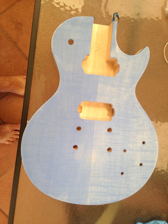

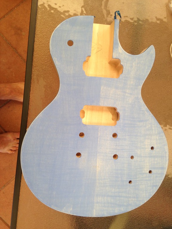

    Finally received the beta trail kit for DB's version of lake placid blue. Sanded the front to 1200 because of the paper thin veneer and applied the first coat.

    I like the left side but not sure about the right side. Are those glue marks on the bottom and right edges. My first time with DT.
    On another issue. I have a TL kit with body painted with nitro. Do have to use nitro clear coat or can I use naughty oil.
    Hi Salo, yes those areas where the stain hasn't taken looks like glue.
    Do you mean can you use tru oil over nitro paint ? Not sure never tried it, but I'd say nitro clear may only be compatible with nitro paint.

    Thanks Wokka. Any suggestions for removing the glue marks. I think you are right with the nitro

    Hi Salo,
    best get a small wire brush (available from the big green shed about $5 - its about the size of a large toothbrush) and carefully brush the glue affected areas. Then a light sand to smooth the cap. Wipe a water dampened cloth over the areas to see if the glue is visible before the next stain coat.
