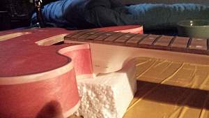

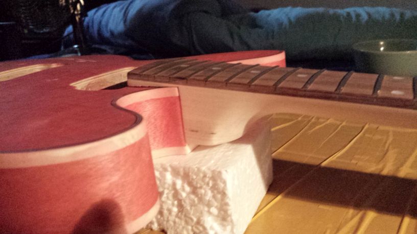

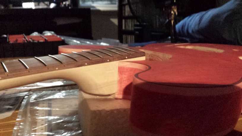

    an update of sorts. checked the neck today, quarter turn on the rod in preparation for checking the frets.
    Also checked the neck fit and alignment. Fit looks pretty good to me, i could probably push it down a bit more to get rid of that gap off the body but i didnt have the energy this evening .
    also the alignment looks good, about 3-4mm of neck outside the first and 12th strings?
    altho i used string to check it (didnt have any cotton). Will check it again once I get the body finished.

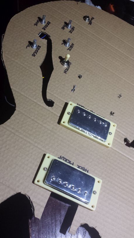

    Also made up a dummy body to set up the wiring, Have decided to go with braided/shielded wire.

    nice one John, don't think I've seen anyone finish a guitar in cardboard bwhahahahahaah
    cool template
    3-4mm of string offset each side should be fine
