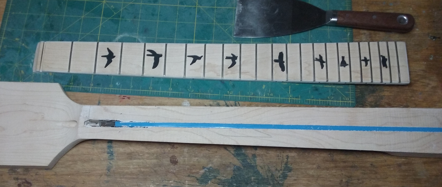

    Member Crusader's Avatar
    Wollongong
    130
    5 mins to remove the fret board...
    now to attach the new one going to be a bit harder ...
