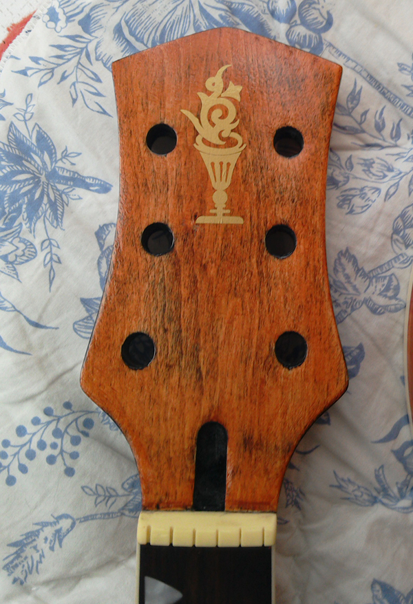

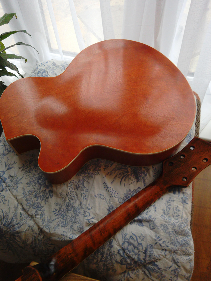

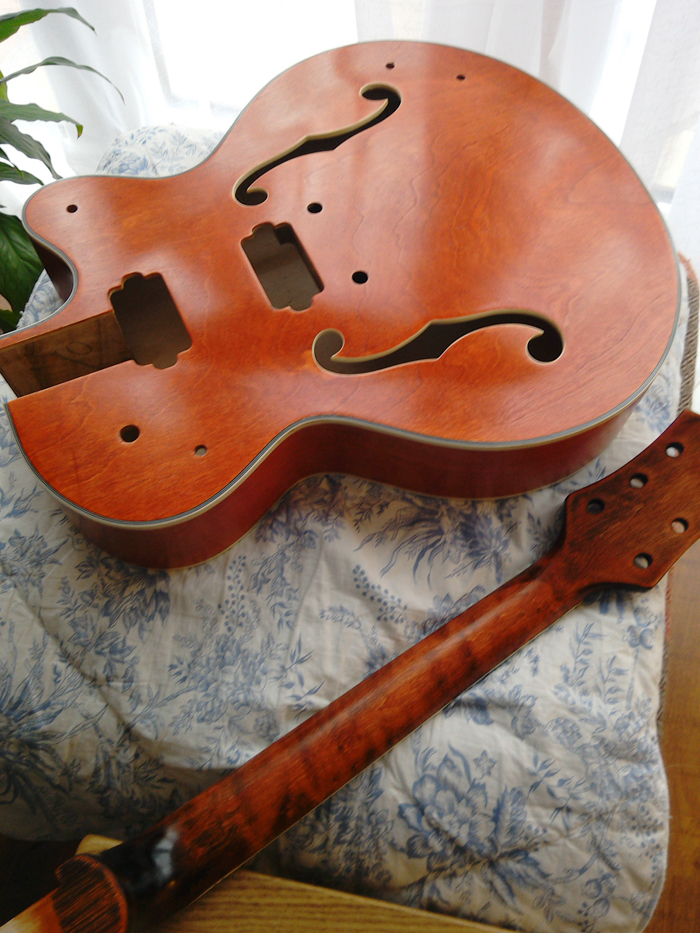

    I sanded the neck down again and then stained with orange. Then came the Tung Oil, eight coats. But I didn't like the sheen it gave so I switched to Tru Oil which gave a better shine. And the effect on the neck was just what I was looking for. Click image for larger version.

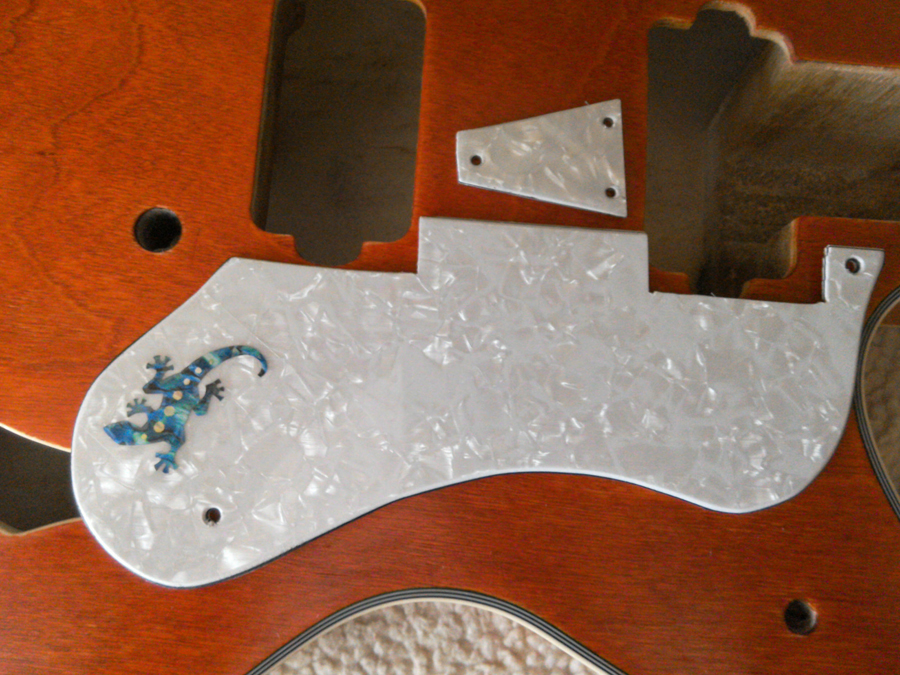

    I didn't like the black scratch guard or truss cover so I purchased some stuff and made my own. Added a decal to the scratch plate and the neck and things are starting to look okay Click image for larger version.

    Yes real problem. Tried sanding but it wouldn't go away. I was afraid of going to far and sanding through the binding and the body. So I'm happy with the way it turned out. The odd blemish gives the vintage look.😊😊
