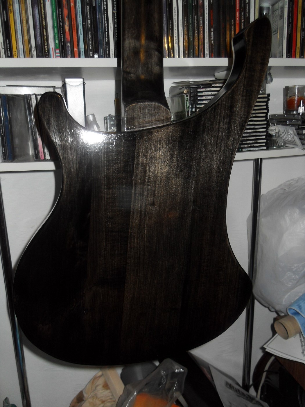

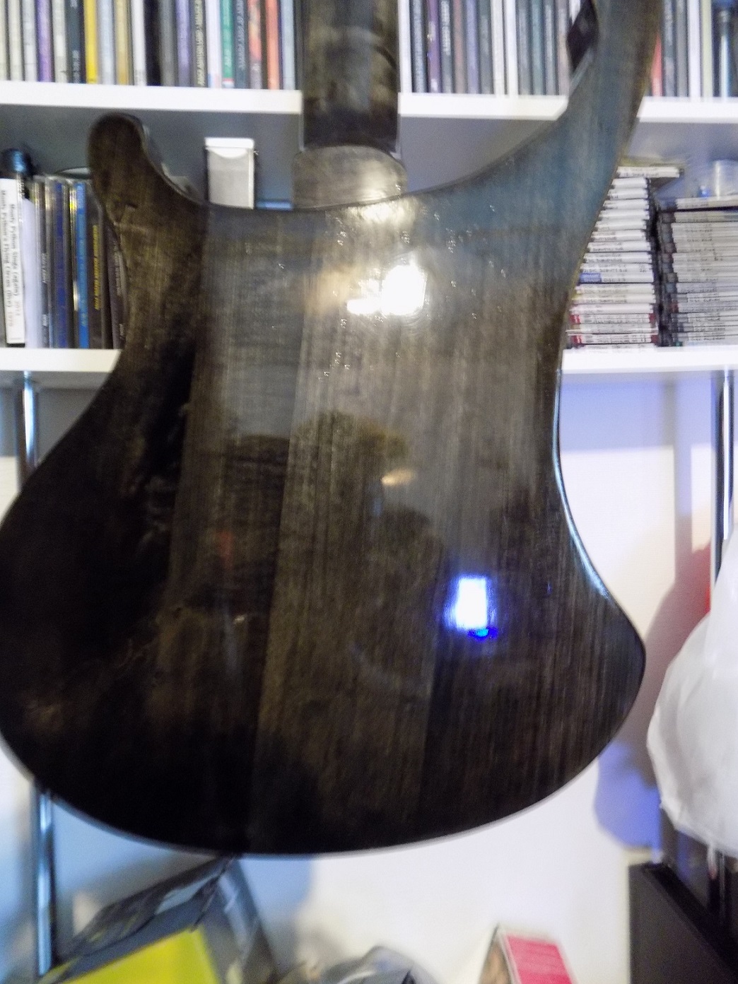

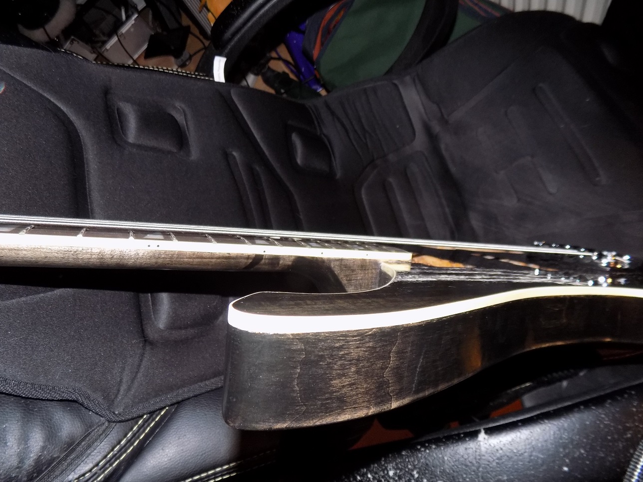

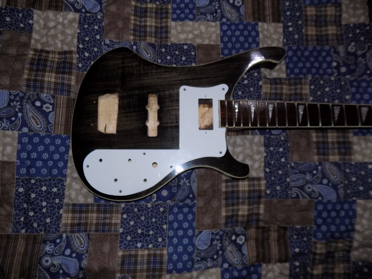

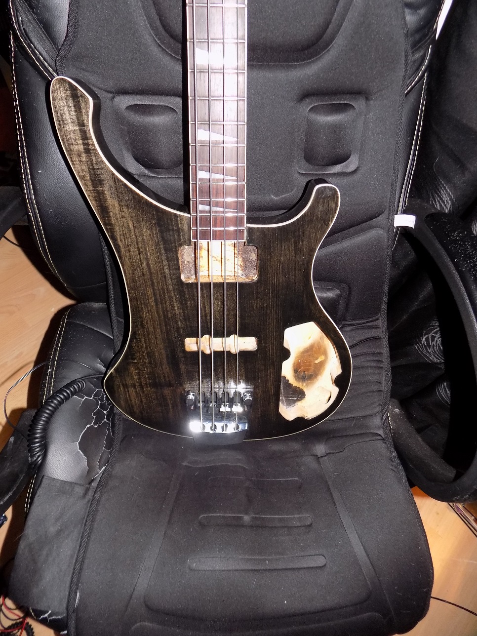

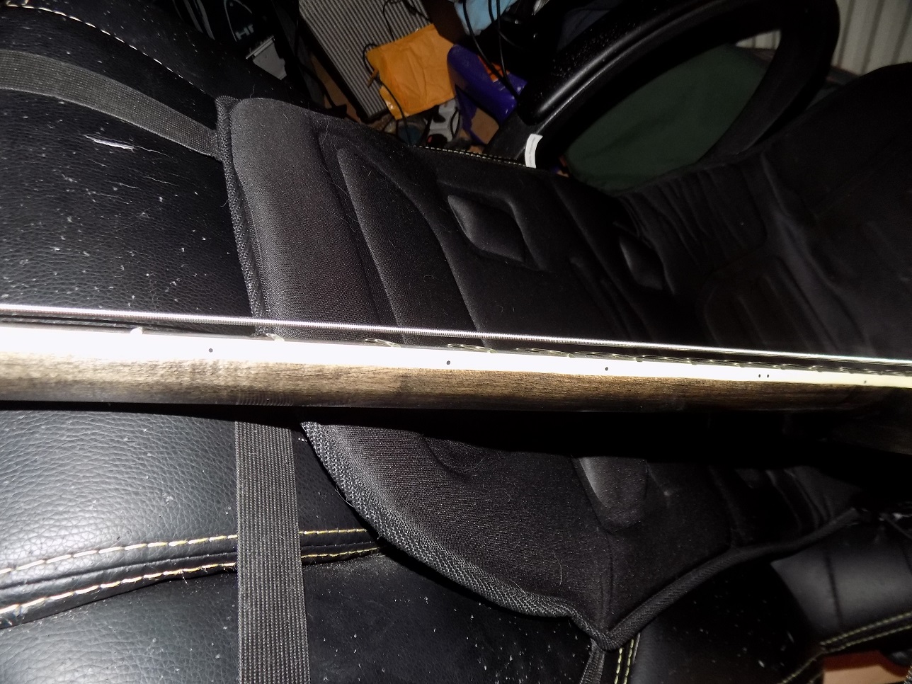

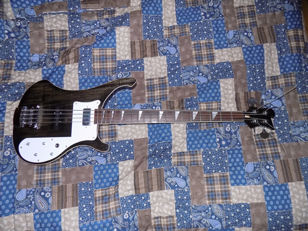

    Greetings all, well spent the time since my last post trying various options with my project and have come to the conclusion i should have stayed with what my heart told me and opted for the natural wood finish, i did try various options of wood dyes but in the end i have opted the all black look, pretty boring i know but the ebony dye covers the imperfections in the timber, it will be a translucent finish so the wood grain will still show through.
Name:	SDC17973 - Copy.JPG
Name:	SDC17974 - Copy.JPG

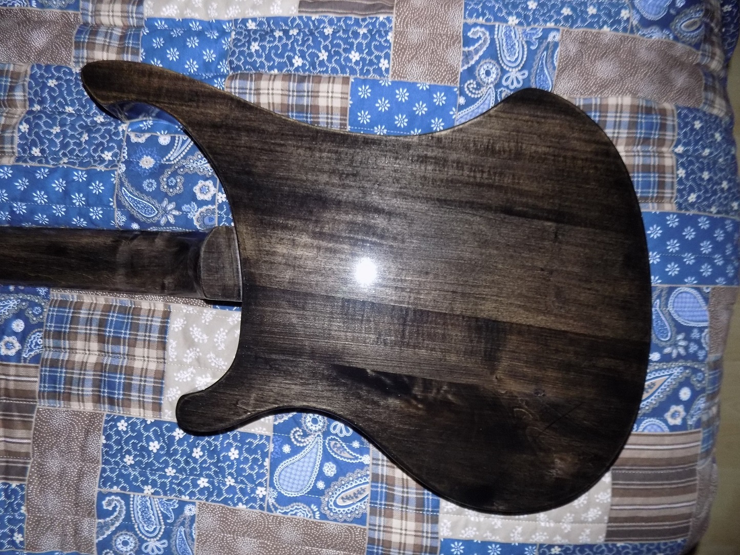

    the two photo have been taken after a base coat of Rustins Dark Oak this highlighted all problem areas so i spent most of yesterday evening rubbing them out before adding coat of Rustins Ebony wood dye, on the photo of the rear of the body are the small knots that don't take dye, there was two of these on the front but i have disguised them, so i will do the same with the back. I will rub down with P1200 and then apply a top coat of final colour before looking to seal it, not sure if i will lacquer or try tru-oil finish.

    Hi Paul
    So far it looks pretty good. Black ain't a bad color for this kit and TO pops the grain like you would not believe.
    If you are trying to mask small imperfections that are not taking color - especially like 1mm wide spots, holes etc you could do this carefully with a black permanent marker. I did that with my black RC-4. At least if your finish will be black enough. The TO will make it a lot darker so the spots will blend in the grain. Just do this carefully cause these can't be easilly undone.
    I think you will be satisfied with the black cause it looks really sexy when finished. Good work so far.

    Cheers Arzi, yeah i'm liking the black the more i look at it, the knot issue i resolve by using a fine craft knife to cut very fine lines across the knot so it acts like wood grain and takes the dye, its worked well on the top.
