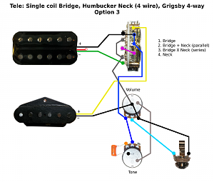

    I'd suggest a Tele 4-way lever switch with a Series/Single Coil/Parallel mini-toggle switch:
    Hi Scott @WeirdBits
    I am assembling a Telecaster with Humbucker at the neck and single coil at the bridge and this type of solution is interesting.
    But if you can I need some clarification:

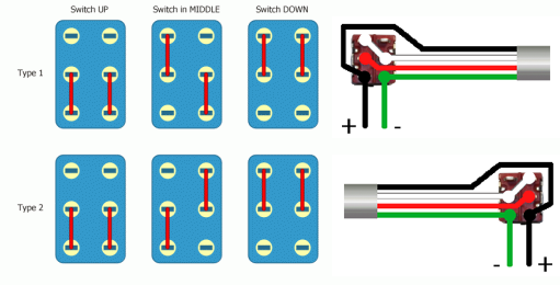

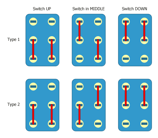

    - there are two types of mini toggle switch on / on / on for the central position
    for which type is the connection right and how would it possibly be for the other?

    The diagram above is for the Type 2 version of the On/On/On mini-switch, as that's the type I usually encounter. If you have a type 1 you just mirror the connections:
Name:	Series_Single_Para mini-switch types.png

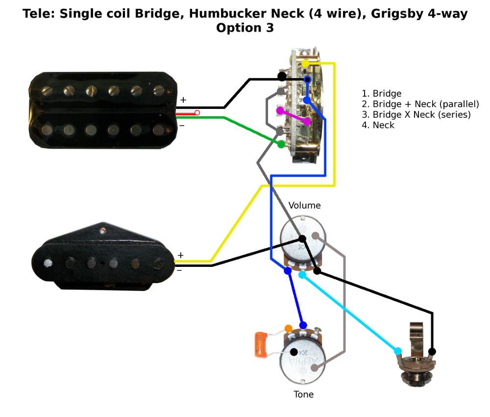

    You then just connect it as: neck pickup -> mini-toggle -> 4-way lever switch.
    The way the 4-way layout works is that the neck pickup's + (hot) is permanently connected to the output of the lever switch and the neck - is only connected in positions 2,3 and 4. This leaves the neck - 'dangling' unconnected in position 1 (bridge pickup only selected) and can potentially act as an antenna to introduce noise, depending on a lot of things. The 'extra jumper' on the 4-way lever switch in the linked thread is intended to reduce this by shorting the neck pickup's + and - together (as a closed loop) on the lever switch's output when in position 1. On a well shielded guitar with the neck humbucker screen/shield (bare wire) connected to ground the effect of the additional jumper may be minimal, but some people prefer to add it.
    To include the extra jumper on my layout you can simply add another solder point to connect the first lug on the left bank/pole of the lever switch to its output.
    Any other questions?

  7. #16
    Correct. The mini-toggle controls how the neck humbucker is configured (series coils, parallel coils or split to a single coil), and the 4-way lever switch controls which pickup or pickups are selected and how they are combined.
    I should mention that the wiring diagram above doesn’t show the bridge plate ground wire, but you should always connect one. That is, a bare wire that sits under the bridge base plate and runs through a hole in the body to the control cavity (or pickup cavity) where it connects to a ground point (usually the back of a pot). A standard Tele kit should have the hole pre-drilled, so all you have to do is remember to add the wire before you screw down the bridge.
