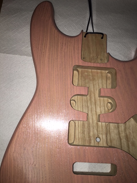

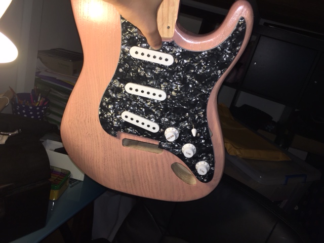

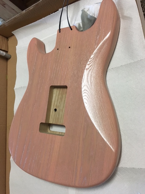

    Quick update, I've put on the final coat and the highlights.
    Need to do a couple of tops coats to finish it off but I am pretty happy with how it's looking.
    Looking forward to setting it all up, I am sure I'll have a ton of questions when I get to that stage!

    coming along nicely Candice the colour is getting deeper.
    With a custom headstock logo you can buy waterslide decal paper on ebay and print your own logo. Remember to put a clear coat over the logo before you soak it in water.
    I generally put more clear coats over the logo once its been put on to protect it.
    Another option is email Andyport from the forum has a sign business and can make you a nice vinyl logo so you don't see the clear backing paper. His email is citysigns at internode.on.net
