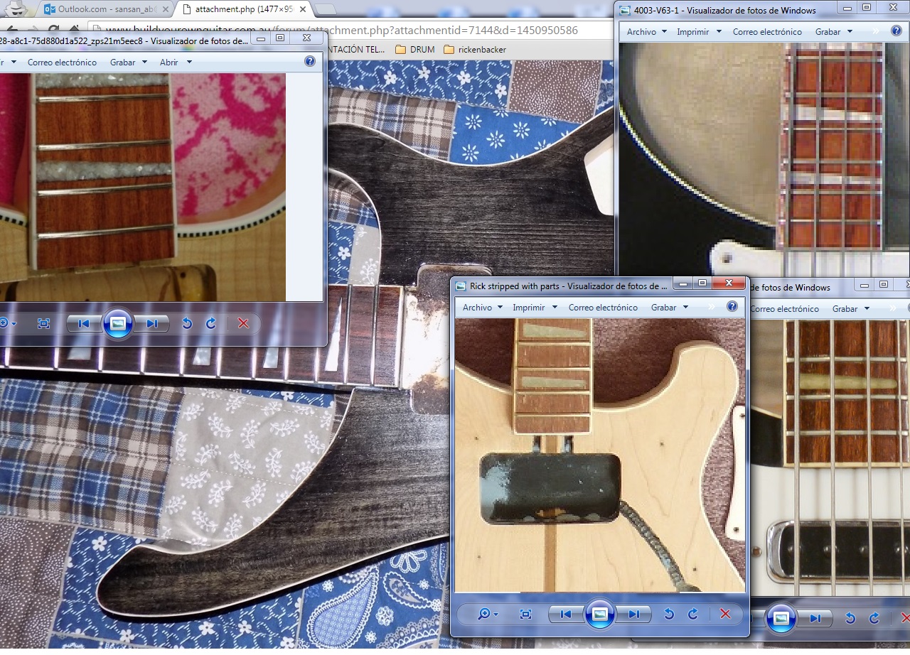

    Let me show you the differents types of neck setting i've been find online. Taking reference a real RC-4 below from Paul, if you please and let me use as example of course..) and then real Ricks around.
Name:	neck tests.jpg
    Depending the type of bridge you want to install, scale measure, use or not the stock pickguard, and the feel you want to achieve (the more you pushed down to the bridge, the more stability unless you glue some reinforcement around the tenon) I personally like it a little pushed up to the headstock but always keep the eye between 20 fret and 21.

    Thanks very much for the replies and insight. Good to see that 1) this is the case with other kits and not a defect in mine and 2) there are options based on personal preference and feel as long as the bridge is positioned correctly (thanks for the fret position calculator tip, I had no idea).
    Sansa, i think i'll push it up a bit and not go all the way and then see about reinforcements. I have a long way before i get there anyway, as my kit was back in its packaging due to moving house and not having space for it. Now that i am settled i'm hopping to get into it this weekend.

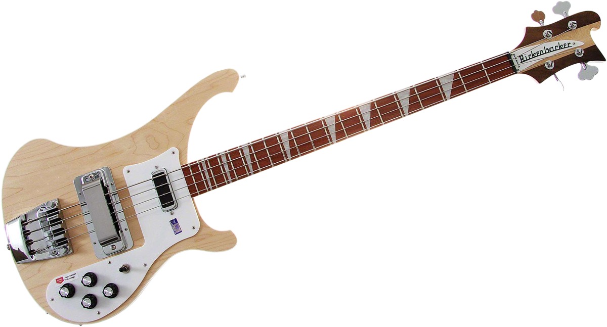

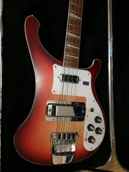

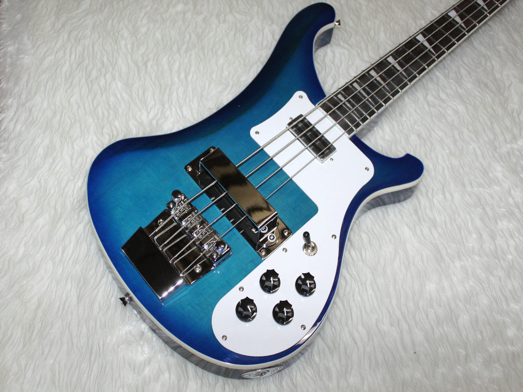

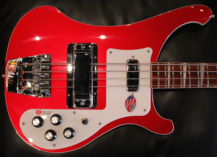

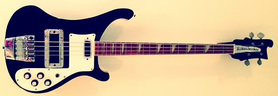

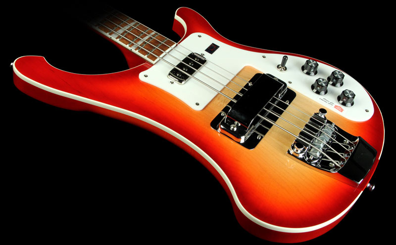

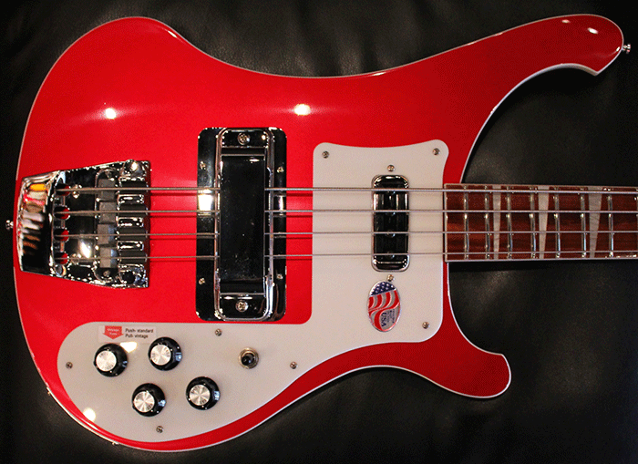

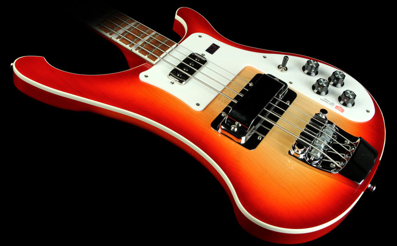

    From Sansan's pics the only authentic Ric is the Jetglo in the bottom right corner. Suggest searching for more images and it doesn't take long to pick the real deal from all the fakes. Here are some more photos to look at.

    The Blue burst is a fake as the fretboard is too dark, the pickup cover too square, and neck pickup looks nothing like it should, bridge is all wrong, mono output socket, and if you look harder you will find many other indicators too.

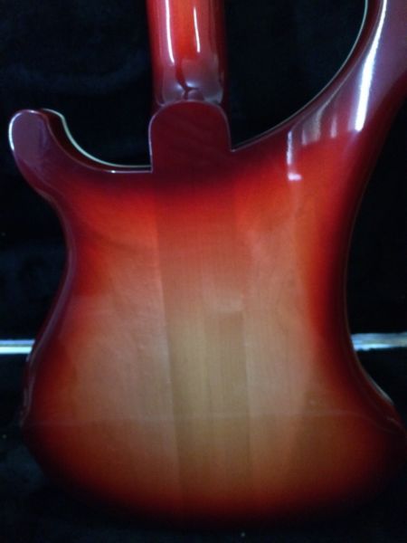

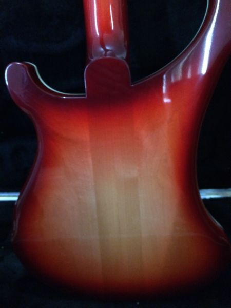

    Ric's have a neck that runs the full length of the body with wings glued on. This is easiest to see when looking at the back of a mapleglo version or this fireglo.

    That being said, most examples do seem to have some variation in where the frets line up with the body and best to measure nut to 12th fret and then same to bridge should be the same length. Official Ric website has scale at 84.5cm or 33.25" whereas Fender P & J long scale is 34".
    Probably more important to get the scale length right rather than how the frets line up with the body otherwise it will be a nightmare to intonate and higher notes will be out of tune.
