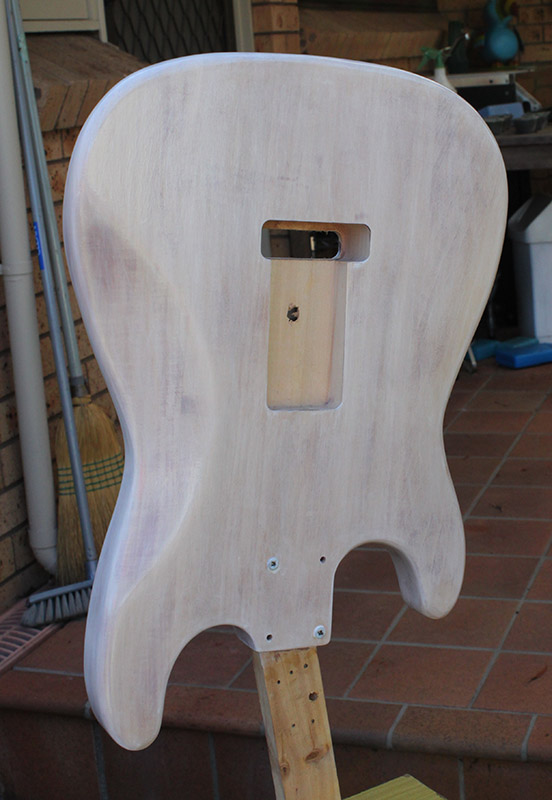

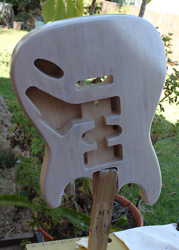

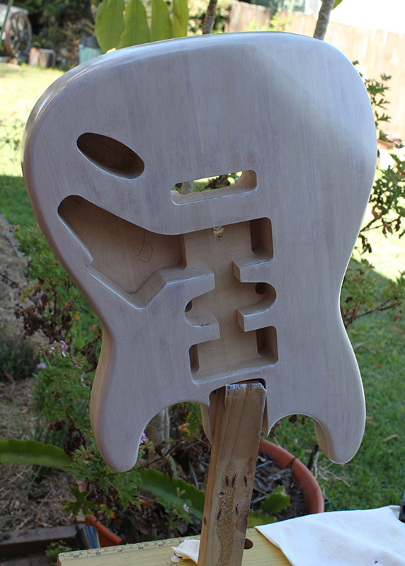

    Update.
    After 20(ish -lost count) hand rubbed coats of the lime wash, I've knocked it back with some 400 grit.
    So far I've put 5 thin coats of clear. I'll again knock it back and add a few more coats. I need enough depth to do a cut and polish.
    Logo is on the headstock - after the pizzling I copped on my last build for not having a logo!
    And the body:
Name:	Rear 5 Coats Clear.jpg
ID:	6268Click image for larger version.
Name:	Front 5 Coats Clear.jpg

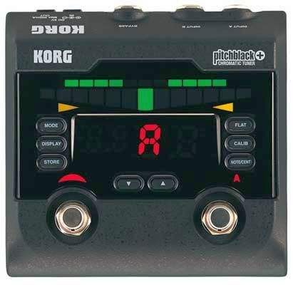

    5,516
    Quote Originally Posted by Rabbitz View Post
    Hi Doc,
    Another guitar showed the same symptoms and a different tuner picked up the sound. So I am pretty sure it is the tuner.
    When I get a chance I'll pull the tuner apart and have a squint. It is 30 or more years old so it might just have had enough
    (Maybe I should ask Santa for a new tuner?)
    If it is 30 years old I'd guess that some of the Electrolytic Capacitors on the circuit board might have dried out, if it's an analog tuner, sometimes the input socket on the tuner develops cracked solder joints where it solders to the circuit board too.
    The tuner I use to tune my guitars is a Korg Pitchblack +, and it works pretty good, the great thing about it is it has two inputs that you can set up with different tunings, so you could set up input A for standard guitar tuning (E to E), and then set up input B for tuning a Bass guitar or maybe an open tuning, it has a few different tuning modes including Strobe-Tuning which is very accurate (the manual quotes an accuracy of +/- 1 Cent in Strobe tuning modes).
    It looks like this one except mine is Red in colour:Click image for larger version.
