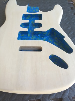

    Body Prep
    Body was in pretty good nick at the start....

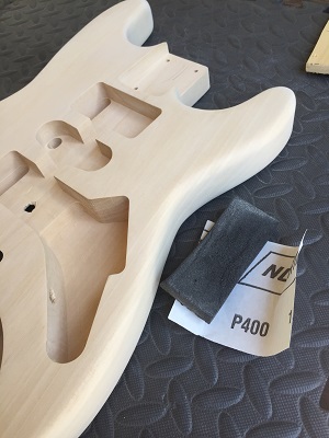

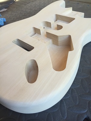

    a Friday night and Saturday of sanding at least 2 of each...180, 220, 240, 320, 400 & 0000 steel wool

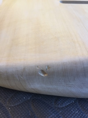

    (**the sound of basswood hitting the pavement**) uh oh! a combination of me placing the sealed body balanced precariously and within reach of a 1 year old and 3 year old and a 1 year old and 3 year old being themselves!!!
    pic is of one of four dings......oh well...nothing that more sanding and filler cant fix

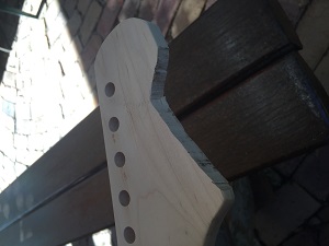

    Neck Preparation and Headstock Cut

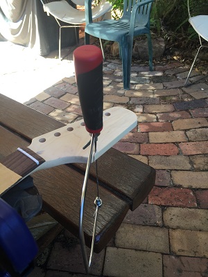

    Ok so, I haven't done much woodworking since yer 10 and i'm pretty sure I went backwards since then. Don't let this man near a saw!

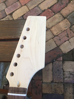

    drew the head stock cut the way Adam shows in the video, tried to cut it...ended up like this....
ID:	5956Click image for larger version.
ID:	5957Name:  IMG_5728.JPG
    oh well nothing that sanding for a long time wont fix

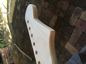

    ta daa
    ...followed by more sanding and smoothing of the neck.
    I'm not totally satisfied yet will revisit on another day.....

    That headstock looks fine, don't be too hard on yourself. What's your plan re the dings?
  6. #16
    headstock looks good Andy, good effort !
    bummer about the body hitting the pavement, basswood is pretty soft. Try and iron and wet cloth you may lessen the size of the dents
  7. Liked by: Andy40
  8. #17
    I used timber mate filler and lightly sanded those parts back starting at 240, then 320 then 400 again. Then resealed. It came out ok.
