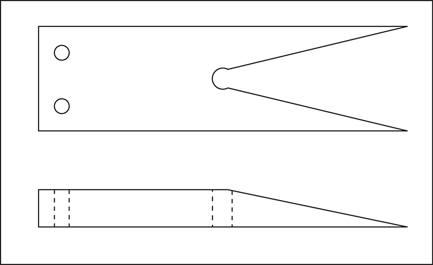

    For the "birds beak" I also like to drill a 15 or 20mm hole at the apex of the cut. This gives you so wiggle room to work the saw.
    I also taper it from the edge of the hole down to the front edge, the taper is the full width of the block and the angled side (chamfer?) is on top. This allows you to work braced at different points with different thicknesses of jobs and awkward shaped jobs. It is especially helpful when filing and shaping an object.
    I used to do this as well (around 10mm worked best) but found that with my thin long sections of my logo's the hole at the apex didn't offer enough support to the MOP or Paua causing it to break while cutting on the downstroke so I dispensed with the hole. I'll post a pic of the Birds Beak you mention for this who would like the option.
    Quote Originally Posted by Rabbitz View Post
    Would love a pic to help understand what you are explaining here. Sounds like a good modification.

    Hi Gav (et al),
    Here is the Jewellers Beak I was trying to describe:
    I used to use it for metal work (jewellery etc) and these are as brittle as MoP and Paua shell, so the hole may present issues. The taper in the V allows you to brace when filing and shaping - for the shells it will help with support as well.
