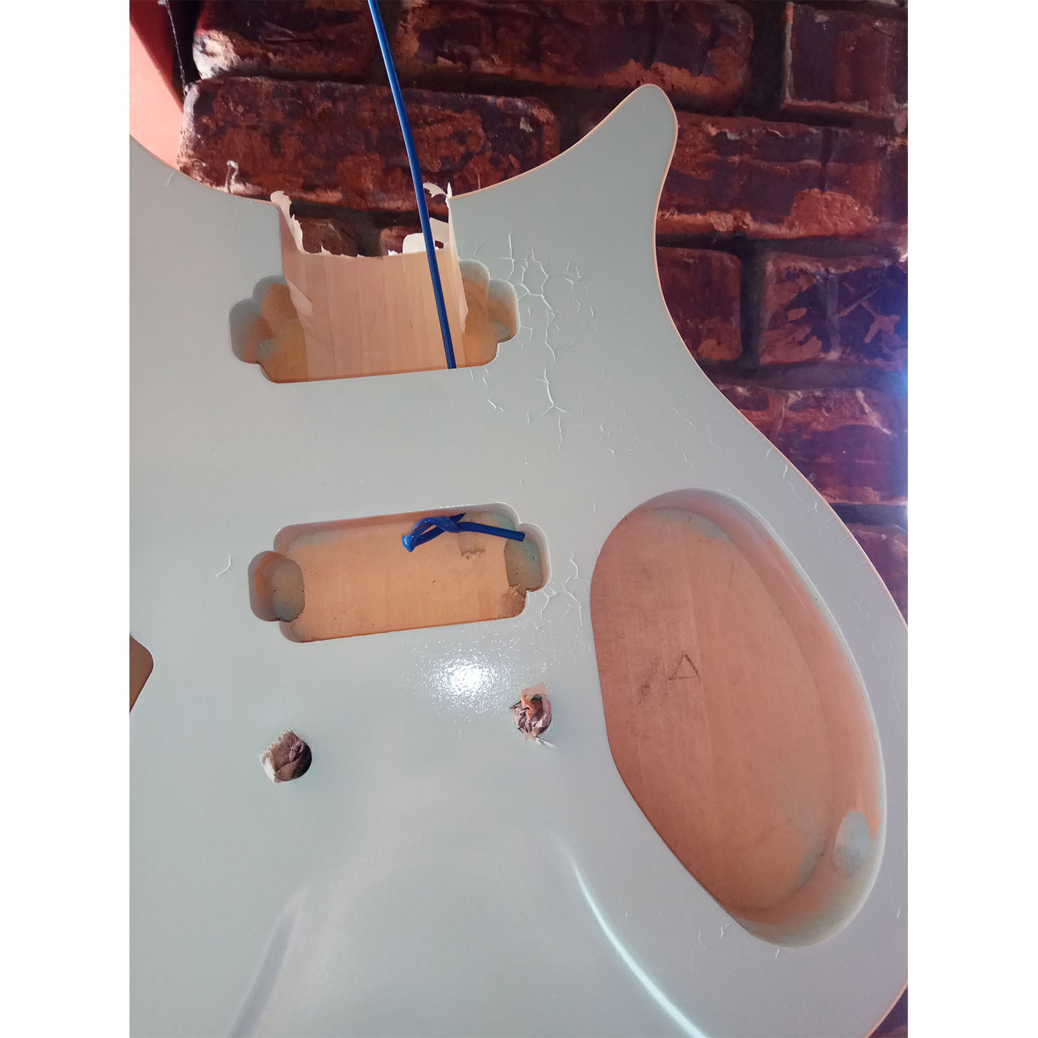

    Whoops. What kind of paint are you using? Is the clear from the same manufacturer?
    Yeah it's the rustoleum 2x stuff, paint and clear. I guess it's just the curse of the rattlecan- sometimes you do everything right and the luck of the draw still stuffs it up.
    Colour has been on for about a week, wet sanded it to 400 and let it dry completely. Sprayed a light first coat of clear, and another later on. I walked away and I'll go back in a minute to see whether a miracle has happened and it looks ok, but i very much doubt it.
    Just went to check it after half an hour and this is what I found:

    Frustrating but interestingly some of the bits that were initially the worst have settled down and fixed themselves, so maybe it'll all just shrink and look ok.
    I should have known better than to trust the rattle cans, but often when you go for quick and easy it ends up being the opposite. I even had a thermometer out there to make sure i was spraying at the right temperatures, and I did a test panel, which came up perfectly
    So the options are to wait and hope that it somehow miraculously fixes itself, sand and refinish, or tell people I was going for a "custom crackle finish".

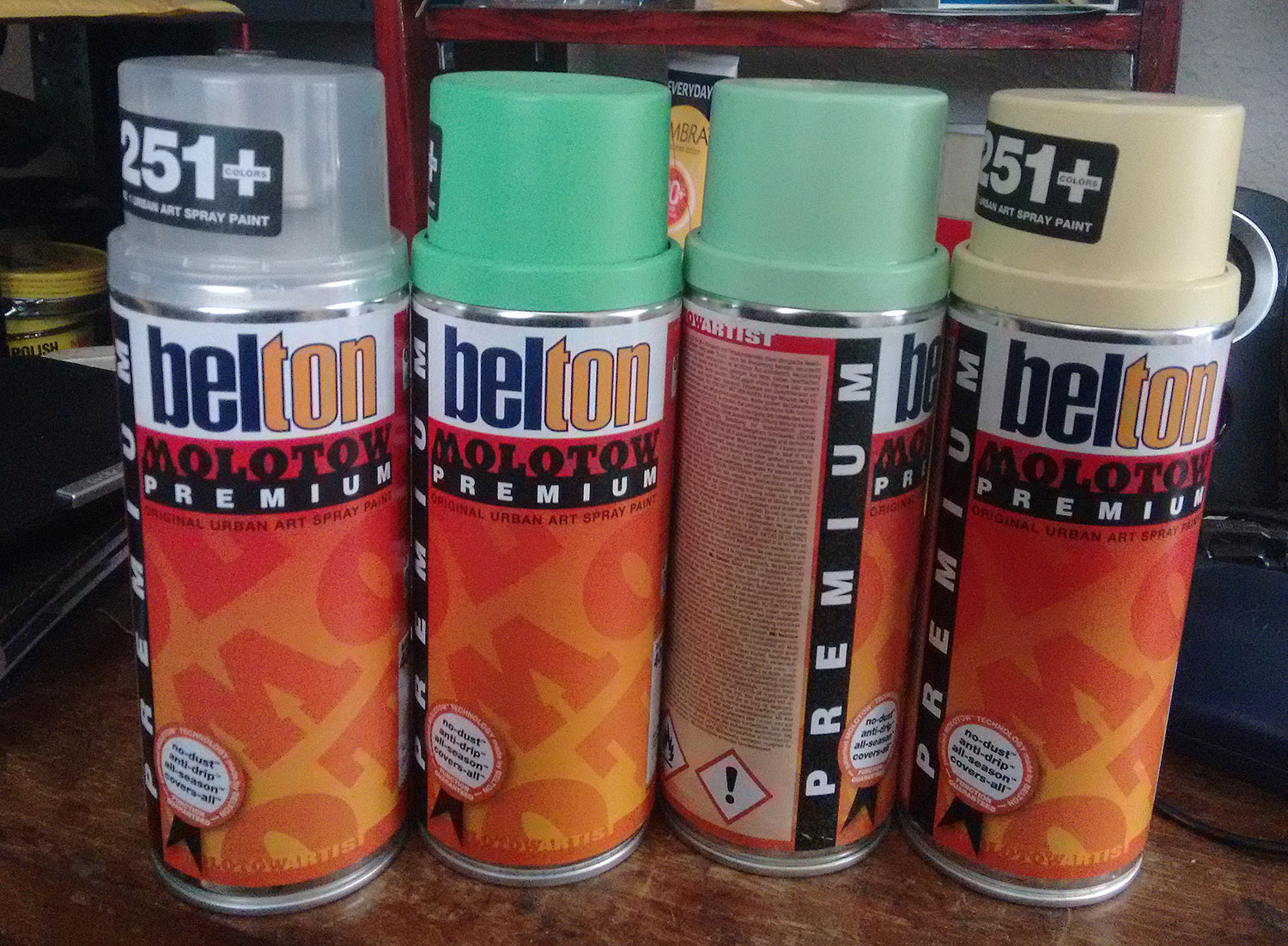

    Been using Belton Molotow for a few paint jobs.
    Goes on at a lower pressure and nice and flat. Dries really quick.
    Clear goes on with a lot of 'orange peel' but after a few coats, sands back nice and smooth.

    I get it from Union Heights in Prahran but it's readily available elsewhere methinks.

    Yep. Ok well that is a classic 'paint not fully dried' reaction. Rustoleum takes AGES to go off properly, especially if its a bit of a thicker coat. What has happened here is the top of the coat has hardened into a skin - it probably felt fine to to touch. When you've sprayed the clear over it the solvent has penetrated this skin and reactivated the not quite cured paint underneath.
    By ages I am talking months. There are guys here who have noticed even well after the build that rustoleum is marking because the solvents coming out of it are reacting with the foam on most guitar stands. I have a guitar complete finished in it and have done a few necks and you need to exercise super human levels of patience unfortunately. Once it is cured it is very very durable though, so I think it it worth while in the long run.
    You will now need to let this cure really well before knocking it back and respraying. It will probably settle down a bit, but you will be able to see wrinkling in the finish thats really hard to buff out. Try putting a fan on it for a few days, if you can evacuate the solvent gases from the surface it will speed up the curing.
    Temperature problems usually show up as clouding in the finish, greatly extended drying times and occasionally as bubbles.
    Interesting. Thanks heaps for the info. TBH the idea of waiting months doesn't really appeal so looks like it'll get sanded back and something different done. Is this just a rustoleum issue or spray cans in general? Most of the paint was laid down about three years ago, and then some light touching up done a week ago after a some light sanding. I actually thought I was playing it safe by waiting a lot longer than what the instructions on the can say to, but now I know better. It's a bit of a motivation killer but you live and learn.
