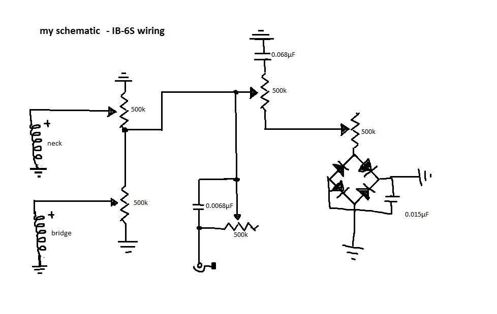

    sorry a bit tired, just realized i'd drawn that wrong lol. here is how i meant it...

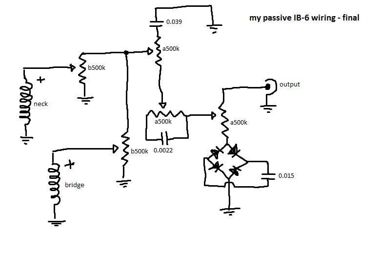

    had a bit more of a play with things tonight, changed the layout of the bass cut to work properly and a bit in general, plus re-drew things properly, my last diagrams were drawn up in a bit of a daze so there were a few minor errors some folks mightn't have picked up on.
    here's whats in my bass right now, working fine and sounding quite good. tone control is usable in its full range and the bass cut adds a bit of pop (technically removes some of the un-poppiness). the diode knob is quite subtle, but fully open sounds really good. will need to stop being lazy and take some recordings so you all can be the judge there...
    anyway, here's the diagram. i'm happy with the results, for a few extra dollars spent on ebay or somewhere on top of your kit arranging your knobs like this may be worthwhile...

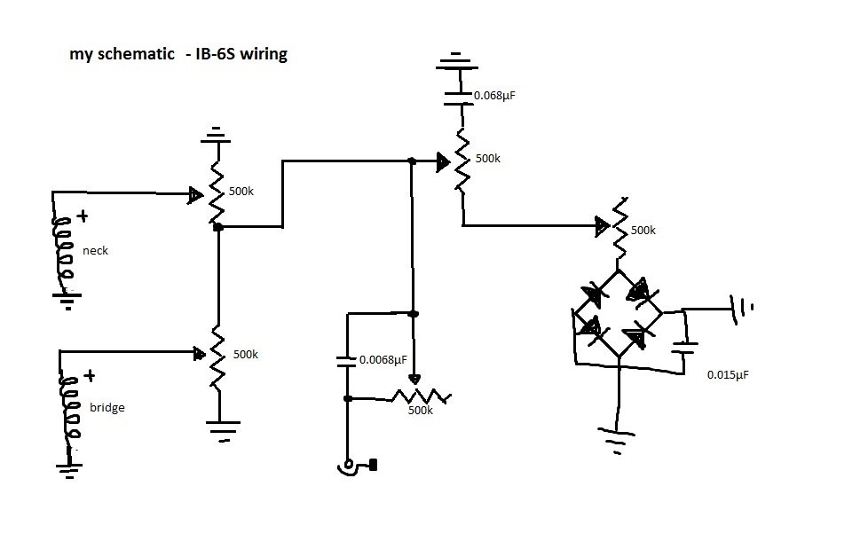

    Omg. Just about to wire my IB-6S. 2 volume 2 tone and master volume with what came with the kit. Now I'm just confused.
    Here's the standard IB-6S Master Vol, 2 Vol, 2 Tone wiring diagram Brendan created, that should get you sorted. If you need any help with specifics, just ask.
