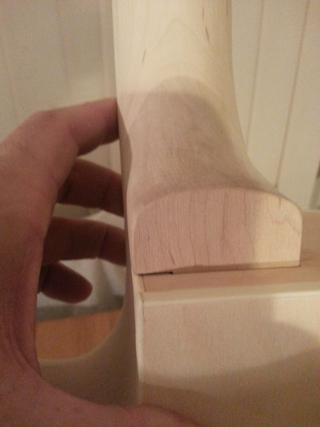

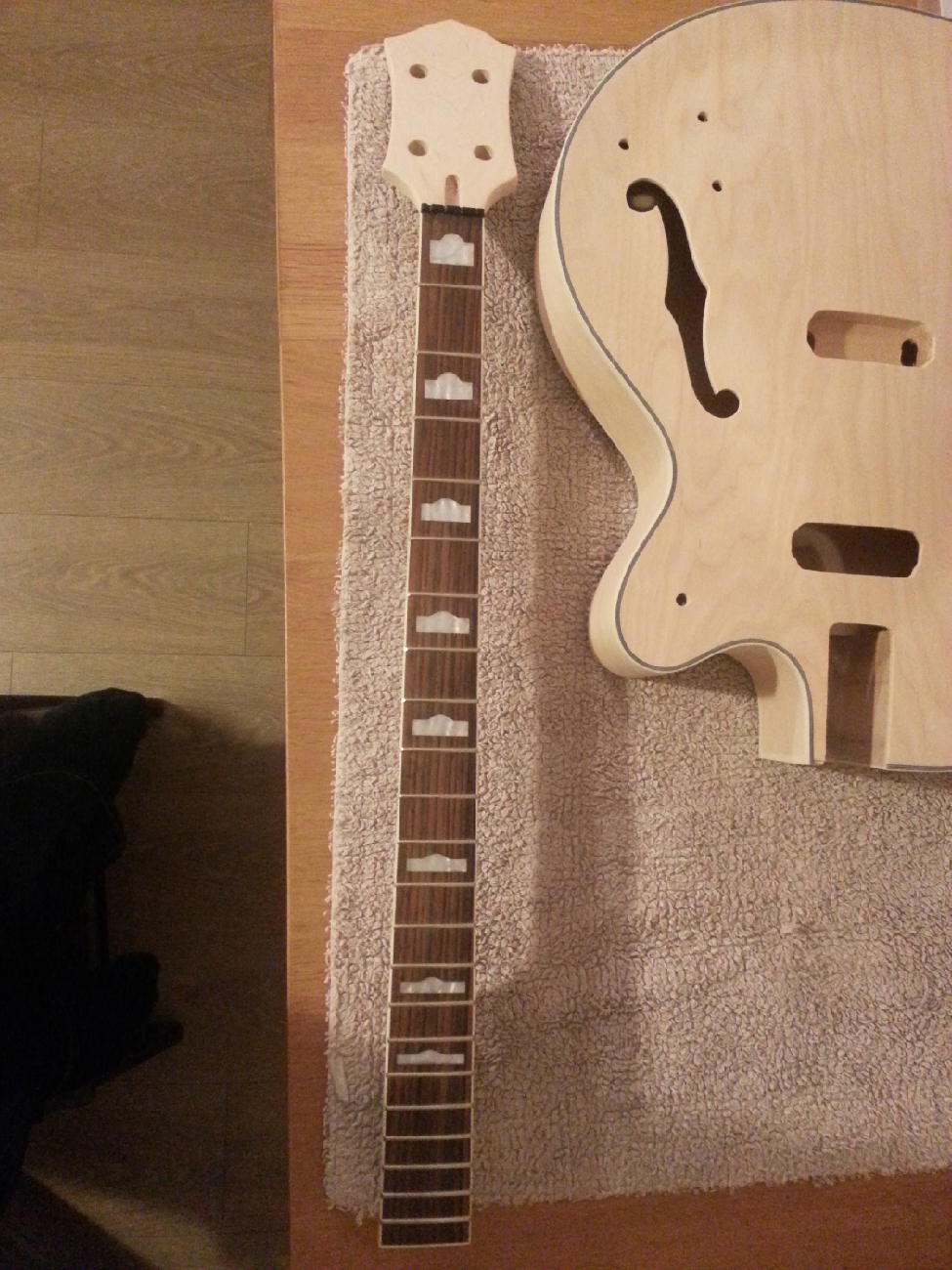

    Today I sanded the glue off the heel and gave the body and the neck a quick sand with some 180 grit I had lying around. The neck heel looks a lot better but I am not worried that as wokkaboy hinted the pocket might be a little off as there is a gap between the body and the fret board on the high side of the neck when I set the neck. I will post picture tomorrow.

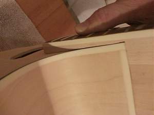

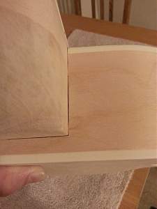

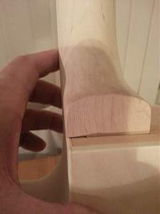

    So I am waiting for various deliveries to start working on the guitar. I have cleaned up some glue on the heel of the neck but the more I look at this area the more I think something is not quite right.
    When the neck is inserted flush there is a small gap on the left hand side at the bottom of the heel.
Name:	heel issue.jpg
    where I am a little bit unsure is the gap under the fret board and the body where it seems that part of the neck is not as straight as it should be. The picture, I now realise, is not as clear as it should but there is definitely a small gap.
Name:	neck issue 3.jpg
    and of much less concern is the small gap between the neck and the body on the high side of the guitar. I would assume that the glue and the finish might take care of this.
Name:	heel issue 2.jpg
    Obviously this is not as pronounced as on gavin's build but I am not sure whether I should consider sanding the neck or the pocket a little bit. Is sanding a good idea and could eventually impact the neck angle or am I being picky?
  8. #18
    Is there a way to check whether the frets have been set properly. I have not measured anything yet but it looks like fret 10 and 11 might be a little off.
Name:	fret issue.jpg
    Is there a way to check?

    Use the fret distance calculator on this page. You'll need to know your scale length (24 3/4"?). It looks ok in the photo, the inlays sometime play a trick with the eye.
    If you can confirm 24.75" scale, then the 10th fret should be 10.86 inches from the nut, or 10 14/16". I believe that's to the centre of the fret wire, and from the inside face of the nut.

    With the various gaps you've shown on the neck-body connection, I would use a very flat wood file to square all of the edges on the body, then square up the neck pocket surfaces. Check the fit again, and if any gaps are more than 1/2mm, I would removed material in minute amounts from the neck until the gaps are minimal. Any effects on the position of the neck relative to the bridge can be compensated for easily. Avoid taking any material from the bottom of the neck if possible, as this will change the angle of the fretboard leaving the guitar, which has presumably been set at the factory (although you can check this as well).
    Having said all of this, if your finish treatment involves an opaque finish in this area, then down worry, just glue it up, fill the gaps, and you will never see them again.
