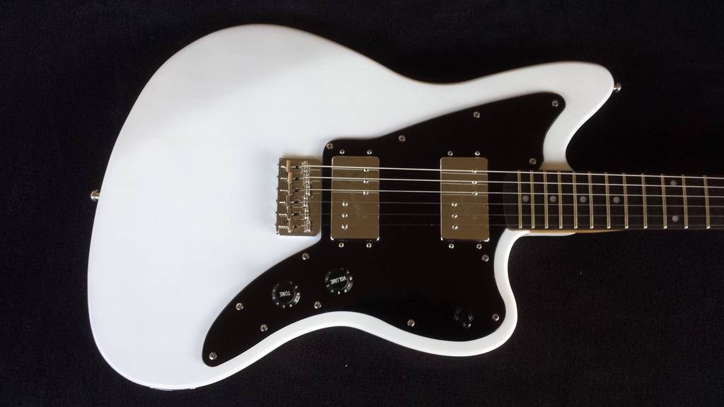

    Gents, I don't know how to ask this with out it sounding cheap...
    Could you use spray cans to get a good finish on a body?
    ie cut them back to a gloss finish etc.
    I have a good airbrush and compressor for small work but not a gun and compressor to suit.
    I am tossing up on the purchase of the gear for a couple of guitars ..
    Neil
    Absolutely you can. I did my jazzmaster in rattle can acrylic and it came up to a mirror gloss. Don't cheap out and buy the cheapest cans you find. I would recommend Anchor brand cans (acrylic) as their nozzle is the best I've found, or if you want to spend a bit more you could go up to Behlen (nitro).
    Obviously the better your prep work, the better the result. Thin coats, wet sanding up to at least 2000 grit and patience will get you there.
